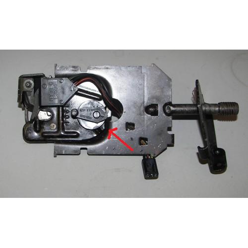

Here are 3 different pictures of the whole unit:
(red arrow points at where "I" think the solenoid is)
1. this is mine 91-92
2. i think the pre version 82-90
3. some in between 90-91?? no clue!!
maybe without electrical support (only with key)
(Important: i have a 92 Firebird, so i know that they have changed the pulldown unit in the last years of production)

Since you have a late 91-92 here is the prohblem. Either the latch release block is missing or the lever on the back side of the latch is broken. The latch release block is attached to the back side of the frame with two small screws. It is black plastic and has two ramps molded into it.
[IMG]downsolutions.com/image/cache/data/Products/706250-500x500.jpg[/IMG]
http://www.top-downsolutions.com/hat...r-91-92-f-body
If that latch release block is still attached to the frame, then check that there is still a plastic lever on the back side of the latch assembly (see the picture).
http://www.top-downsolutions.com/hat...latch-assembly
How this works is the as the latch assembly rises the lever on the back side of the latch makes contact with the ramp on the latch release block. The lever rotates 90 degrees which opens the latch to release the hatch hook. If either item is broken or missing no latch release. Both items are available from my web site from the links I attached.

Lonsal yes, yes thank you so much you are right,
and thank you other Guys for your help too.
@Lonsal
it is exactly that lever that is broken, red arrow------>
so it can't make contact with the latch release block, in that case it doesn't turn and
of course doesn't release

The info they provided is correct for the 86-91 style pull-down motor and I would have given the same info. That is why it is important to let us know what year of car you have.
Back to your situation. That lever is important and difficult to repair. It is easier to replace the entire latch assembly from another 91.5-92 from a pick-a-part yard. I also have the part available if you can't find it.
