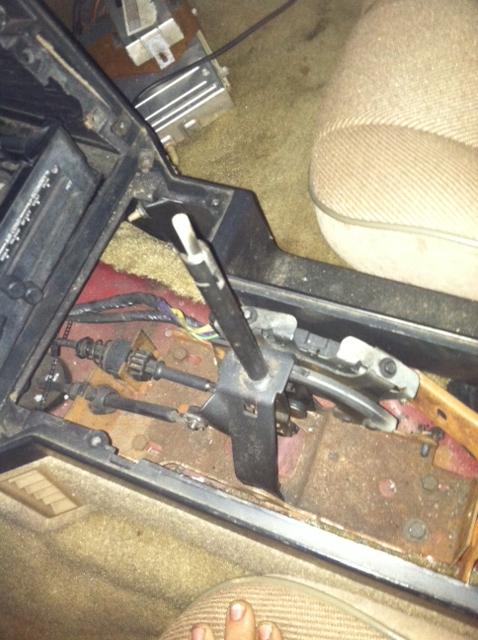

ok so here are a few pics. It looks as if nothing is broken off where that screw shud go. It doesnt have a spot for a clip like the other corners. The corner im talking about is the screw hole opposite my hand in the pic. Thanks for your help appreciate it
Attached Thumbnails replacing automatic shifter plate w/ aftermarket shift kit-img_0236.jpg   replacing automatic shifter plate w/ aftermarket shift kit-img_0241.jpg

Re: replacing automatic shifter plate w/ aftermarket shift kit
On everyone of these cars one (1) of the little hex screws around the ashtray is actually a fake screw. It's just there for looks and actually has a little tab or something on the back that slips into a hole, if you try to unscrew it you will snap that tab off and have what appears to be a stripped screw/hole.
You'll wanna find a replacement plate and modify it w/out breaking that piece.
EDIT: One of the screws around the Radio is a fake one, not the shifter plate.
You are just missing a clip.

am I just missing a clip? i dont know bc there is not really a spot for the clip to be mounted to like the other ones and it doesnt appear to be broken off. there is this plastic piece that is connected to a cable on the floor board , u can see it in of the pictures wondering if it screws in there but doesnt seem right? ill try to post a better pic of it

ok so this that platic piece connected to that cable with a little clip thing at the end where my fingers are if i pull on it it slides back a little like spring action. What is this thing for one? and does that screw really go in here ?
Attached Thumbnails replacing automatic shifter plate w/ aftermarket shift kit-img_0246.jpg   replacing automatic shifter plate w/ aftermarket shift kit-img_0245.jpg

No that looks more like a linkage...can't tell you where that hooks up but it clearly should be hooked up to something. You just need a small clip like what is on the other holes. does the ashtray have some kind of threaded hole on it by chance? It's been a while since mine has been apart so I can't remember.

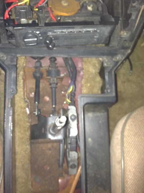

this pic was taken with my phone where the radio should be facing back towards the shifter, i hope this helps, my shifter itself is from a 91 but it shouldnt matter, my cars an 85 should be the same as yours

sorry for the poor quality iphones dont work well in the dark,
if theres suposed to be a metal tab there and urs is missing, i have an extra center console top i think.

ok thanks. Im still puzzled bc yours doesnt show a screw hole either..looks just like mine..im thinkin i might have to come up with a make shift clip somehow
do u know which screw hole im talkin about? its the one opposite my hand in the picture where im holding the shifter plate.. its the first hole from the bottom right side of the shifter trim plate
it is preetty much right where ur shifter is blocking the view of in ur second picture

okay, wait a second, you remember the white plastic thing that was on the bottom of the shifter plate that held the gear number slider thingy? i think the screw just goes into that, basically its just for show, post a picture of the aftermarket shifter so i can see what your tryna work with here.
The 2 holes you are talking about have dummy screws in them. Just to make it look like the shifter plate is a separate piece. Those screws are not even there on a standard.

I looked today while I was down there & mine is loose there still, so I must've never actually fixed it, although I could swear I had done something to hold it down.
