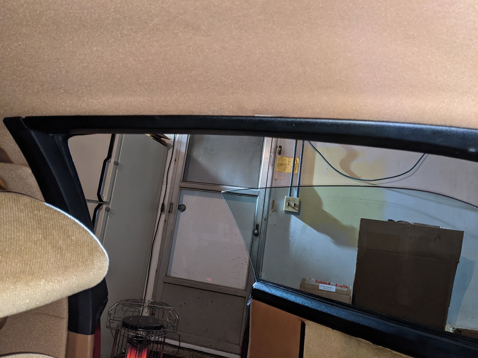

I'm super late to the party, but I just want to offer my insight for anyone else struggling with these. I spent hours trying to install these. I ended up getting the a-pillar to stay firmly with heavy duty Velcro. The oem clips just fight you all day and it's inevitable you'll break a slot on your pillar. I included some images below to show where I placed it.
The post-it-notes are just visual, to indicate where I put the Velcro on the inside of the a-pillar (the Velcro I applied is not as big as the area of the post-it-note. It's just to indicate the general position)
I cut my Velcro strips about a 1.5 inches in length, and roughly 1in. width (Above the window you need to cut a piece slightly less than 1inch width probably)
I got these at Home Depot. They are holding the a-pillar really firmly, and it's barely noticeable on the car. Each to their own, but this to me worked really well.

I can definitely recommend, and I uploaded another picture of the full a-pillar to show the end result. I can barely tell it's there.
