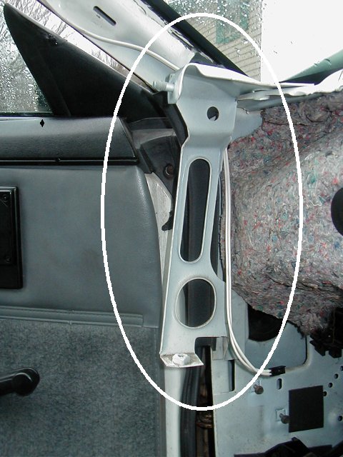

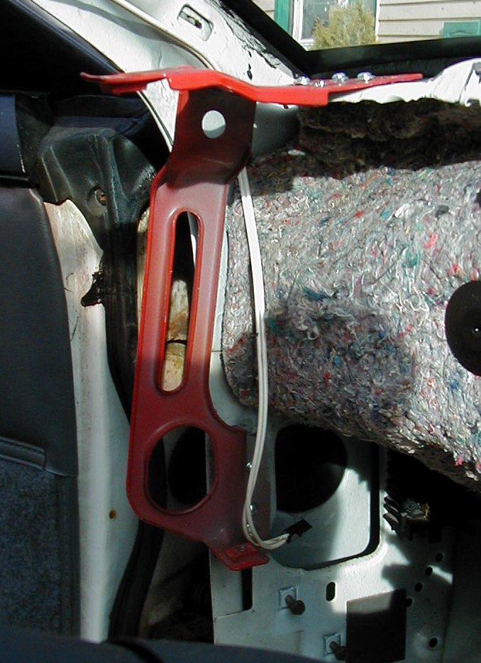

I converted from an 87 to a 92 dash housing before. Yes,... the firewall brackets are different. The only way the newer style dash will mount properly is if you cut/drill the spot welds from the existing brackets and bolt/weld the proper brackets in place:
factory 87 Brackets:
90-92 Brackets bolted in place:
