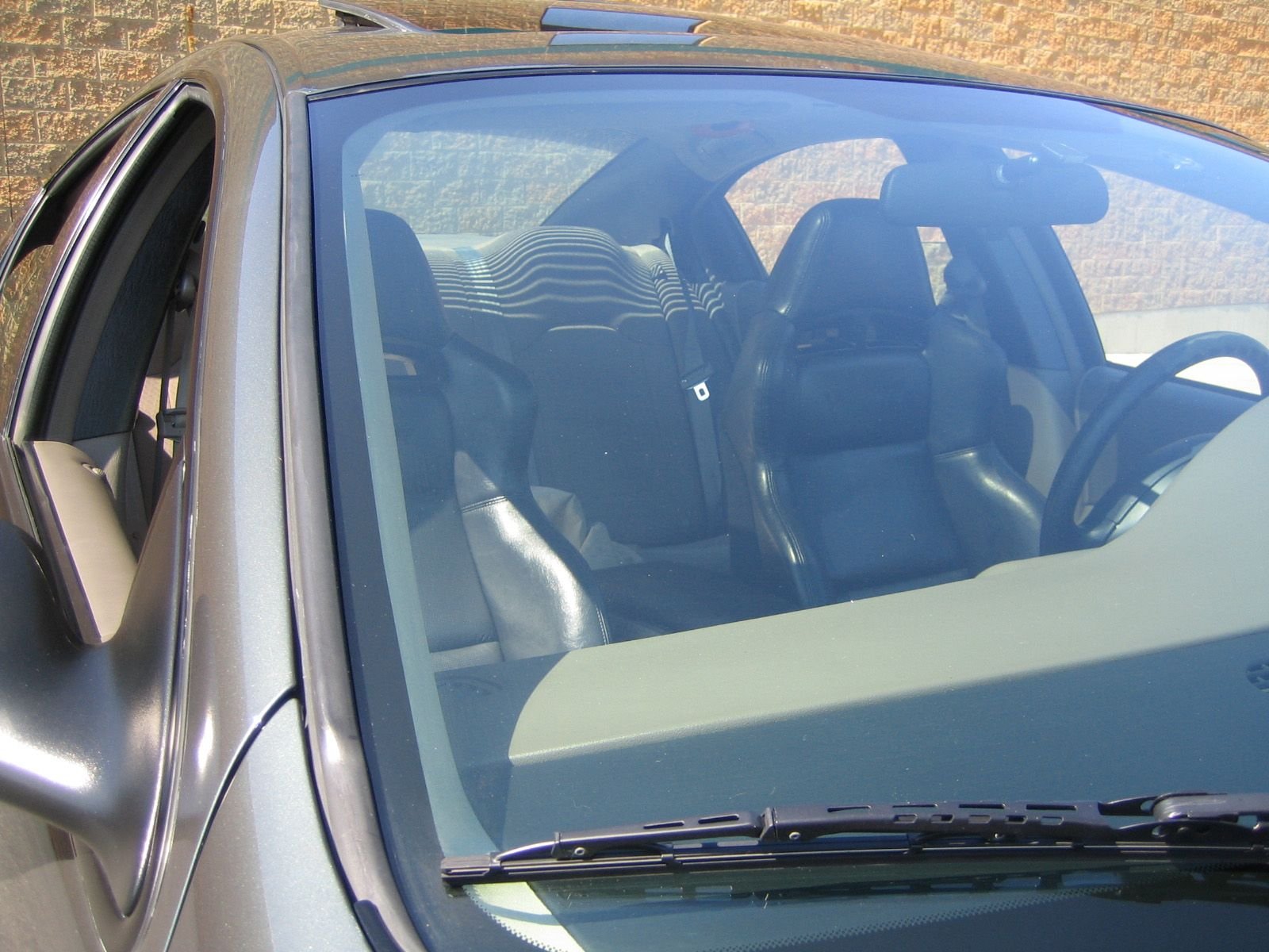

You would be amazed at that you can do with some steel angle. I bolted a set of 2003 Viper seats into a 1994 and 2003 Dodge Intrepid using the factory mounts on the seats, the OEM mounting holes, using the angle as the adapter.
No welds, just drilled holes and used what was already there for mounting points.
