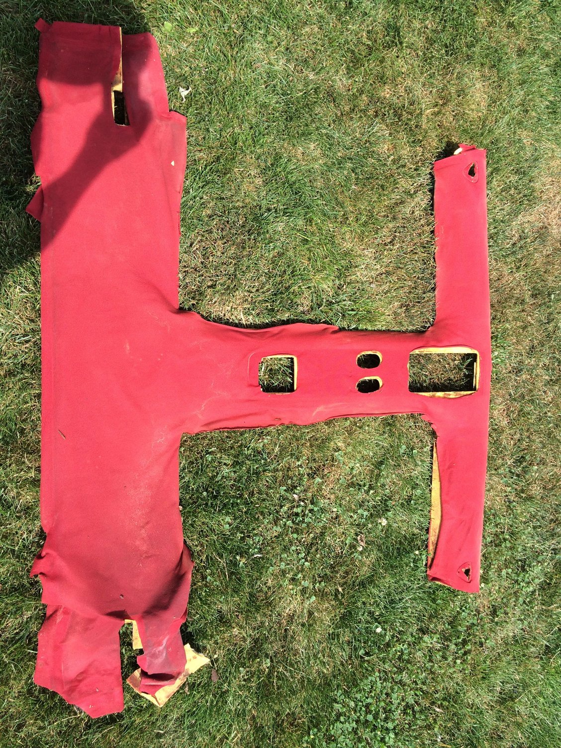

Does anyone know where I can find a headliner like this?

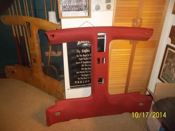

I got a ABS headliner for sale in that color.
