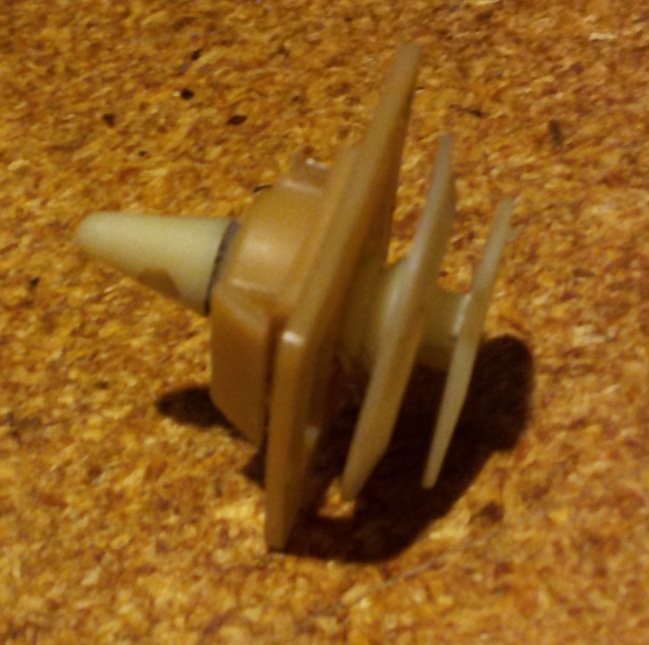

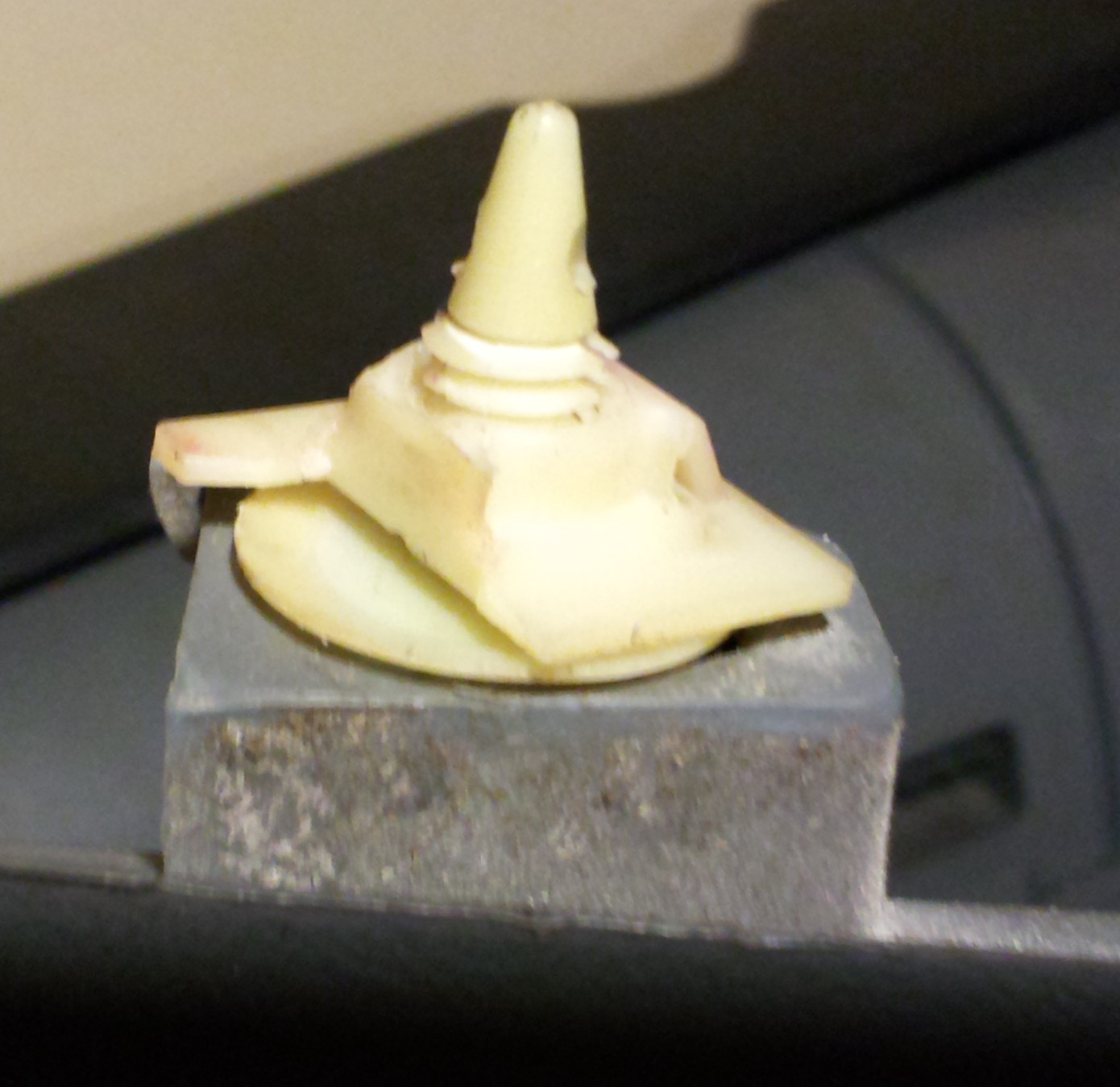

Originally Posted by katrav8
I refer to #12 which has no plastic screw holes or rear folding seat striker bolt.
Many interior panels appear the same, however they actually vary more than most assume. Both by year and also options during the same year.
The rear individual or dual seat option includes strikers on both sides, however others include a single striker on the passenger side. I know this from the many times I have had to go around to drop the seat. (That and I just went out and looked at one of my Camaros.) Your diagram also shows the hole on one side and not the other.
Another interior example is that some include holes for the cargo shade and yet that position also changes over time. Because of that, asking individual people what their cars have does not always related to what you have. If you have parts from different years and/or options, then that can further complicate things.
The attachment points along the upper portion vary, but it looks like the same parts are used for all three. The one on the far left slides in and is actually the one on the wood surface. The other two twist into the slots via the cut in the top as shown below. The tree hooks into another plastic clip previously inserted into the body also shown below.
They tend to become brittle over time so if you can find both parts I would recommend replacing all that you can.
The link previously provided appears to be the correct piece.
Below are pics of original trees and retainers. The part that goes into the body is more yellow.
