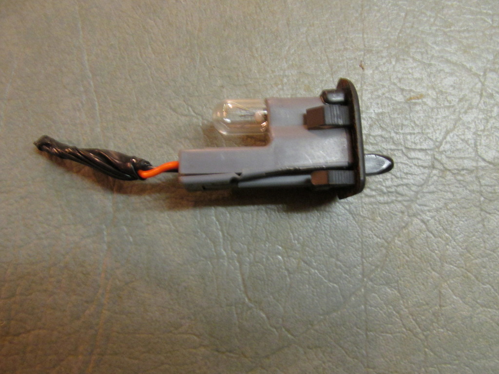

The 2 wires(Orange and Black) goes to this Light Switch.

If you have/can acquire a compartment light, those pins should
easily re-install. You might have to carefully bend open the
retaining tabs a bit.
In general, orange wires are constant power, and black is ground.
Good luck, & keep us posted.
