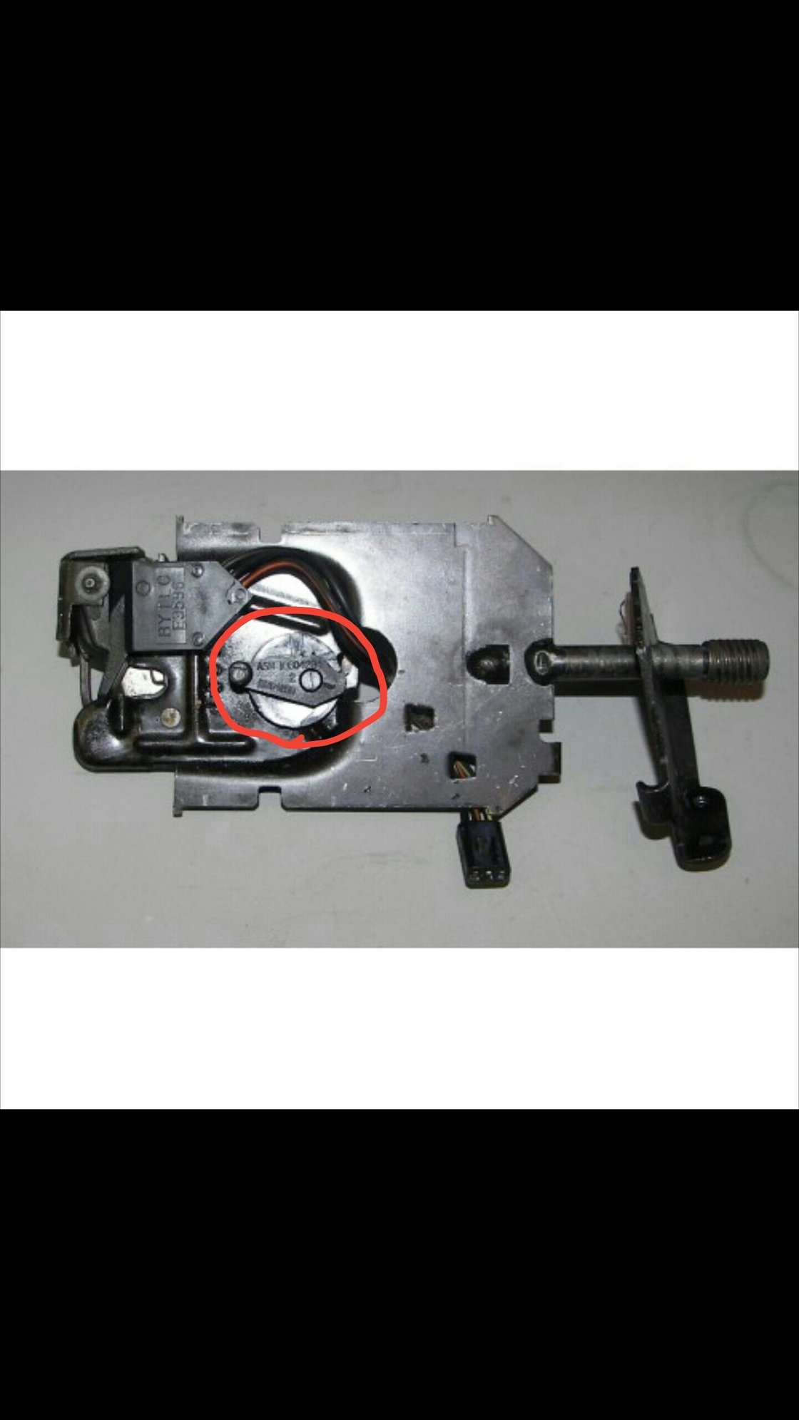

I've circled the lever on the back side of the latch assy which is most likely broken or missing and is causing the problem you describe.
That lever must be there or the pull-down unit will not release the hatch hook when it reaches the end of the up cycle
The easiest way to fix it is the replace the entire latch asembly. I have them available on my web site:
http://www.top-downsolutions.com/use...?search=110360
The other cause for the latch not unlatching on the up cycle is if the latch release ramp is missing. I sell that part too:
http://www.top-downsolutions.com/hat...r-91-92-f-body

If indeed the lever is on the back side of the latch as shown in the photo I posted earlier and the latch release block. Your latch may messed up and not releasing. You haven't mentioned if you can release the latch with the key.
Lon

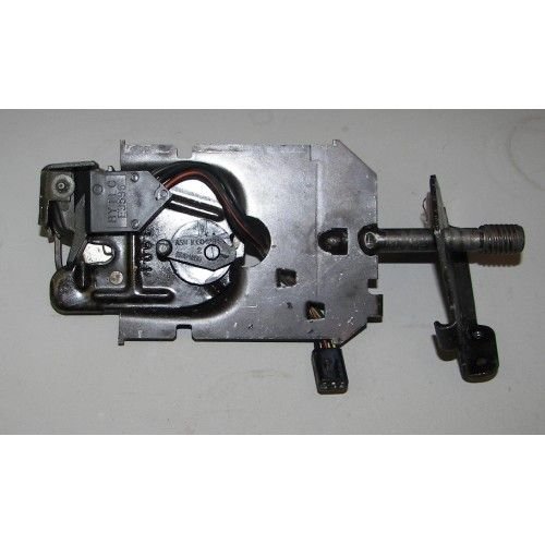

Your 91.5-92 pull-down unit has either a broken latch release plastic arm or the latch release block is missing. How it is supposed to function: Press the latch release switch, the motor is started for the up-cycle. As it travels up the plastic arm that is attached on the back side of the latch assembly makes contact with the ramp of the latch release block (attached to the back side of the tan colored plastic frame of the unit with 2 small screws). As the latch continues to travel up that arm is rotated and releases the latch. Then a tab on the latch assy makes contact with the reversing switch to turn off the motor. In your case that arm is broken and not making contact with the latch release block to release the hatch hook. Instead your hatch hook remains latched while the latch assy continues to travel up. When the reversing switch is tripped to shut off the up cycle immediately the striker sensing switch senses that the latch is engaged (as if you had closed the hatch) and it turns on the motor to travel down again. I've attached a picture of the latch assembly and the plastic lever that should be present. If it is indeed still there, then it is the latch release block that is broken or missing.
Lon Salgren
91.5-92 latch assembly
