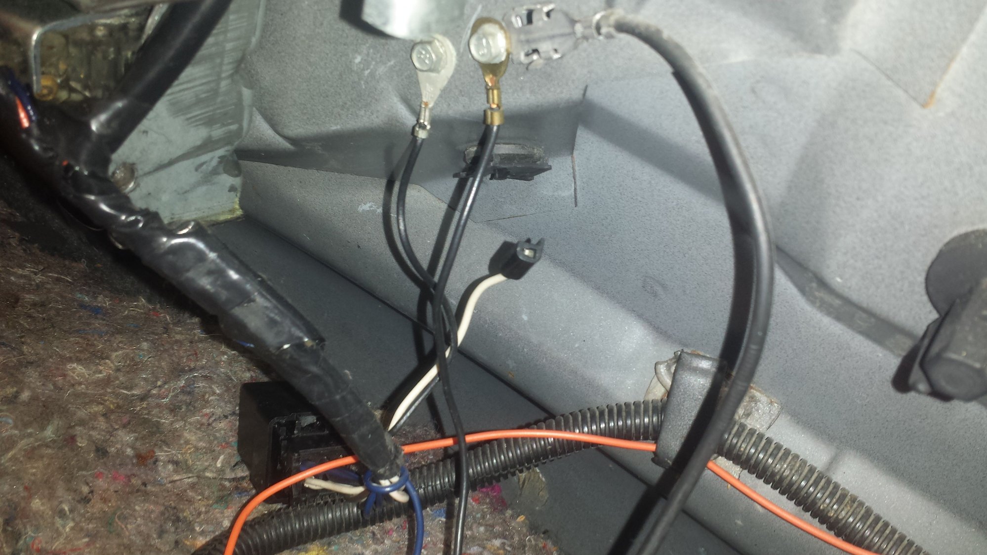

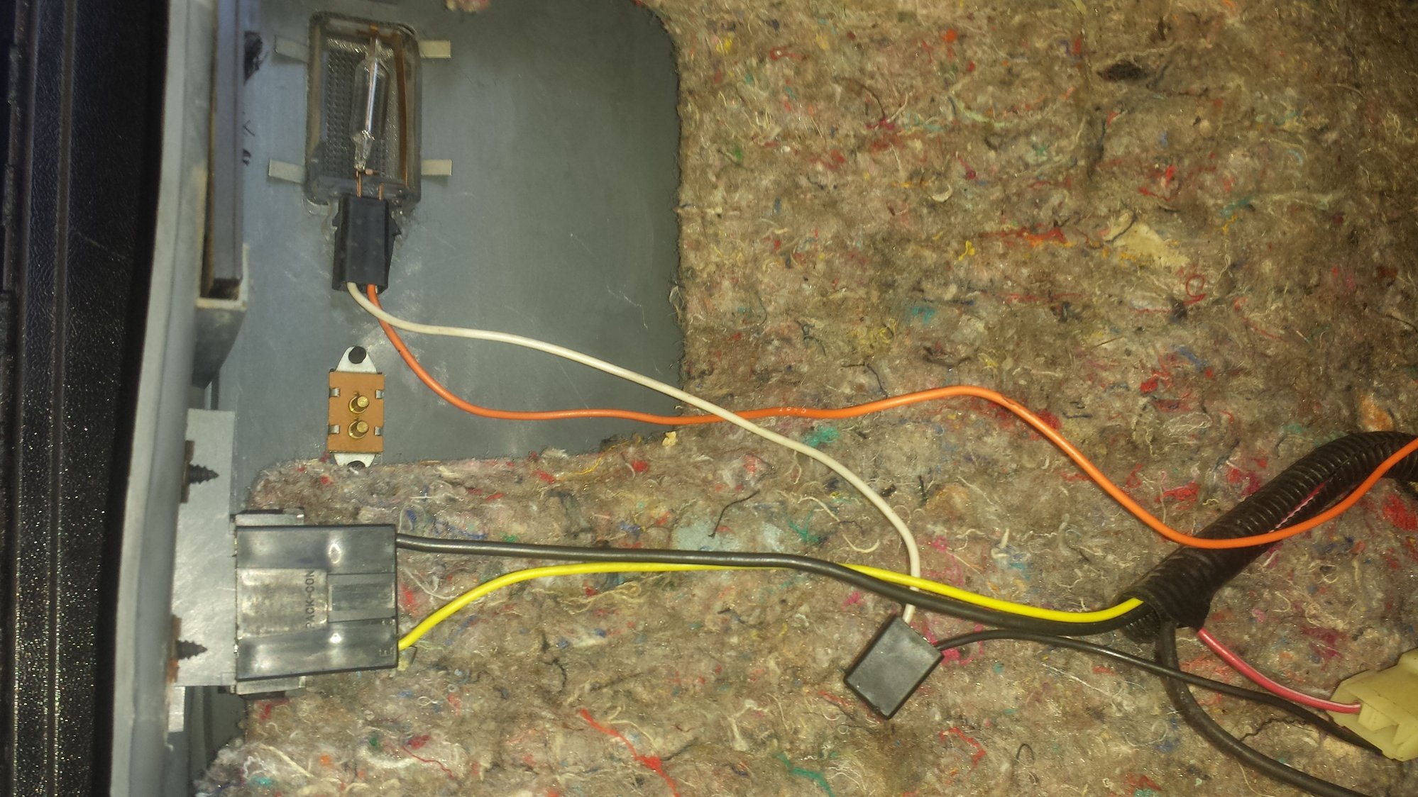

Hatch won't close completely
I replaced the pull down motor it works great it goes up and down fine. The thing is it won't close the trunk all the way so that its flush. When i close the trunk itll pull down and wont finish the process I'll hear a loud sound sorta like a jackhammer but it just won't close completely. I have to hear the damn thing squeak while driving down the road.
Any advice or a simple fix would be appreciated.
Car: 87 Camaro Lt
Pictures of the wiring
