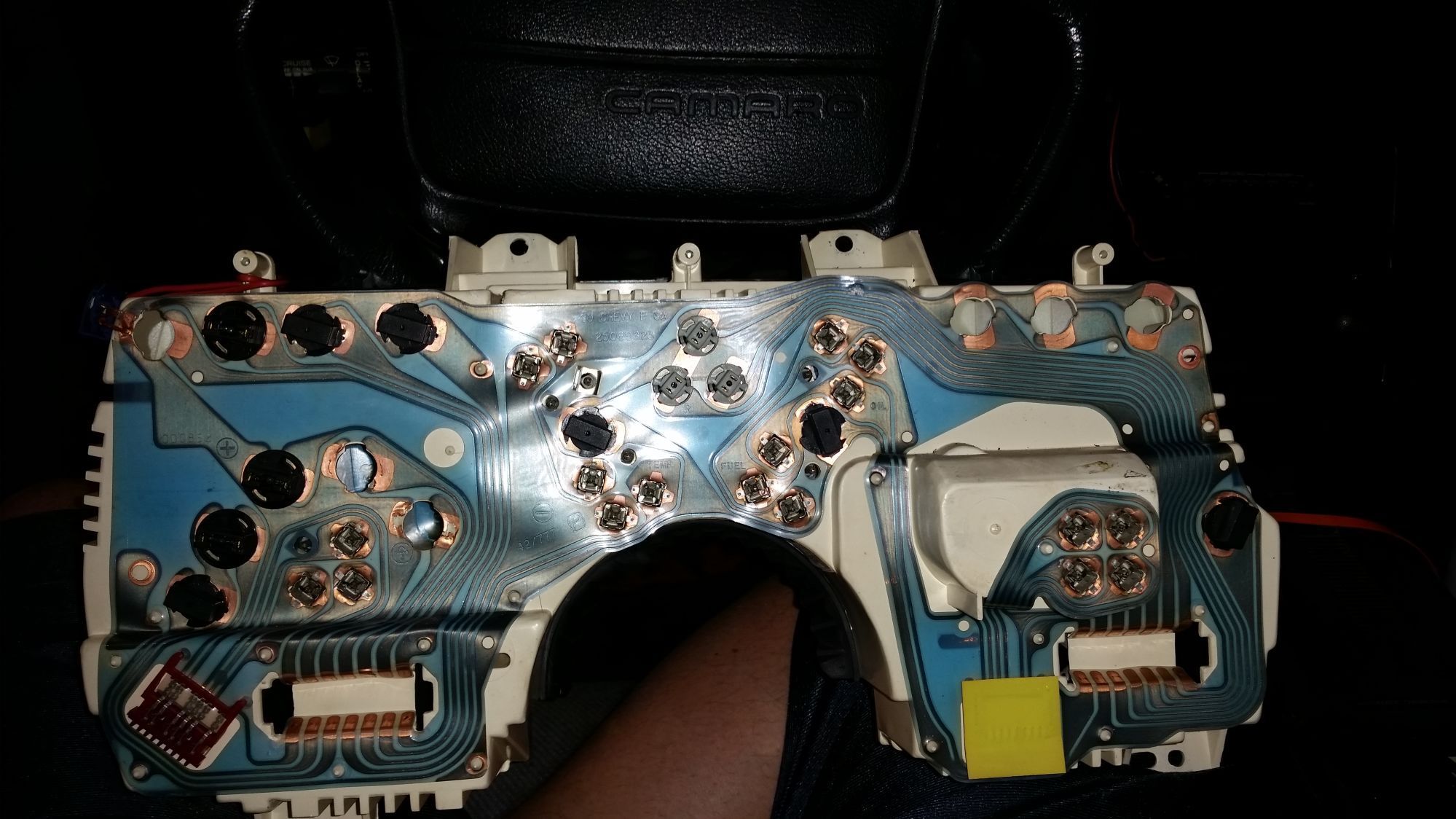

I'm working on replacing all of my bulbs with LEDs. I'm focusing on the interior, right now. I found a picture the other day on this site with all the bulbs circled, but now I can't for the life of me find it. The car is an 86 IROC automatic t-top
I need to know how many to order. Also, help me make sure I am not missing any, here is what all I think is in there:
http://www.macewenmotorsports.com/howmabudoine.html
Oops, my bad The above is for the cluster only.
JamesC
That's what I needed. Thanks

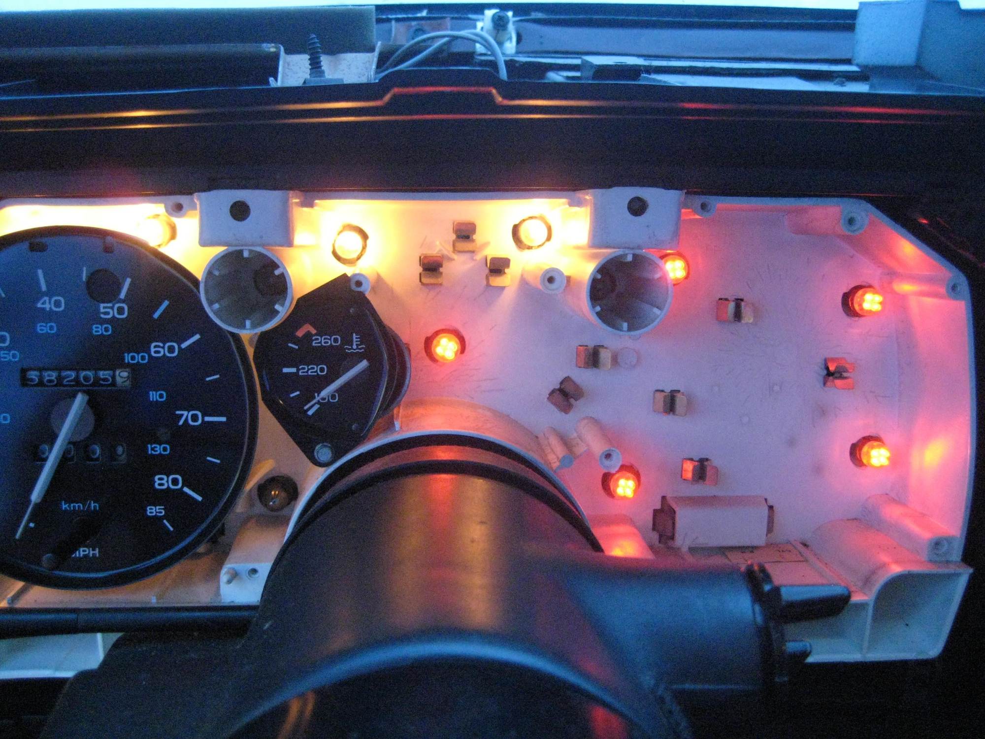

I have an 84 with all good 194's yet over the years the whole cluster has become dimmer than back in the 80's. No I'm not going blind. lol Any ideasand thanks

Re: How many bulbs in the gauge cluster?
14? bulbs in gauges.
