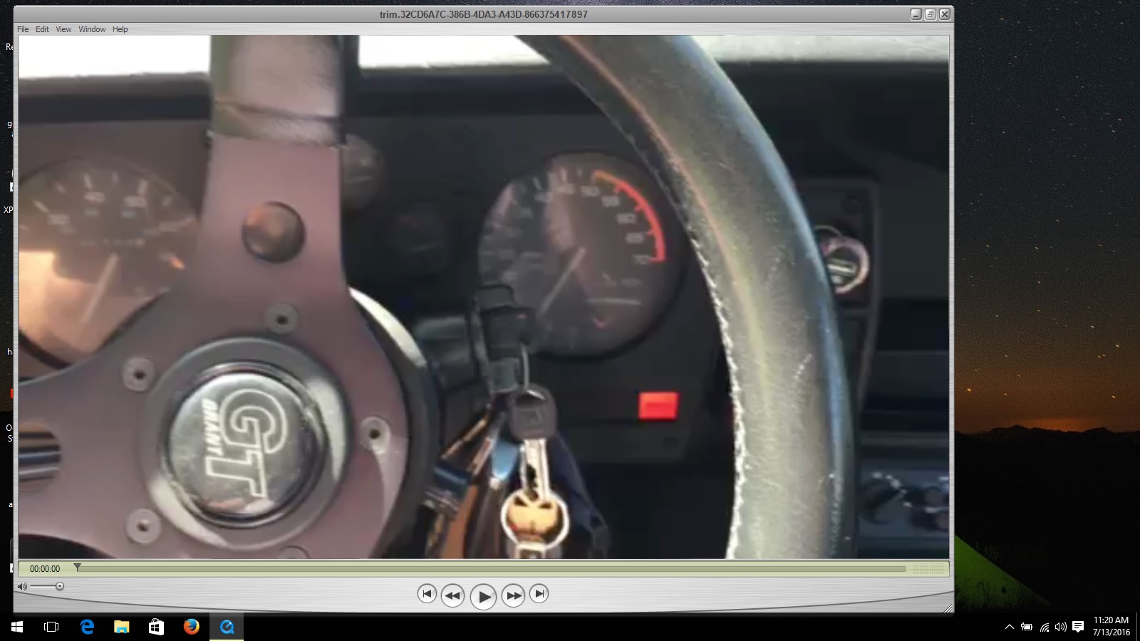

This is the iroc I'm going to buy and the current owner sent me a video of the car running. The picture is a screen shot of that video.
Can someone tell me what that warning light is that is on?

If i'm not mistaken that is the brake light. Is it manual? Parking brake on?

It's a auto and in the video the e brake is not pulled

Can't you ask him? If it is the ebrake, and brake is not pulled, could be the switch is misadjusted or bad

I asked he said it was the brake light, he said he had just completed a brake job and had to replace 2 calipers and he hasn't reset the light.

Re-bleed the brakes.
If the E-Brake isn't the issue,.... It wasn't bled right the first time or there is still a problem.
