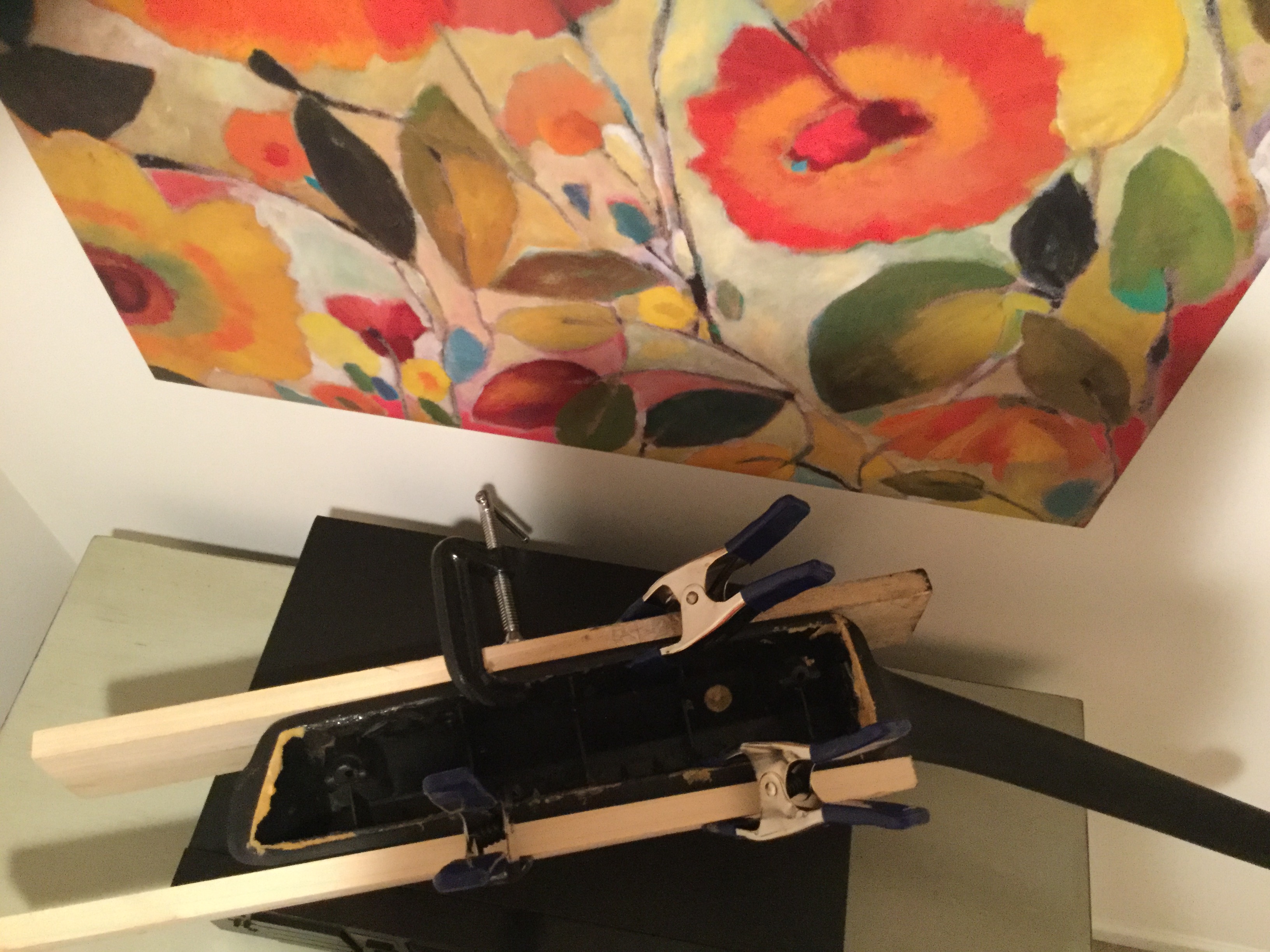

I learned a great fix here earlier this year so I'm repeating the first one I did due to the high humidity and temps here in Chicago this Summer. Should be good to go for awhile now.

What did you use on it?
I used Gorilla Glue on some of the soft trim of my radio pod. I was thinking of trying the same thing elsewhere. But I'm always open to new options.

I used JB Weld. Works great! The side I did correctly is doing great, this side I didn't get enough of the material spread evenly, so it didn't hold in those spots.
Once you spread the material evenly underneath the vinyl and on top of the plastic frame, use the boards to apply even pressure along with grips, this makes sure the armrest dries evenly without a "wave" in it. Dries overnight.

I've had good luck just applying a thin bead of super glue and pressing the vinyl in place until it kicks. Have to be careful with clamps, it's pretty easy to get permanent marks if you use something like clothes pins.

Great point on the clamps...but that is WHY I used plywood so there is even pressure on the outside vinyl. ������

What a coincidence. I just did this. Used two 6 inch hand clamps from harbor freight and 2 1×4 . I used this glue called E6000 craft adhesive . Comes in a grey tube. Put the clamps on for 1 day and its great.
