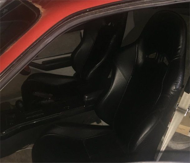

Re: Racing Seats
Hey, I purchased some mounts from ebay. They did come in a pair and left / right are different. They bolted straight onto the existing mounting points and come with their own railings.
X2 RACING SEAT BASE MOUNT BRACKETS ADAPTER LEFT+RIGHT FOR 82-92 PONTIAC FIREBIRD
Sorry, not the best photos. They were for reference when I was working on the interior when it was dark.

Those look ridiculously high off the floor. Not a concern losing headroom I take it?
Old Jun 14, 2020 | 10:16 PM
V_350's Avatar
Joined: Jun 2020
Posts: 12
Car: 82 Trans AM
Re: Racing Seats
I believe what I have actually mount at a very similar height as the original seats. I'm 5'6 and don't have issues. Maybe lean the seat backwards just a tad.

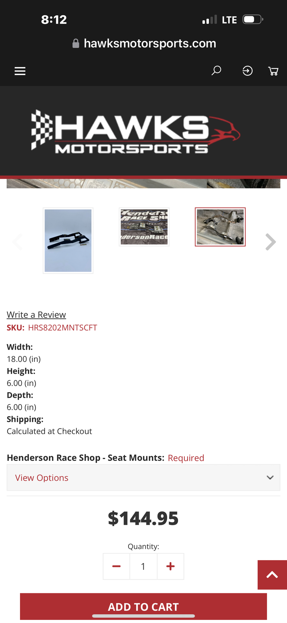

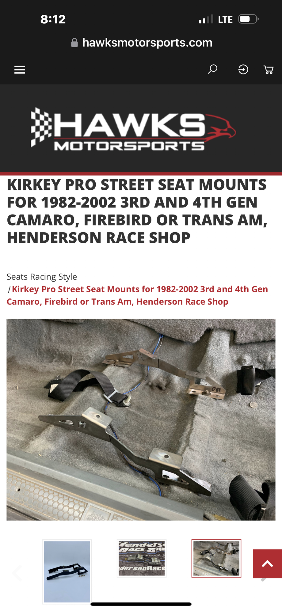

Old Oct 23, 2023 | 08:14 PM
Tombowman89's Avatar
Joined: Jul 2013
Posts: 179
Likes: 46
From: Green bow Ala-freakin-bama
Car: 88 Iroc
Engine: 388 Vortec Pro-Flo 4 Small Block
Axle/Gears: 3.77 to 1
Re: Racing Seats
I know this sounds dumb but a lot of sanctioning bodies won’t let you race with seats that can recline, so are they really racing seats?
Here are some brackets for third and fourth gen Camaros that a kirkey “racing seat” can be used with
