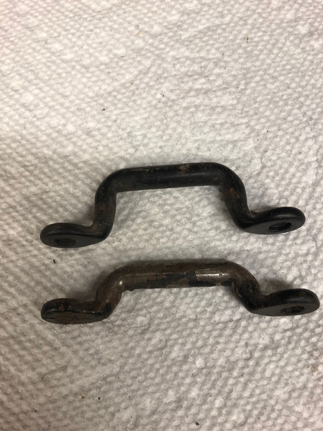

These were on the bench in my garage. I believe they’re leftovers from my T-top Firebird. As you can see, one is ‘taller’ than the other. Not sure if maybe one is a top mount and one is a bottom mount. It’s been so long I don’t remember. Maybe someone can chime in and identify them.

The taller mount is the one that protrudes through the rear trim panel. The short one is the one that sits on top of the carpet.
The mounting pads for the mounts is just tall enough the screws have room to thread in without poking thru the floor and into the tank.
