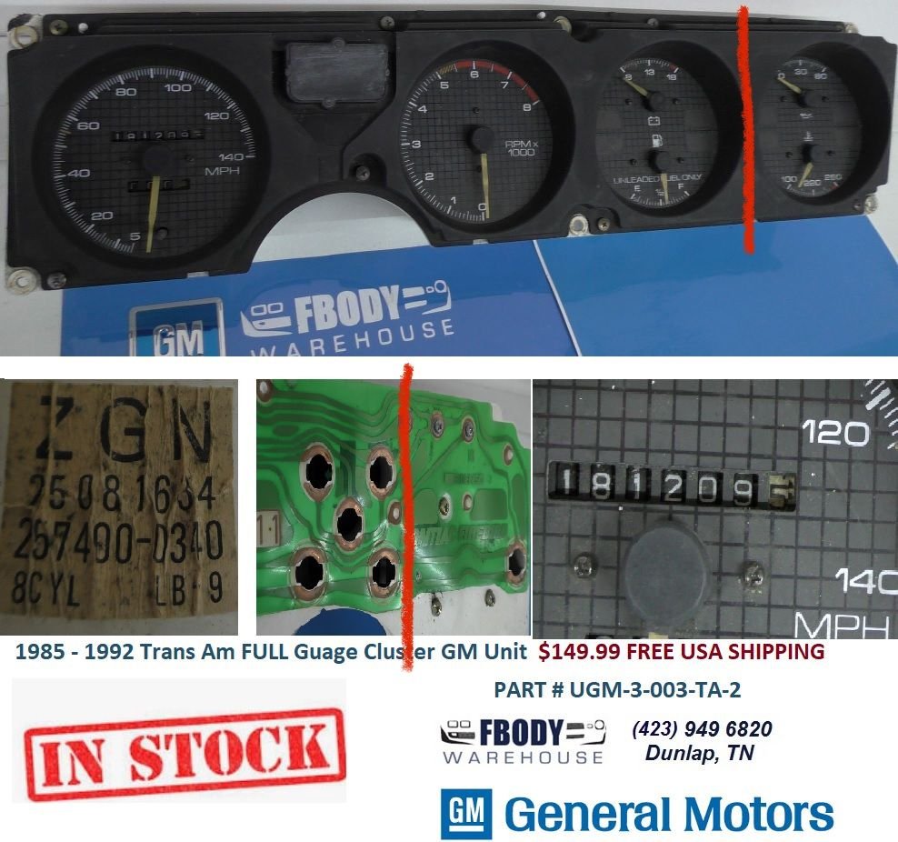

I found this photo online. I added the red lines. I’d have to cut the cuircut board like this. I’m guessing it wouldn’t work. Was just wondering if anyone had tried anything like this

That's not very helpful, but I think you might be able to make that cut and still have the rest function properly.You shouldn't need to cut the carrier, the white part, to add gauges
What are you trying to do?

I have aftermarket oil pressure and water temp gauges both 2” I want to mod in the 4” hole the stock gauge is in.

Considering you're not going to use the stock gauges or senders, chopping the cluster on the end won't affect the remaining gauges.
It may, however, affect the back lighting circuit.
