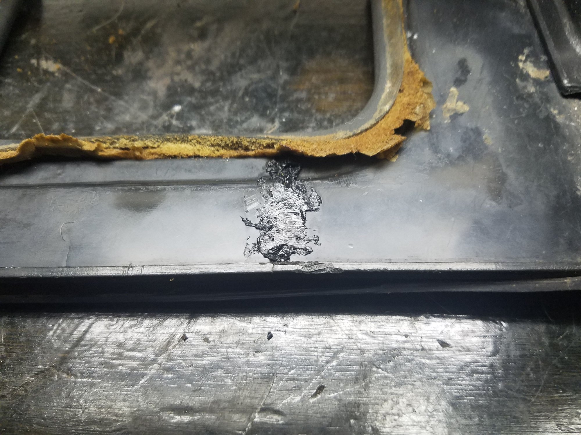

ABS is fun to work with. It welds back easily with a soldering iron. I use a cheap iron that has held up very well over multiple jobs. Plus, ABS cement from a hardware store can help make bonds. I bought sheets on Amazon of ABS sheets in 1/16 and 1/8" thickness awhile ago to make parts and use shavings from these for extra virgin material.

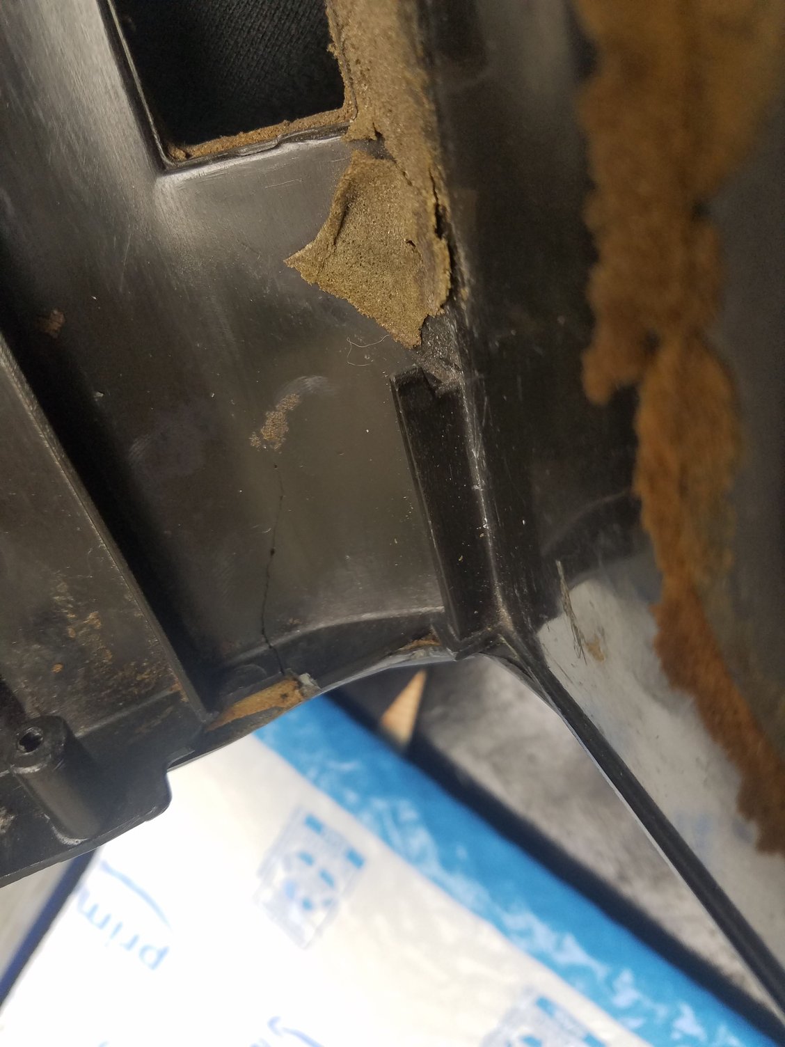

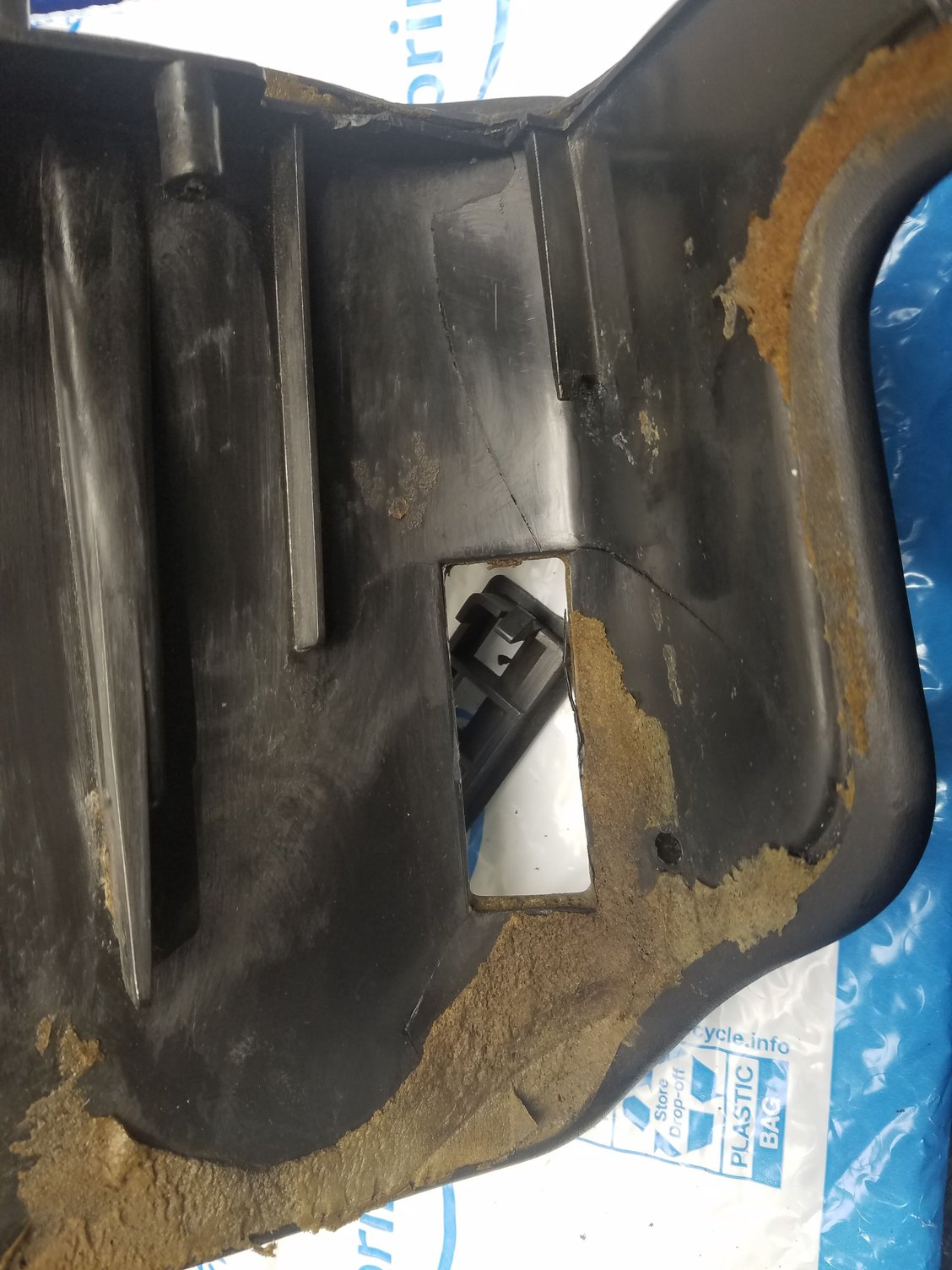

After repairing the first crack, I started to deep clean the part and realized the housing was cracked in several more places.
Cracks all around the vent hole were found. Lots of flex in the housing.
Other side had some too.

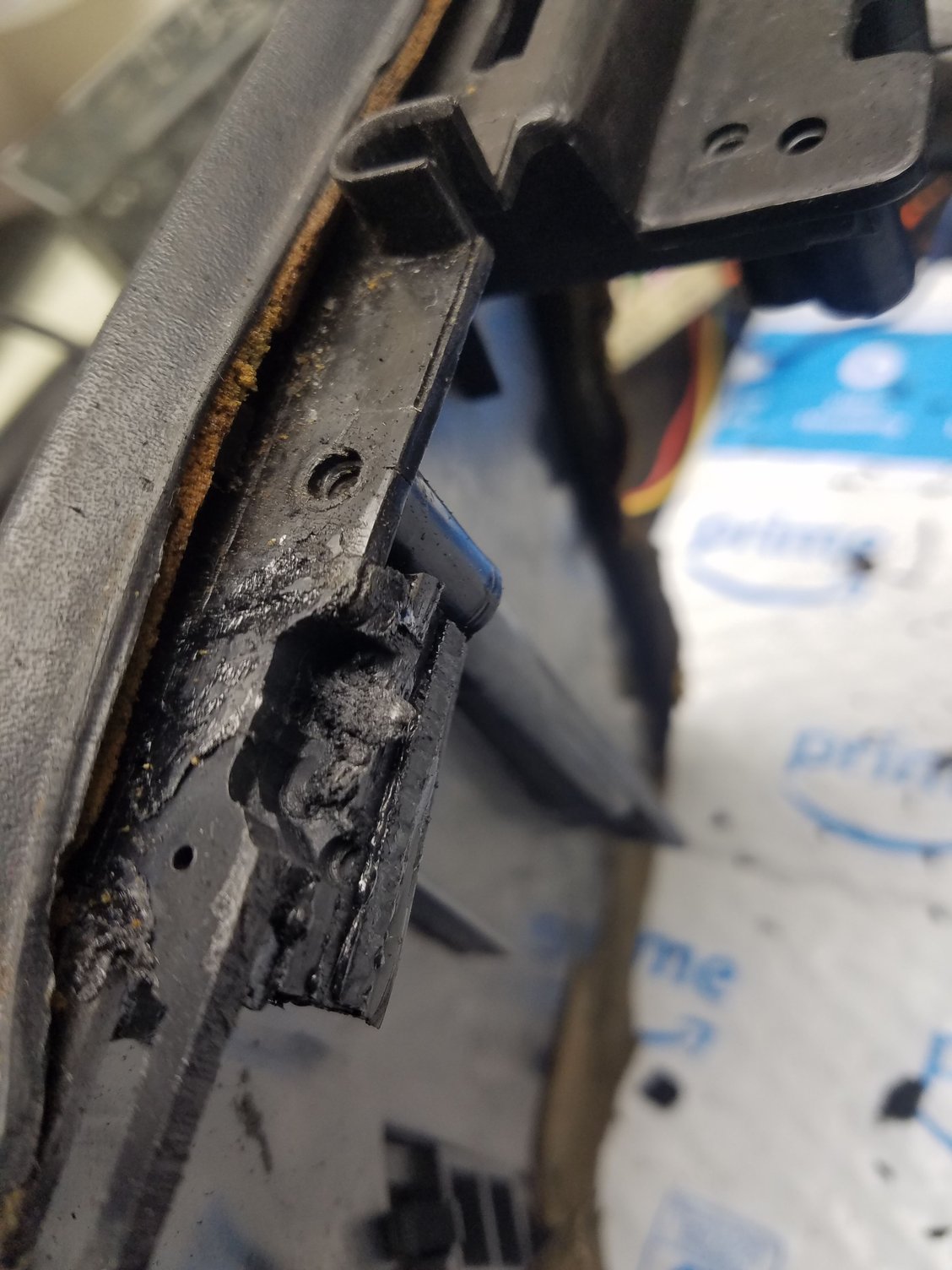

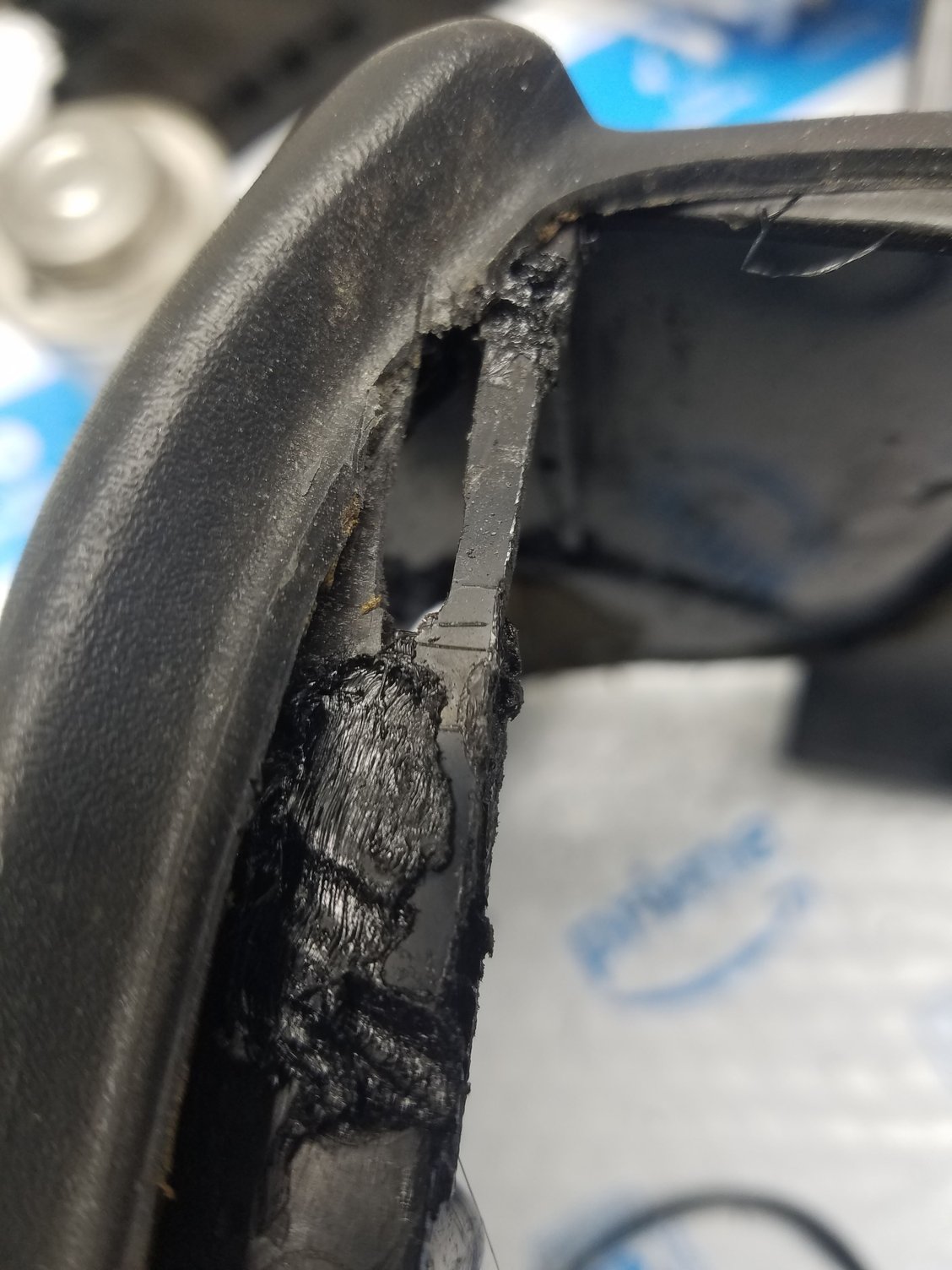

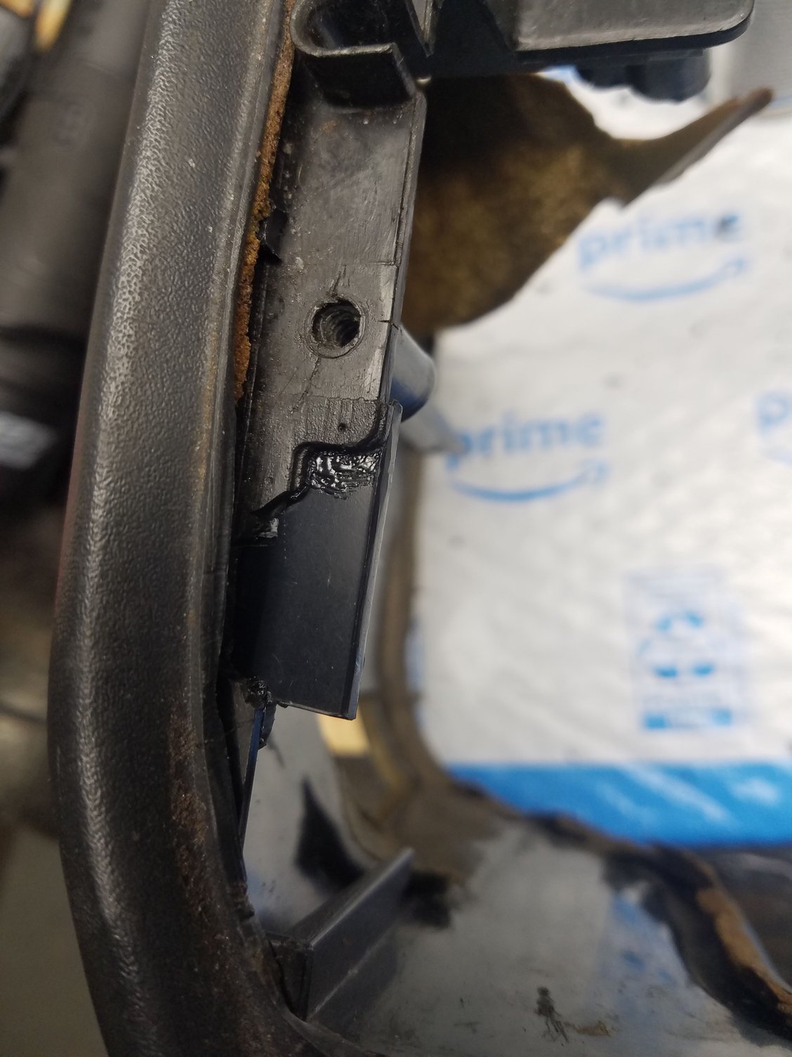

At this point, I likely would have scrapped both pods and searched for a better used part. However, since and project is now golden for keeping me in the garage, I decided to try and weld these all closed too.

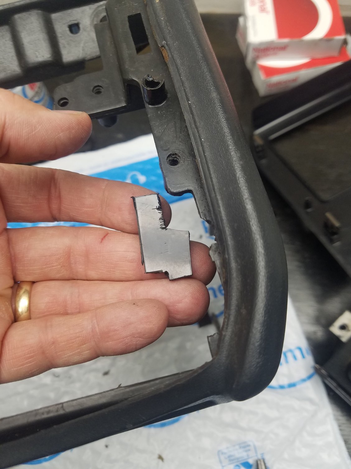

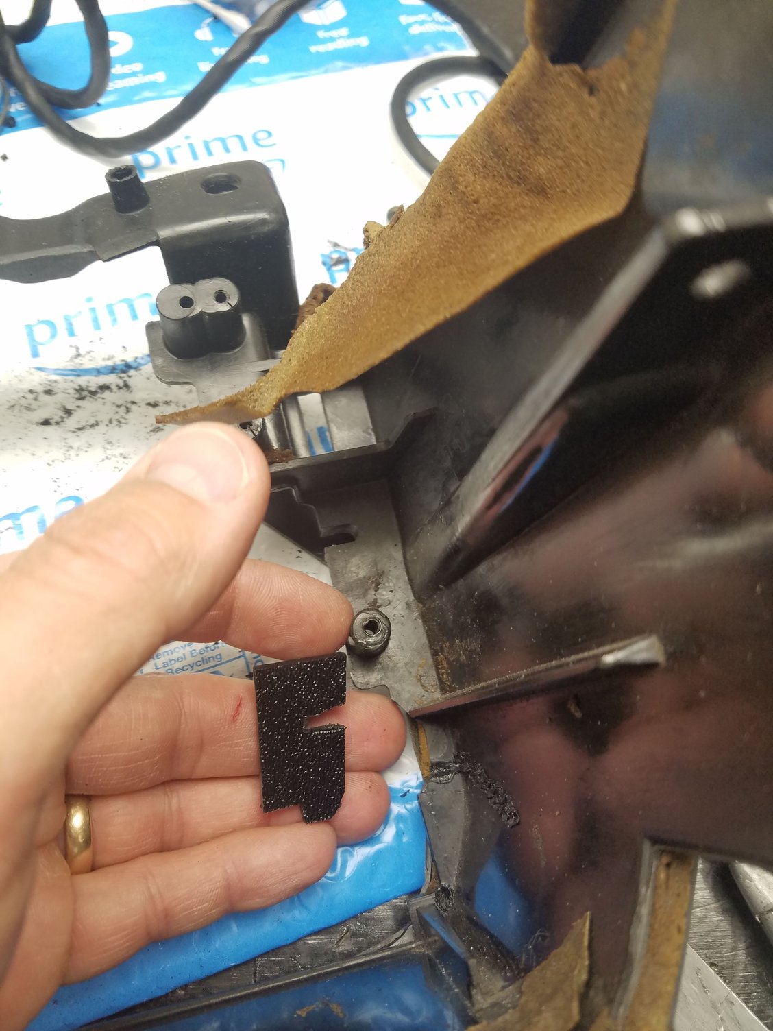

The next thing I discovered was that the lower tabs AND bolt holes were missing from both sides and both radio pods that o had. Went online to view some pics and confirm rough placement of the holes. Used my two cover plates to see the location of the slots for those to fit into.
Time to rebuild some more of the structure!
Using a scrap piece of ABS sheet, I cut out this section to build up the backside of the brace. Piece is shaped to make maximum contact with rhe original material, yet leace room for the slot for the radio faceplate.
Cemented in with ABS contact cement.
Toop piece cemented in to create the slot for the faceplate.
I am going to follow up with some welding to help blend the pieces together and build strength. Use lots of virgin material to fill the gaps. For the lower holes, planning to build up more material behind, the drill thru it after everything is bonded.
More pics to follow! Need to repeat all steps on the other side too.

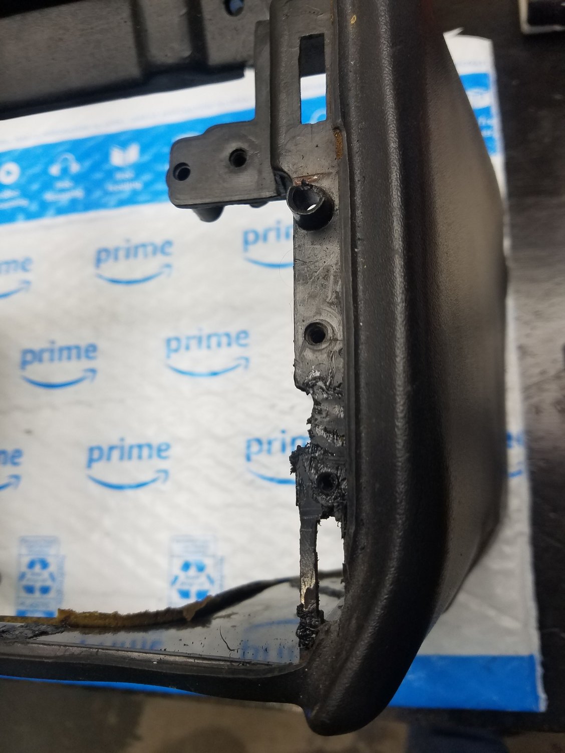

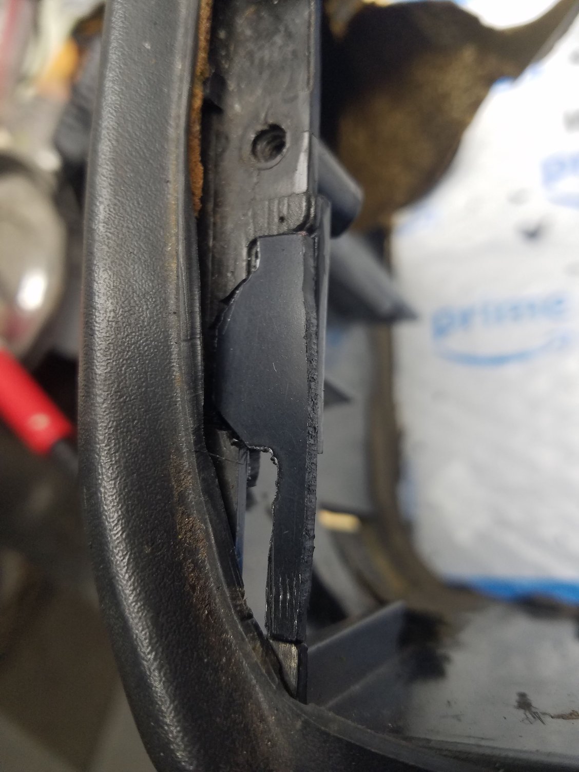

A pic of the backside with all the welds on the cracks and the finished slot.
All welded in wuth new material. Feels very solid.
Used a needle file to carefully enlarge the hole foe the faceplate clip.
First side done. Now have the second side to do. Thats a job for tomorrow...

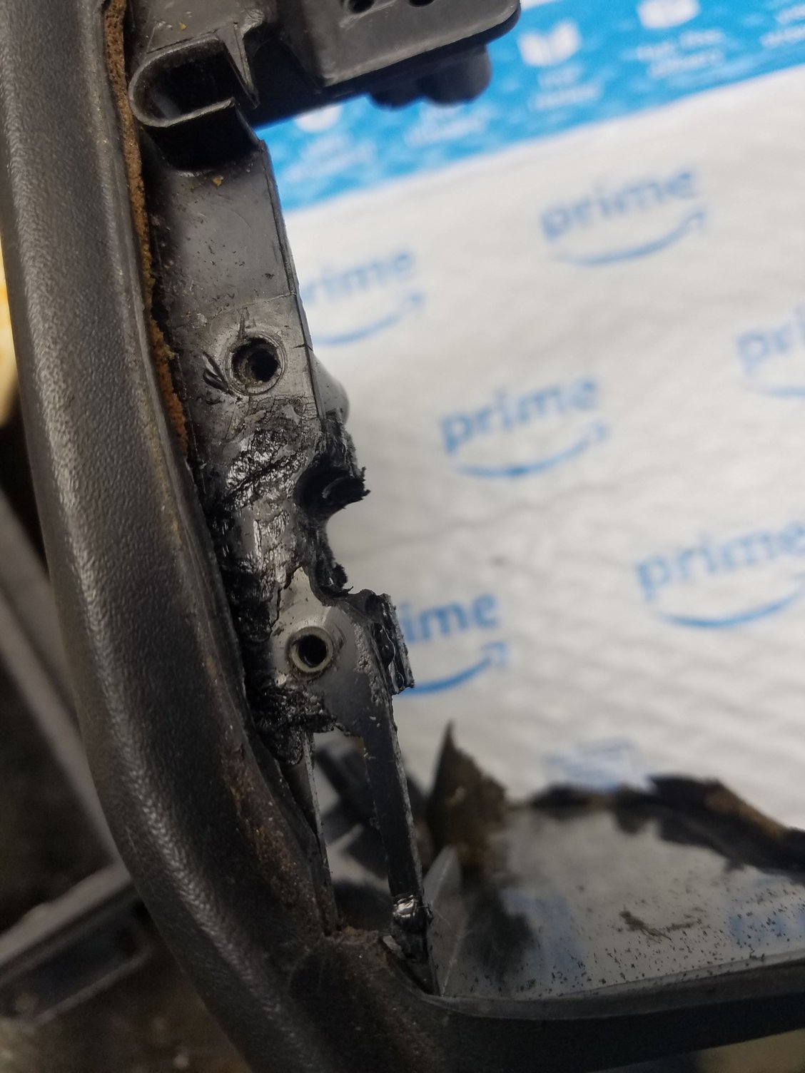

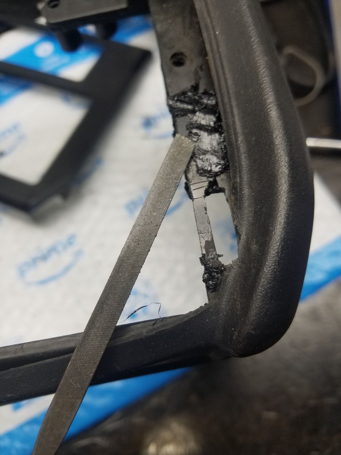

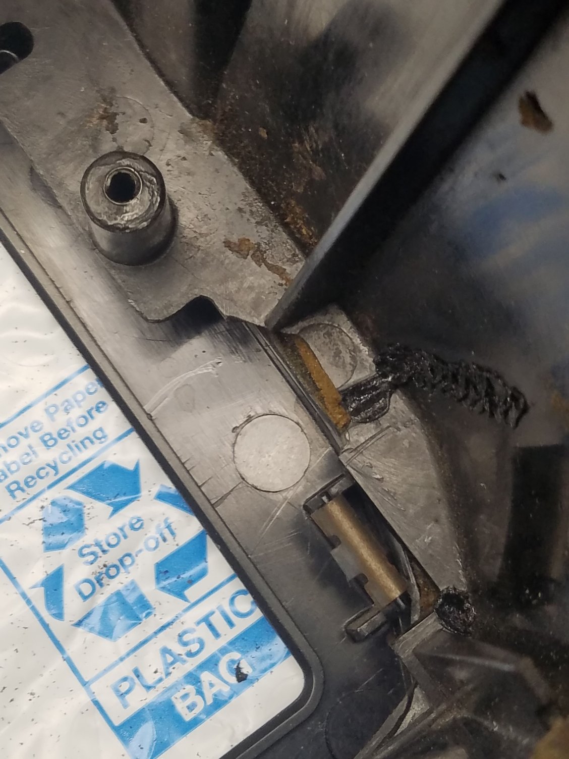

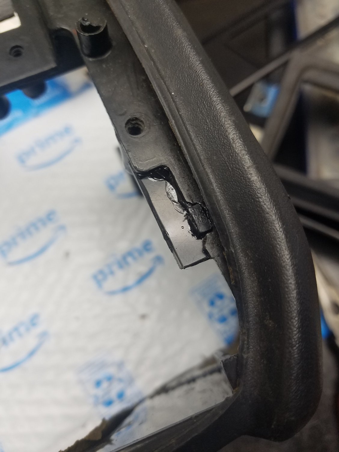

Worked on the second side this morning. With experience from the first round, went a bit quicker.
Made this piece larger to allow for more overlap, notched to fit around the molded support on the side.
Firat layer cemented in place.
Second layer cemented in to create the slot. Now need to file it down to fit the tab from the faceplate.
Once the faceplate fits in nicely, I plan to use two layers of thicker ABS sheet that I have to build up the backside to allow for drilling the lower radio mounting holes.

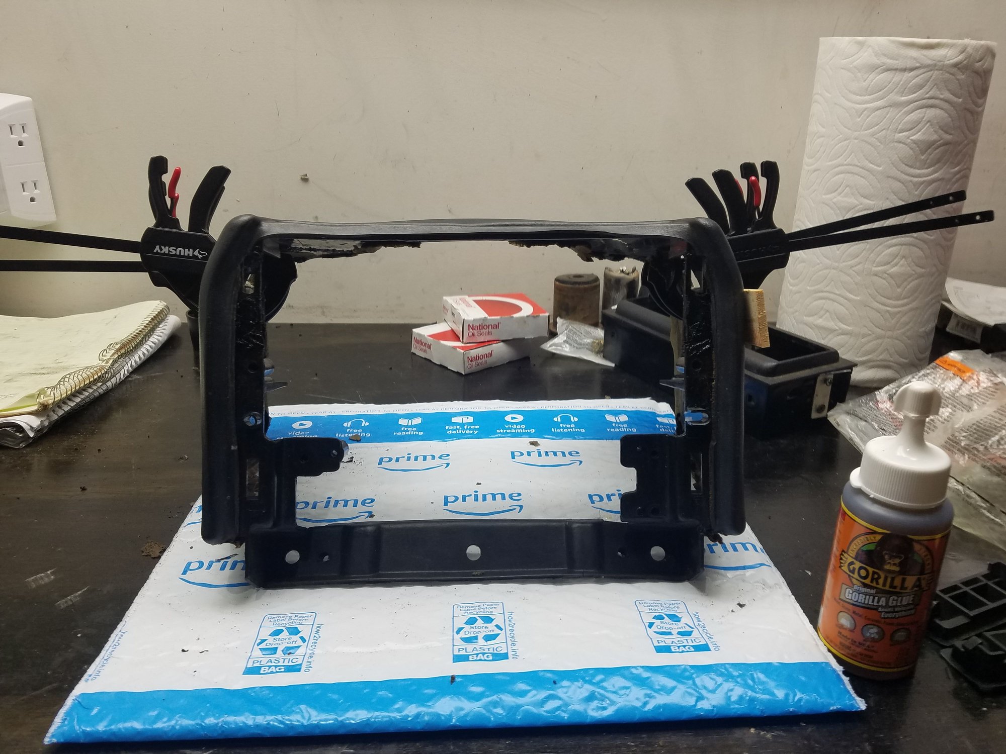

also going to try my hand at Gorilla Glue to pull the vinyl wrap back into place. It has pulled away on the bottom - good place to test as it ends up being fully covered by the faceplate. Also have some slight pull away around the vent holes. Those will be step 2.

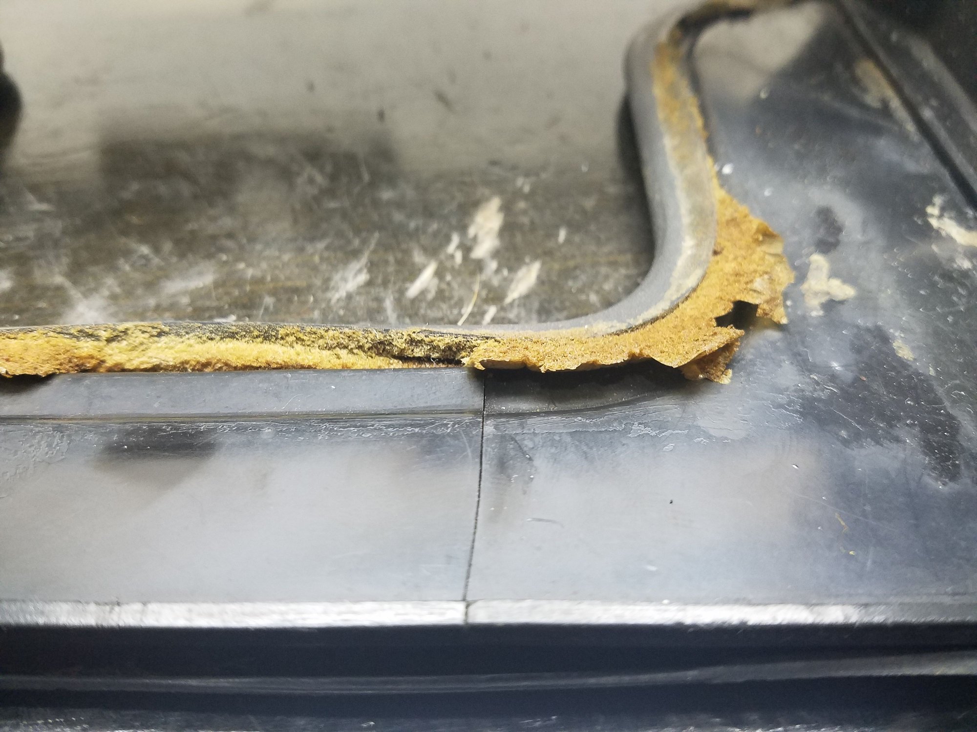

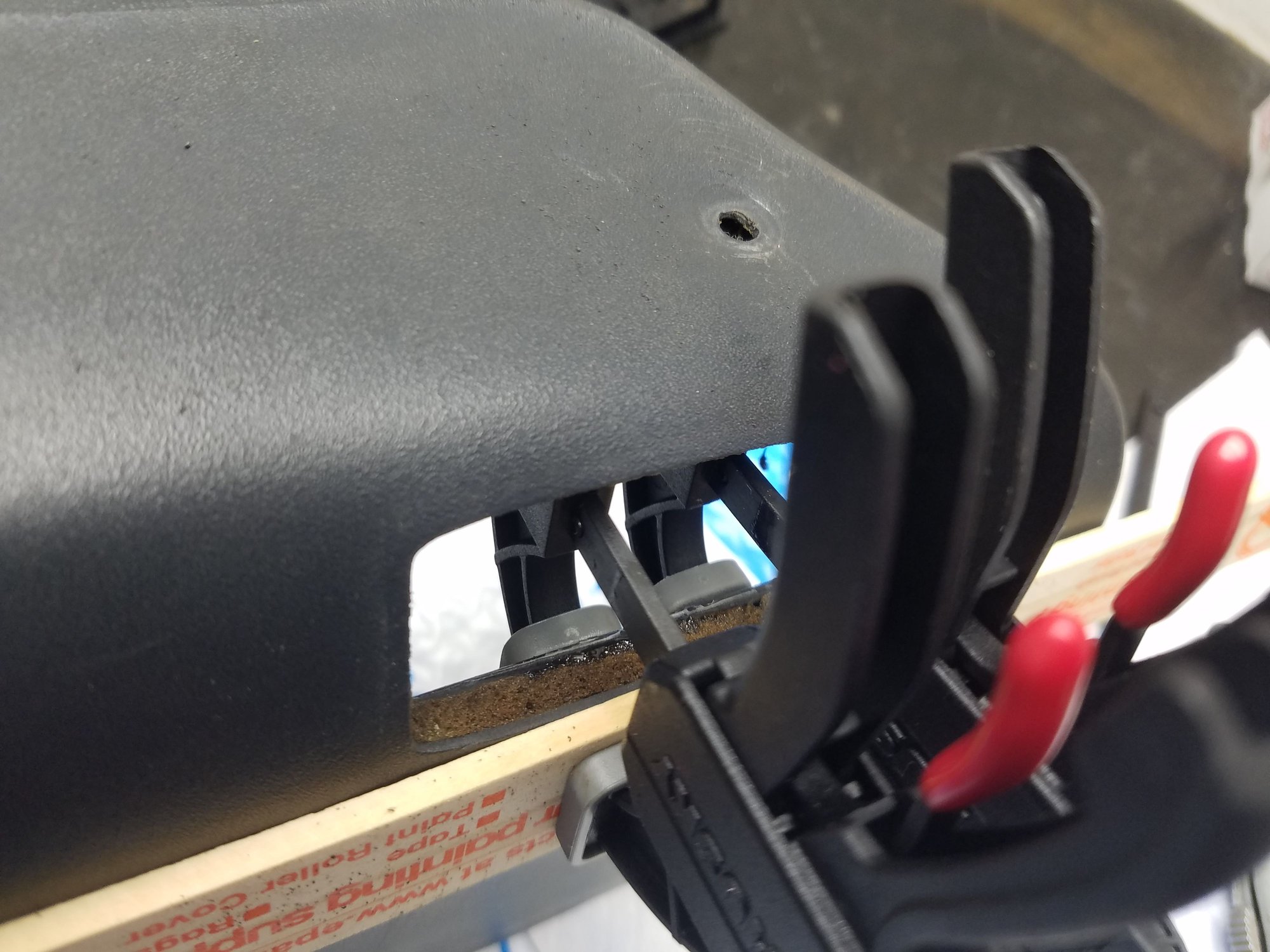

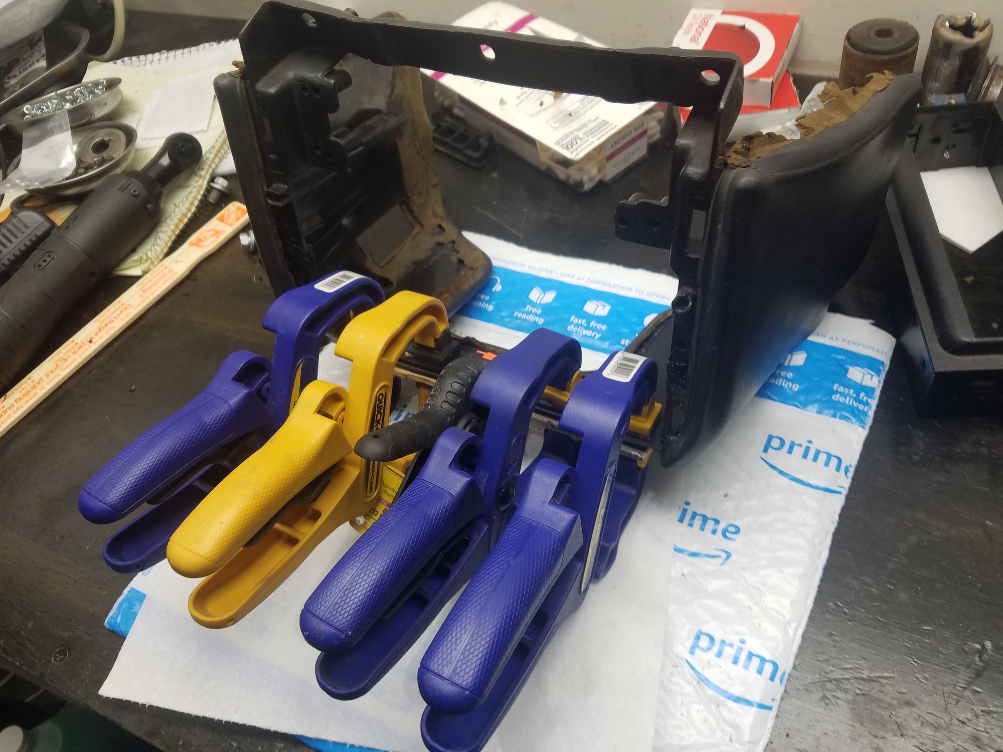

First, to fix the loose material at the bottom:
No adhesion along the bottom
Clamped up and will let sit for a day

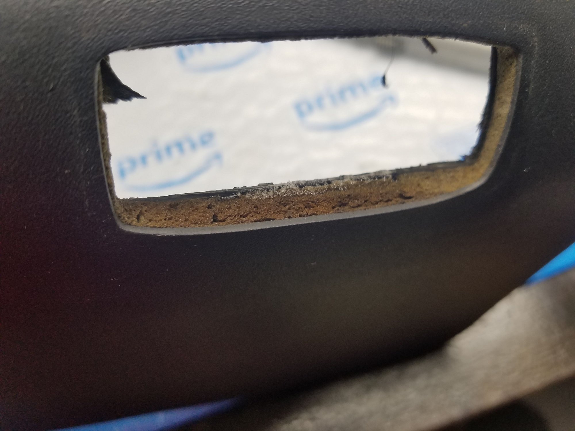

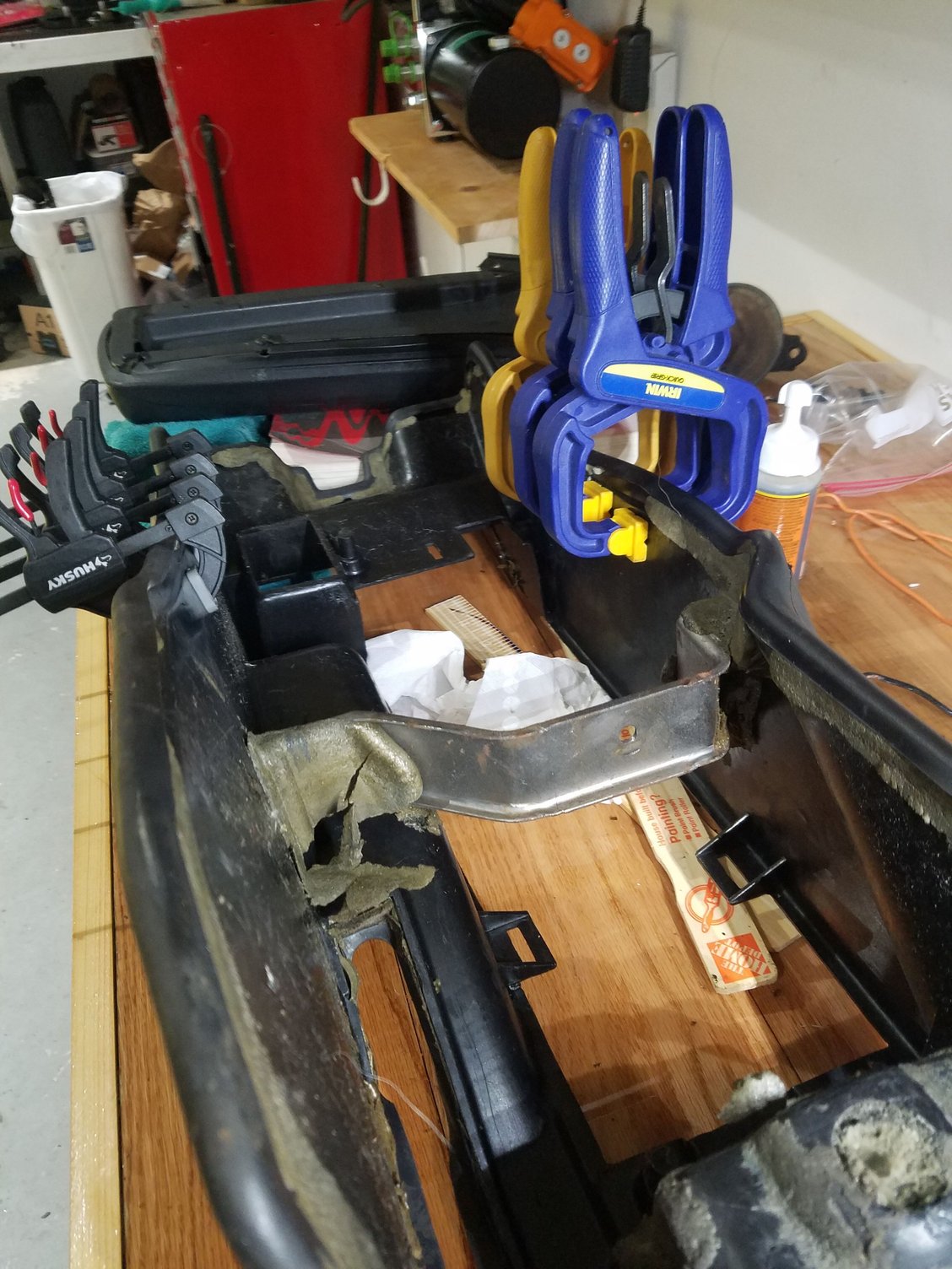

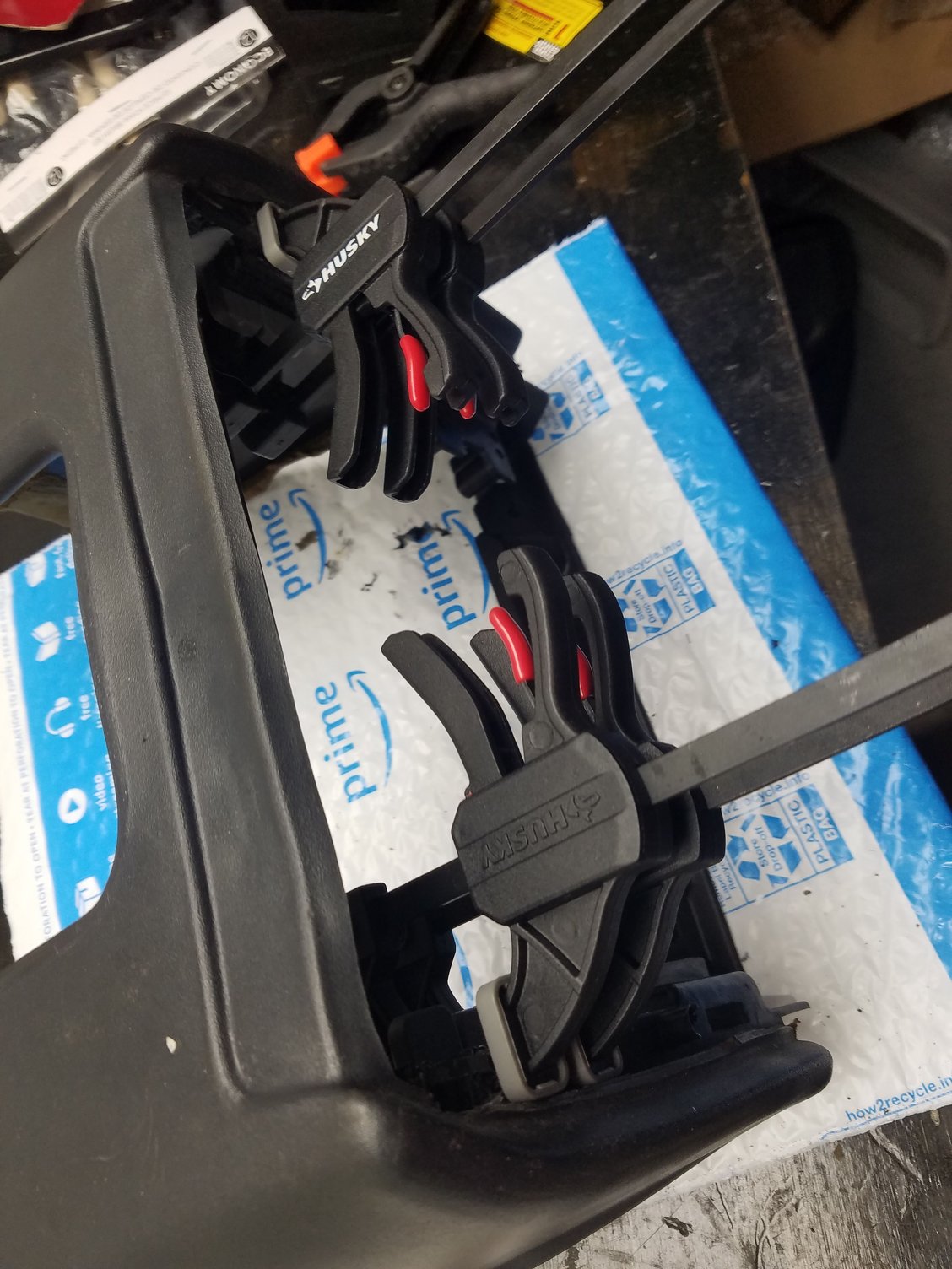

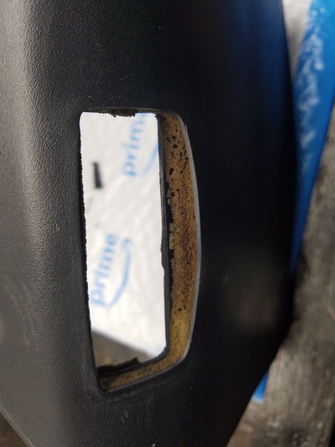

After 24 hours of clamping, the bottom looks great. Feeling that taste of success, I moved to the vent cutouts, which were also peeling. Bought a 4-pack of mini trigger clamps from Home Depot just for this job. Perfect size for the opening, but $24 with tax seemed massively excessive. Harbor Freight has little 4" clamps for $2 each. Would have gone that route, but knew a trip into Austin would make the wife very upset, given the situation. So... buckled under and paid for the HD pack. As I said, good tool for this job.
Both sides of the pod were peeling like this from the top side of the opening.
These little clamps were just small enough to fit thru the opening. I hope i can come up with some other uses for them in the future!

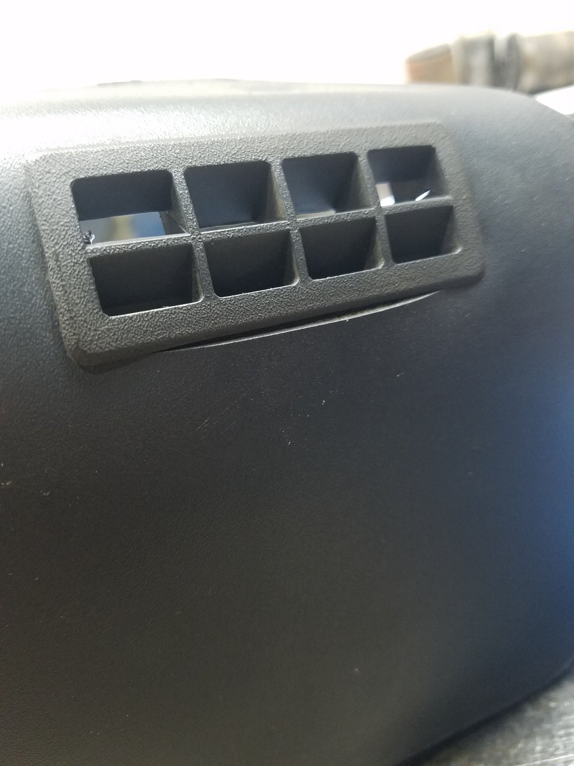

A little disappointed when I installed the vent. The vinyl no longer folds up and away, but the edge is still visible as it is not tucked behind the small lip of the vent. Certainly an improvement, so no complaints there.
Also, can anyone confirm this is the correct orientation of the vent? The actual holes are towards the bottom of the pod in the way I have it installed. Used my other pod as a reference.

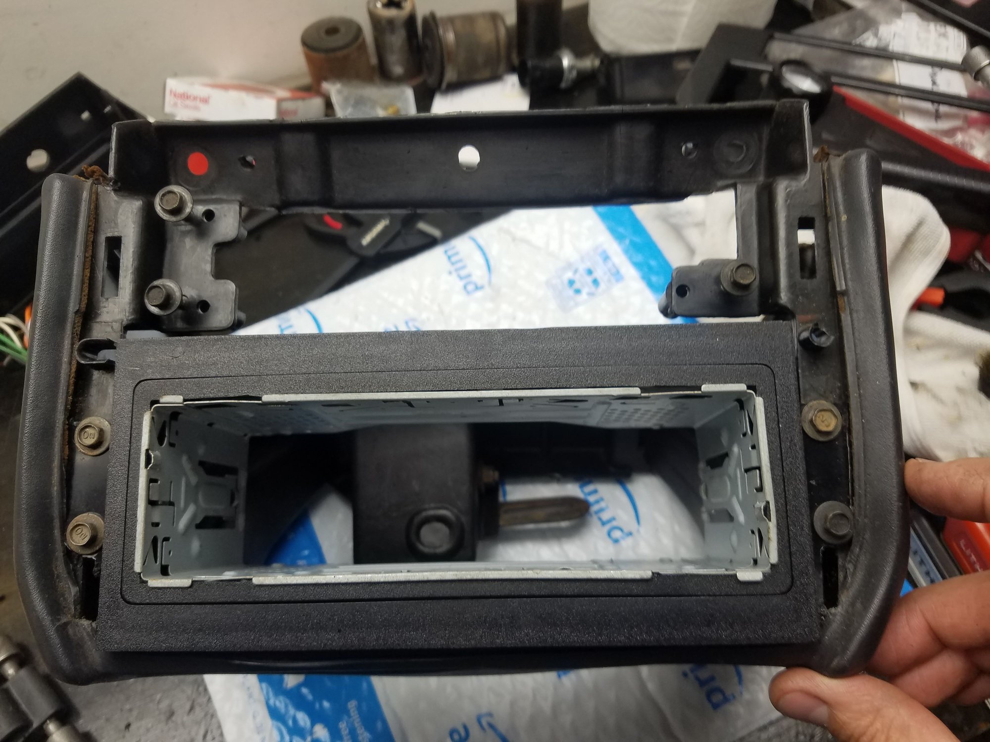

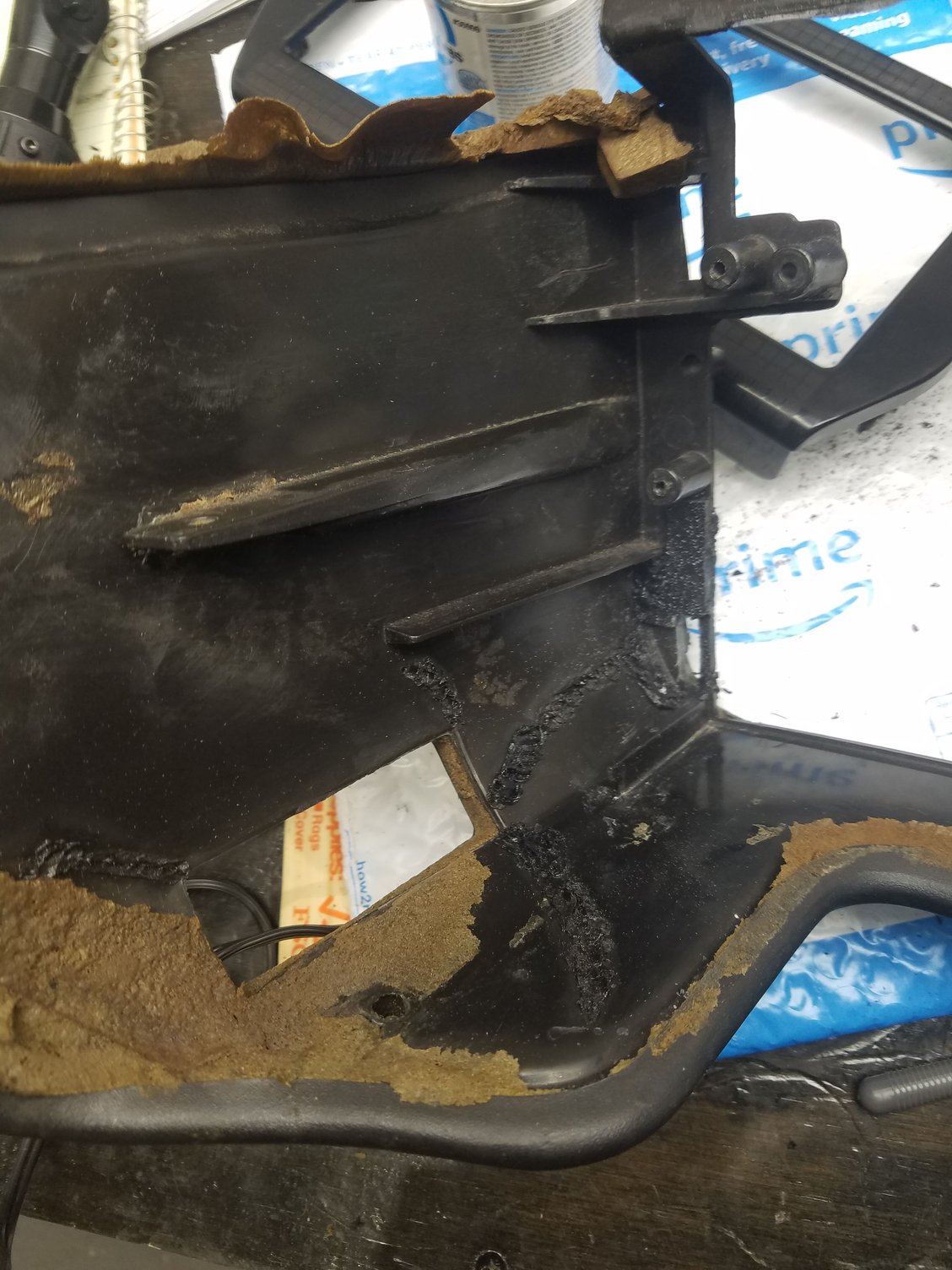

Nearing the finish line. Over the last couple days, I built up the backside of the mount so I would have plenty of material to screw into. Used 1/8" ABS sheet, cut into small rectangles. Four layers with ABS cement spread between each did the trick.
Terrible view of the layers, but I wanted to show the high dollar clamps getting a second round of use!
Better picture of the layered backing piece. I have just started to notch the area to make room for the single DIN housing.

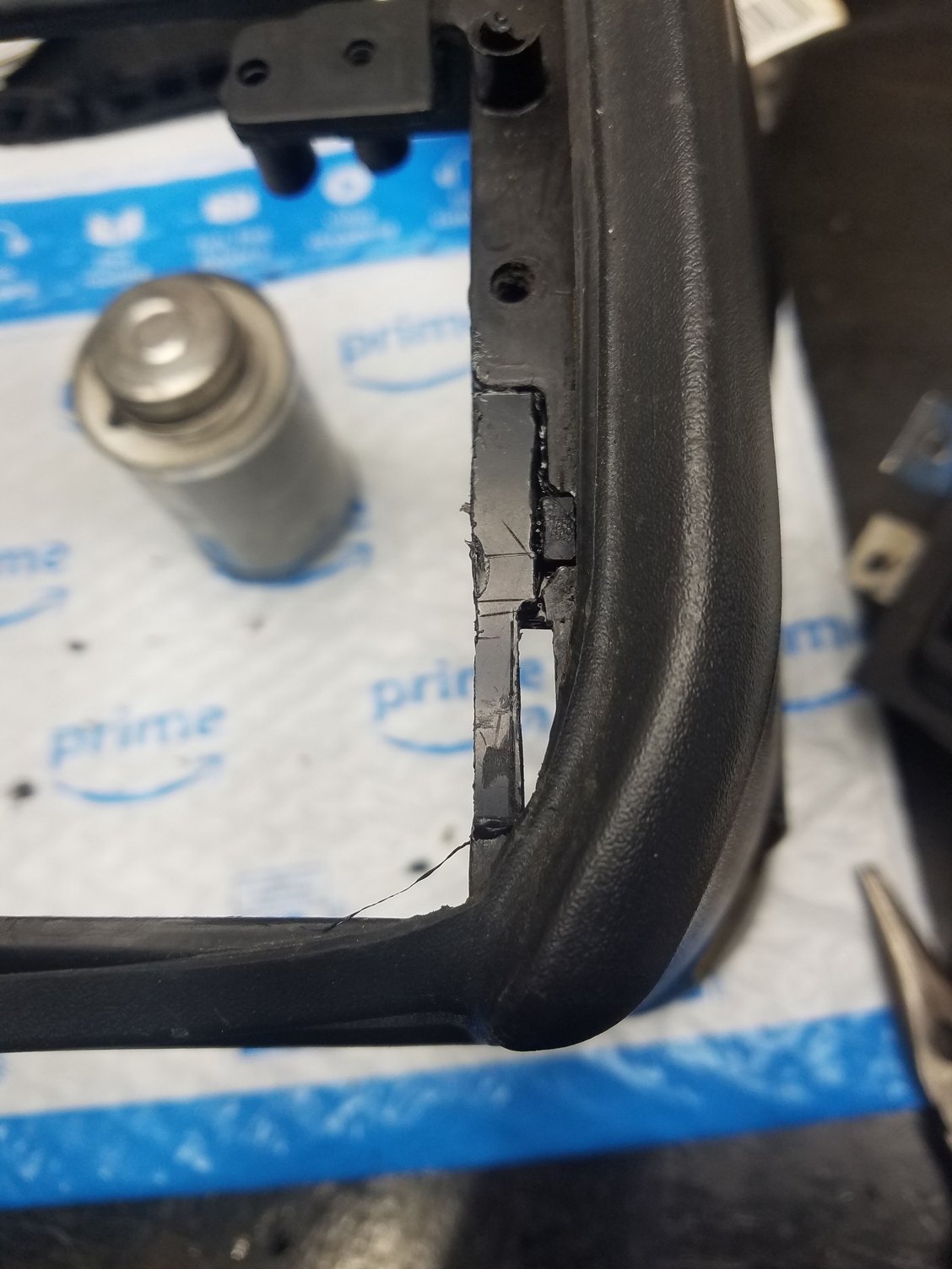

Both my project car and parts car came with single DIN aftermarket stereos and the adapter. While the project car adapter was missing some brackets, the parts car unit was complete. That helped locate the holes for the lower section that I had rebuilt. It also let me to realize I had to botch the area to accommodate the bolts that attach the bracket to the shell.
Never showed the cement I have been using. Had this for years from when I had to repair cracks in an old Suzuki Katana fairing. Works great, smells terrible.

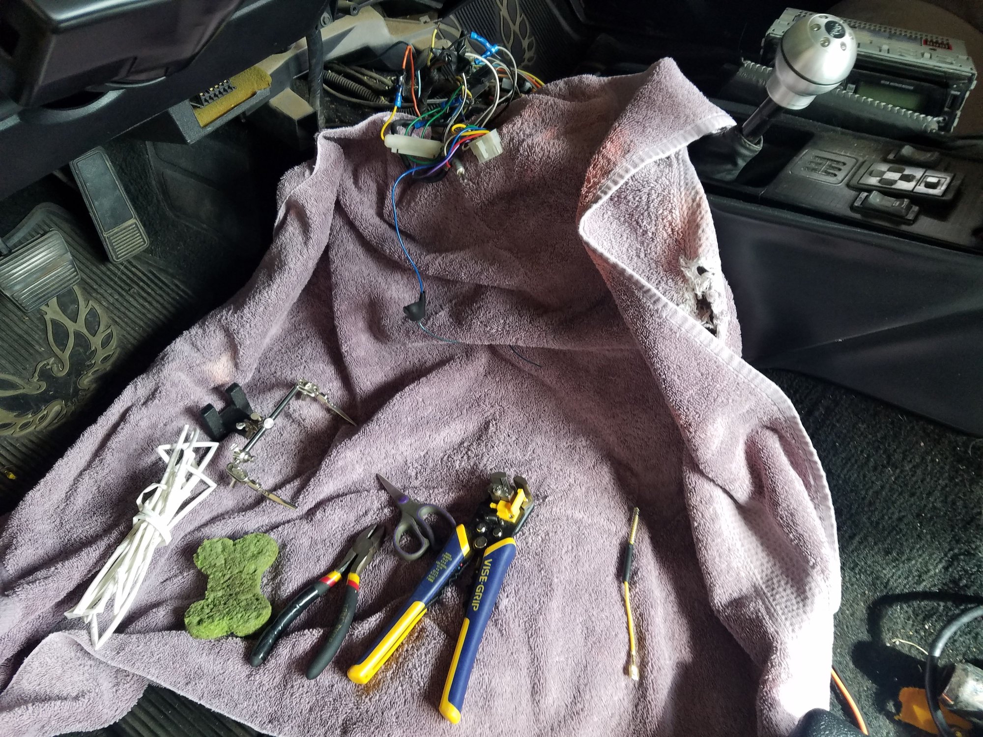

Next job is to clean up this crap-tastic example of wiring. Making good, solid connections with solder is so easy to do adter just the least bit of practice. Guess this one isnt the worst I have seen - the parts car had house-style twist nuts connecting the wires.

My work area to remove old connections, solder and heat shrink. Had seat out already for under dash work and steering wheel was only finger tight. Managed to break the rab on the brand new horn wire when I yanked the wheel off. Sigh. More soldering.
