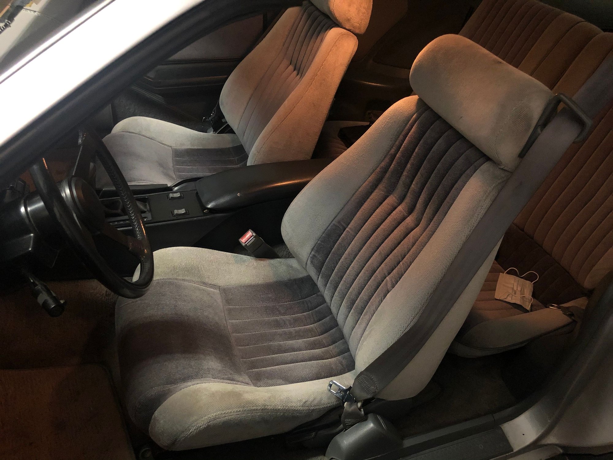

Thanks for your help, here’s my finished product, still very wet from cleaning .
Old Jan 1, 2021 | 06:47 AM
TransamGTA350's Avatar
Joined: Apr 2000
Posts: 1,537
Likes: 323
From: South Windsor, CT
Car: '89 GTA
Engine: ZZ6TPI
Re: Refurbish a driver seat with parts from passenger?
Nice job!
Old Jan 1, 2021 | 09:55 AM
naf's Avatar
naf
Joined: May 2004
Posts: 5,338
Likes: 73
From: Lexington, SC
Car: 1987 SC/1985 TA
Engine: 350/vortec/fitech
Axle/Gears: 3.27 9-bolt
looks good
and you'll hopefully note now that the refurbished seats are actually somewhat comfortable. no more lower back pain...

Thank you, I sit an easy 2” higher in the car. It really tidy’s up the interior.
