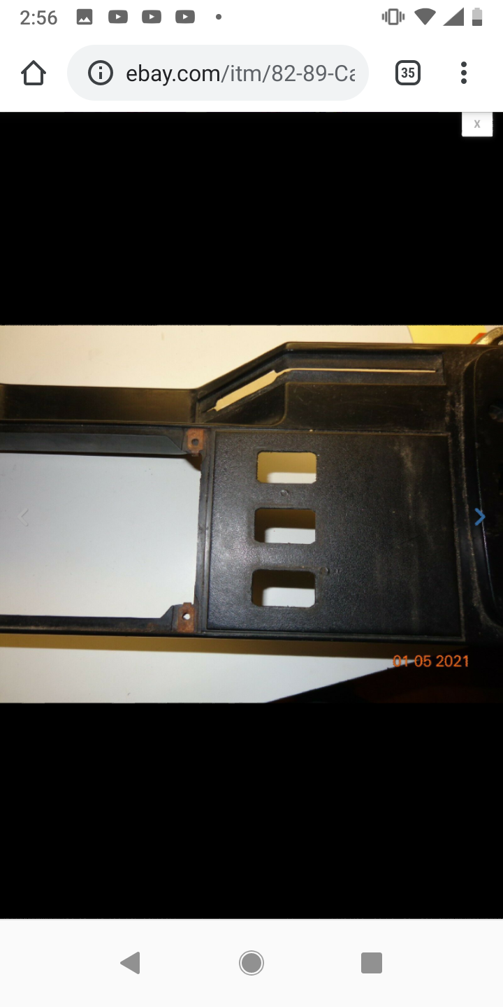

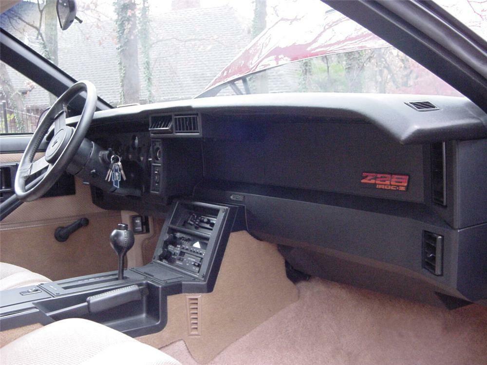

I was thinking bout this and started comparing difference but i cant seem to pin point the obvious anywhere here is a couple of pictures one of a 86 Camaro console and another picture of a 90 Camaro console so the 86 won't fit on the 90?

The console "BASE" is compatible. Look inside the center console; lift the console pad and look inside. The 90-92 has a "step" in the upper console panel ( the part the option buttons get mounted to ) that allows for the air bag sensor to get mounted under it (inside the console). Besides that - even if you deleted that sensor - the parking brake mechanism was changed and the 82-89 upper panel will not fit over it properly.
So basically there is no step in the top panel here in this picture so it wont fit my 91 or work with my e brake style?

I don't think your reading - or understanding - my post,.... this picture should clear things up for you.
