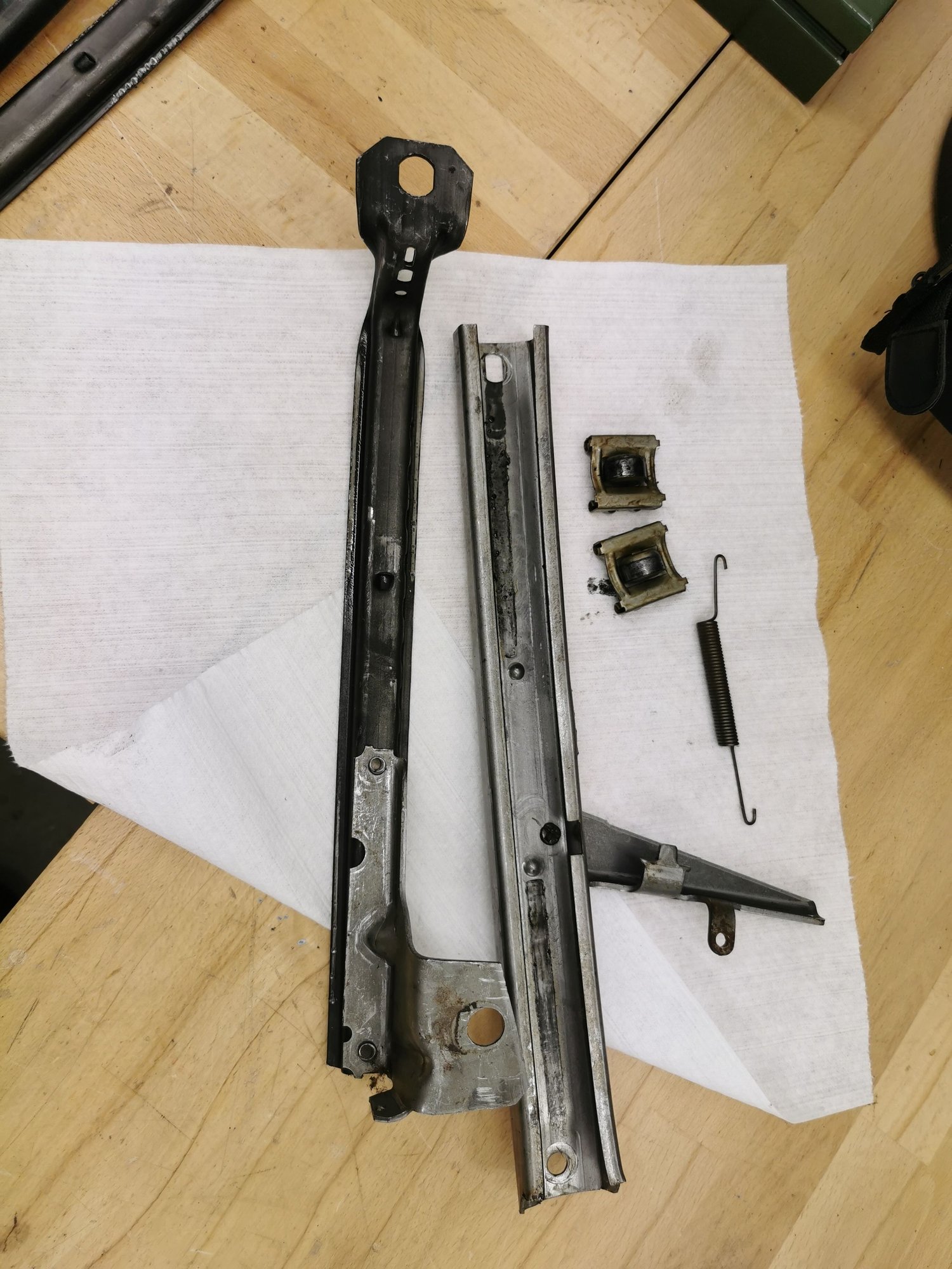

I took my tracks apart when I recover my seats.
I used spray paint and greased the track bearings after I cleaned everything
It's not necessary to powder coat them. They lasted for 30 years without any paint
