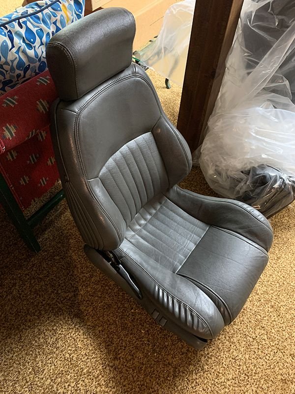

The header says it all... I found a decent pair of seats from a 2000 Trans Am. The original owner sold them to me, he put in a set of Corvette seats. I powered up the seats with a harness I bought from Firehawk Jeff, and the drivers seat motors are perfect, the rear center and side bolsters on bot seats work. Just out of curiosity were the seat bottom bolsters inflatable? I've seen pictures of nice bolsters and also ones of semi-wrinkled ones. Is that just the foam that needs some work or were there bladders in the lower side bolsters? My seats are pictured below... see what I mean about the wrinkled lower side bolsters?

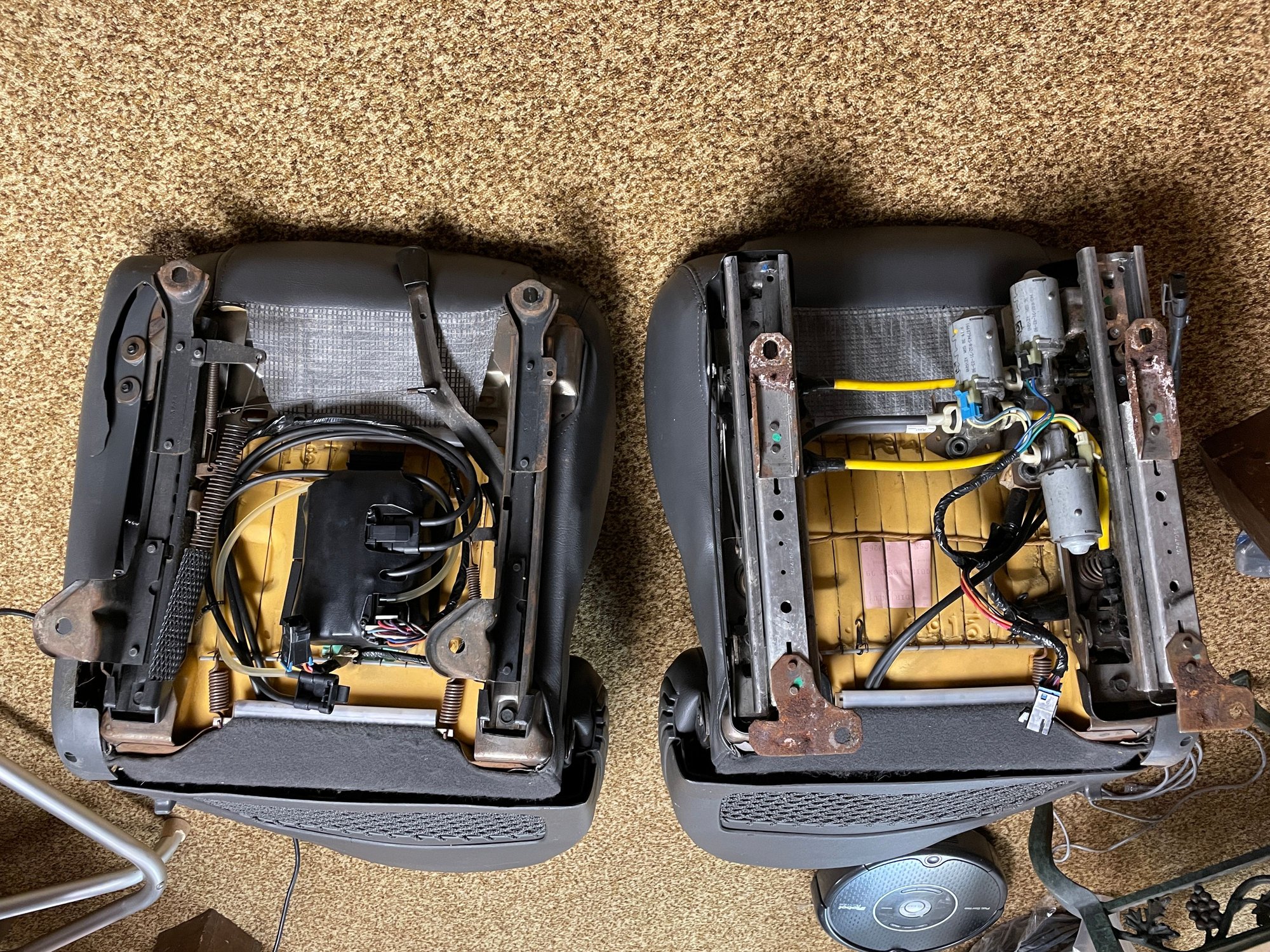

Here’s a picture of the bottoms.
tabs were not useable and figured that I had to fan new tabs that go on the opposite side of the track, then weld them on. I am not home right now so I can’t check the PS seat rails. In picture they look somewhat similar in length but I will measure when I get home. Sorry for the generation mixup but yes, the seats are pretty similar.

You bolsters are wrinkled because the seats have been exposed to extreme temperatures, and the leather was not conditioned properly, and therefore it has shrunk. Extremely common on just about every non-low mile 4th gen (except for mine since I actually conditioned them regularly since new).

Navy… Ok thanks for the heads up on the wrinkles. AFAIK, the original owner took the seats out of his 2000 Trans Am 3-4 years ago, wrapped them in plastic and stored them in his storage shed. He replaced them with corvette seats. So yeah, definitely not climate controlled but I’m not using any part of the leather, the seats will be redone in white Naugahyde to match my Camaro’s interior. Bladders appear to be in good shape, I inflated bolsters then left them for 3 days, then pulled plug, that’s when they deflated.

Mike the wrinkles pictured above are probably due to the seat getting wet it happened on my 99 T/A just like that my pass window was cracked and we got rain. the wrinkles are the vinyl part of the seat reacting because the leather shrunk up. not because you didn't put some leather care or special potion on the seats! I had sent you my email wanting pics and never rec'd anything??

Hey guys... I know its 3rd Gen and the seats are 4th Gen, but maybe someone knows the wiring? I wired the harness up using the plug and everything seems to work fine. The center bladders in both seats work, the bolster bladders in both seats work, the seats go up-down-forward-back just fine. I noticed these two wires when I removed the tracks from the driver's seat. There's an Orange wire and a Black wire with crimped connectors but I have no clue as to what the purpose of those two wires is. Haven't checked them to see if the Orange is hot, have to go grab the battery again. But since everything was working what could they possibly be for? These seats aren't heated are they? I would think if they were, the wire would be heavier? The only other thing I could think of was maybe there was a passenger side power seat option and this would power the motors?
Edit: LOL... Thats what I get for testing in the dark. Turns out those ARE the power/ground wires. I did a low voltage check first to see if there was any reaction and they barely moved. Connected the battery to them and all is well. Last thing I wanted to do was short out the motors or the compressor.
