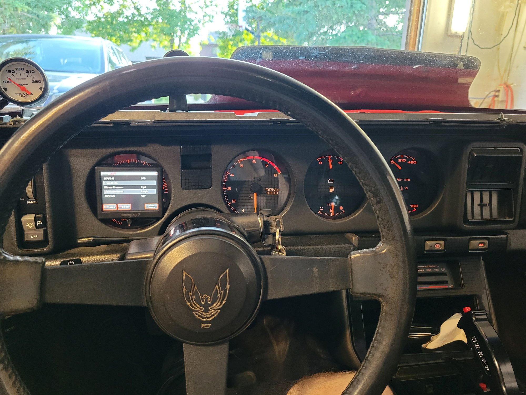

I fit a 3.5" LCD screen in the cluster

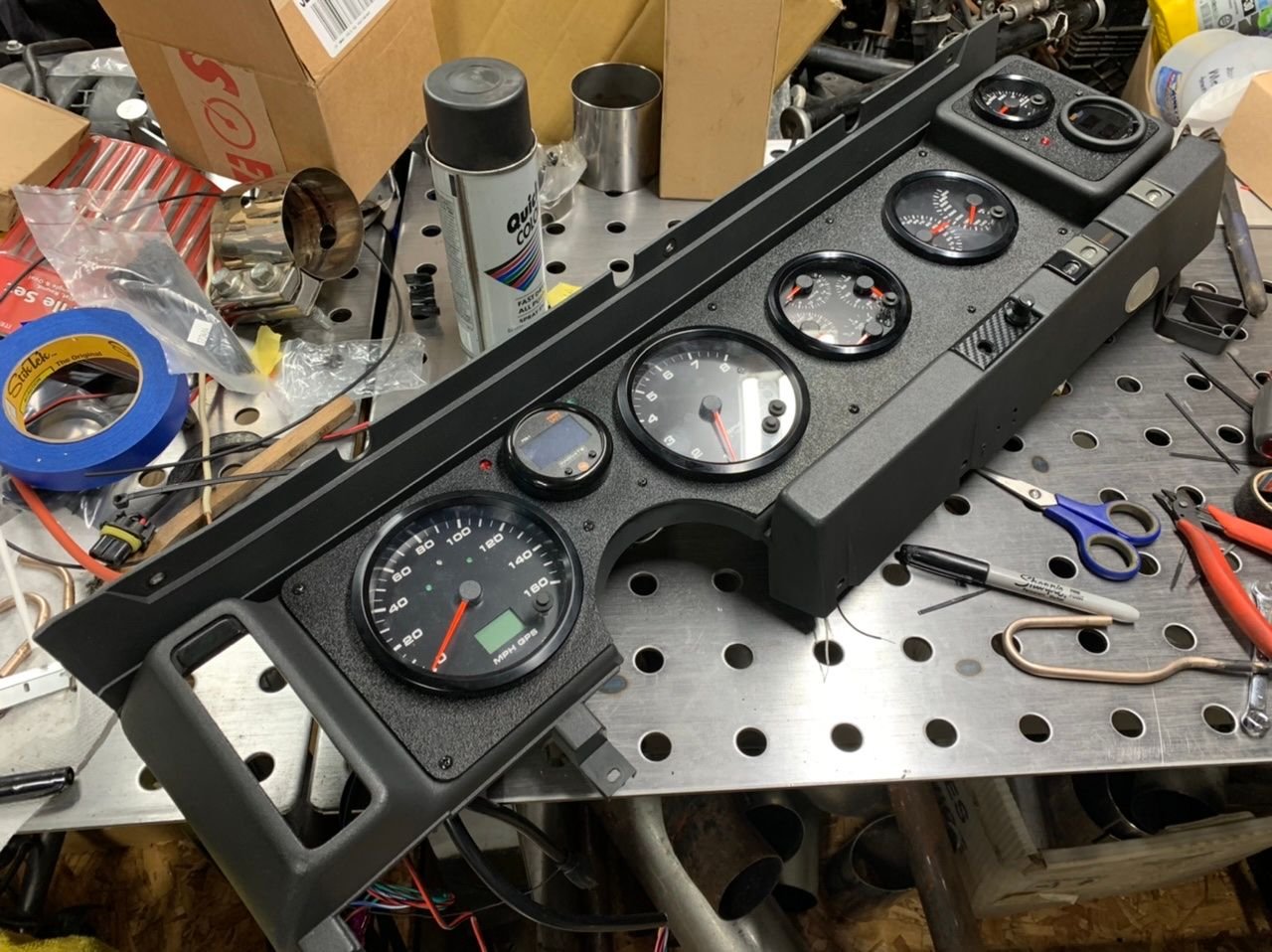

12” pro dash should be easy. Cut a rectangle hole for the digital dash inset in the stock cluster. Then slap a 1/8” abs sheet on top and cut the hood and trim for a tight fit around the digital dash. If you get some kind of bezel it could look really clean. With the stock gauges removed you have like 3” to play with behind it of open space. I did something similar with the speed hut gauges and it looks factory minus the newer nicer gauges.

not really I guess the hump for the steering wheel will be an issue but you could offset it to the pass side.

no, that’s the finished product. With mine I meant you can’t tell it’s not stock if you don’t know what the stock gauges look like but its not a crazy layout where things look out of place.
if you want what I think you mean ( and u got the time) there is a guy who lays the digital screen behind the stock bezel and then designs a custom layout in photoshop and imports the design into the digital dash and then builds gauges on the dash to match photoshop layout and it looks awesome.
