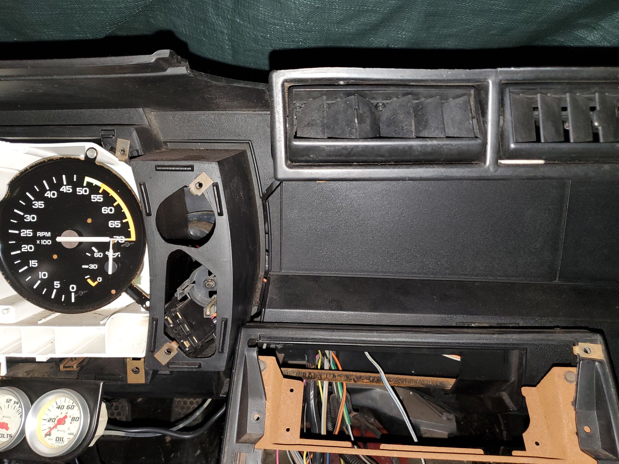

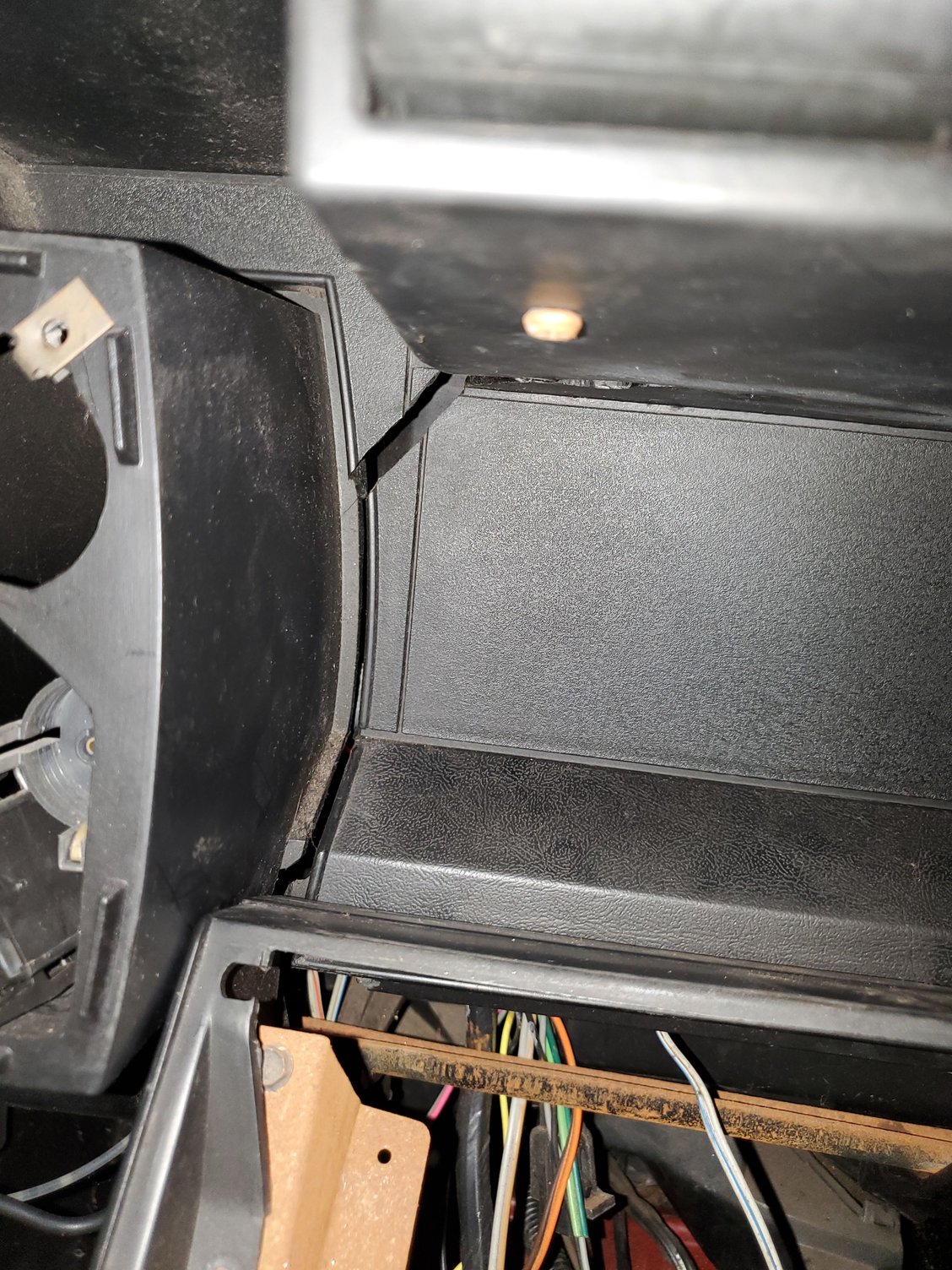

It's there a different between 86 iroc lower dash panel and 90 lower dash panel..My 85 dash is cracked by the defrost button.

Dang I can't find a dash my year. I guess i will epoxy glue it with a brace on the back and wrap the dash in leather

I had cracks elsewhere on mine but used plastic epoxy and fiberglass mesh for support. Holding up fine 13 years later...

Mine is cracked/broken in two big halves. They're held together with strips of sheet metal i riveted to the dash across the crack. There's 4-5 strips from the center vents down to the corner by the radio bezel.
