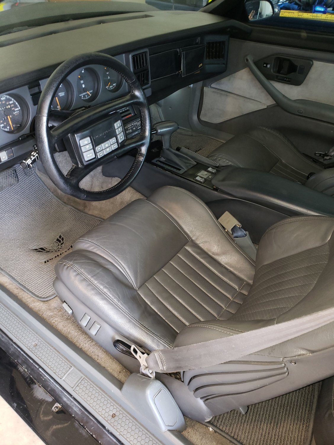

I have a 1988 gta. I found a like new black center console but I am wanting to paint it back to the grey color. Where can I get grey paint to match?
