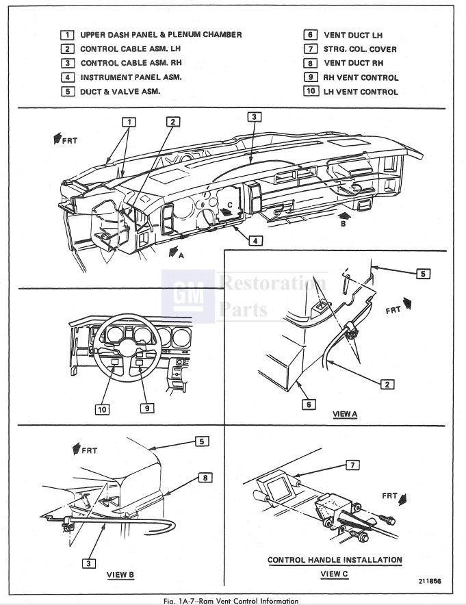

On a non-A/C car there are ram vents in the corners of the lower cowl that are controlled by the pull *****.
If you remove the hush panels under the dash you should see the vents and flapper door assemblies. Left
cable is almost straight line to the vent. Right cable curves and goes behind the center console and bottom
of the dash.
There are some pictures in the service manual under the heater section.

Two days ago, i undertook this project. Removed the hush panels. In the end I got the right side vent working. cable was seized but easily freed. The flapper in the vent closed too tightly as to make the pull cable non functional. Lubed everything & all works. have to remember to not push the right vent control fully closed. I did not want to modify the cable at the vent,
