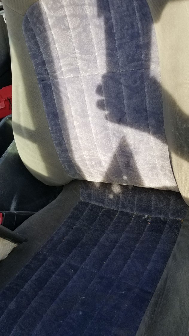

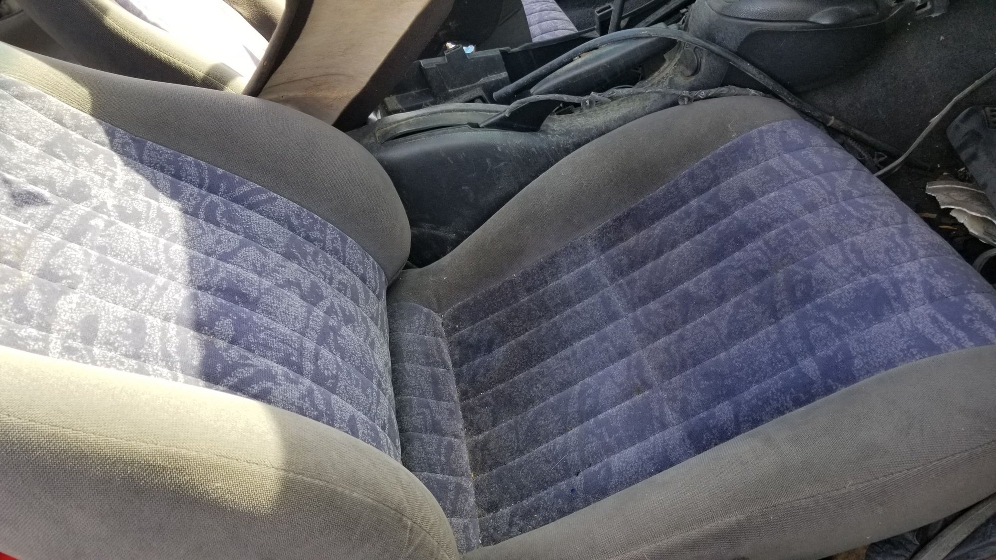

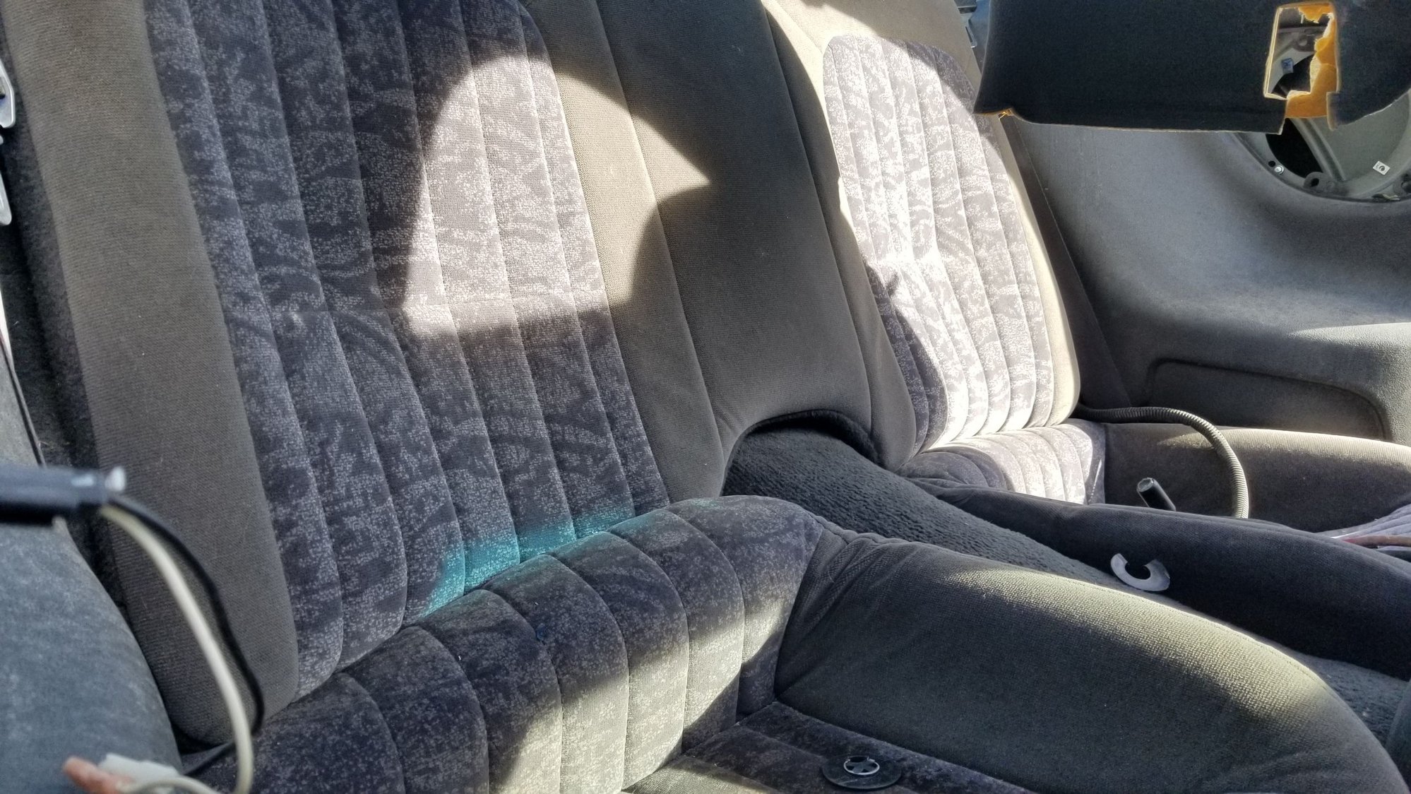

Speaking of, I was browsing a local Vegas junkyard this afternoon, and I saw a 2001 Camaro in "purple," although it looked like dark blue, and it had a full set of 4 very nice seats that were grey with multi-shades of blue inserts that would look good in and brighten up a 3rdgen dark blue interior, and they were electric, and I thought of your post. I clicked some pics, but now I see you're in Indiana.
But this might give you an idea of something you might want to look for. For these, specifically, one seam on the driver's seat has popped, likely from sliding in and out of the car, but other than that, they're hardly worn at all, not even stained. For being in a junkyard car, STILL in a junkyard car, these are "immaculate." A thorough cleaning (to get the previous owner's smell out of them), repair the seam, fix or replace the electric switch cover panel, and these will be install-ready. The sun was freaking BRIGHT, so I could barely see what I was capturing in the phone's screen, but I got them pretty good.
I'm not sure what seats go for in junkyards these days, but if you happen to be planning a drive out west in a truck, these would be worth a pass-through Vegas.
