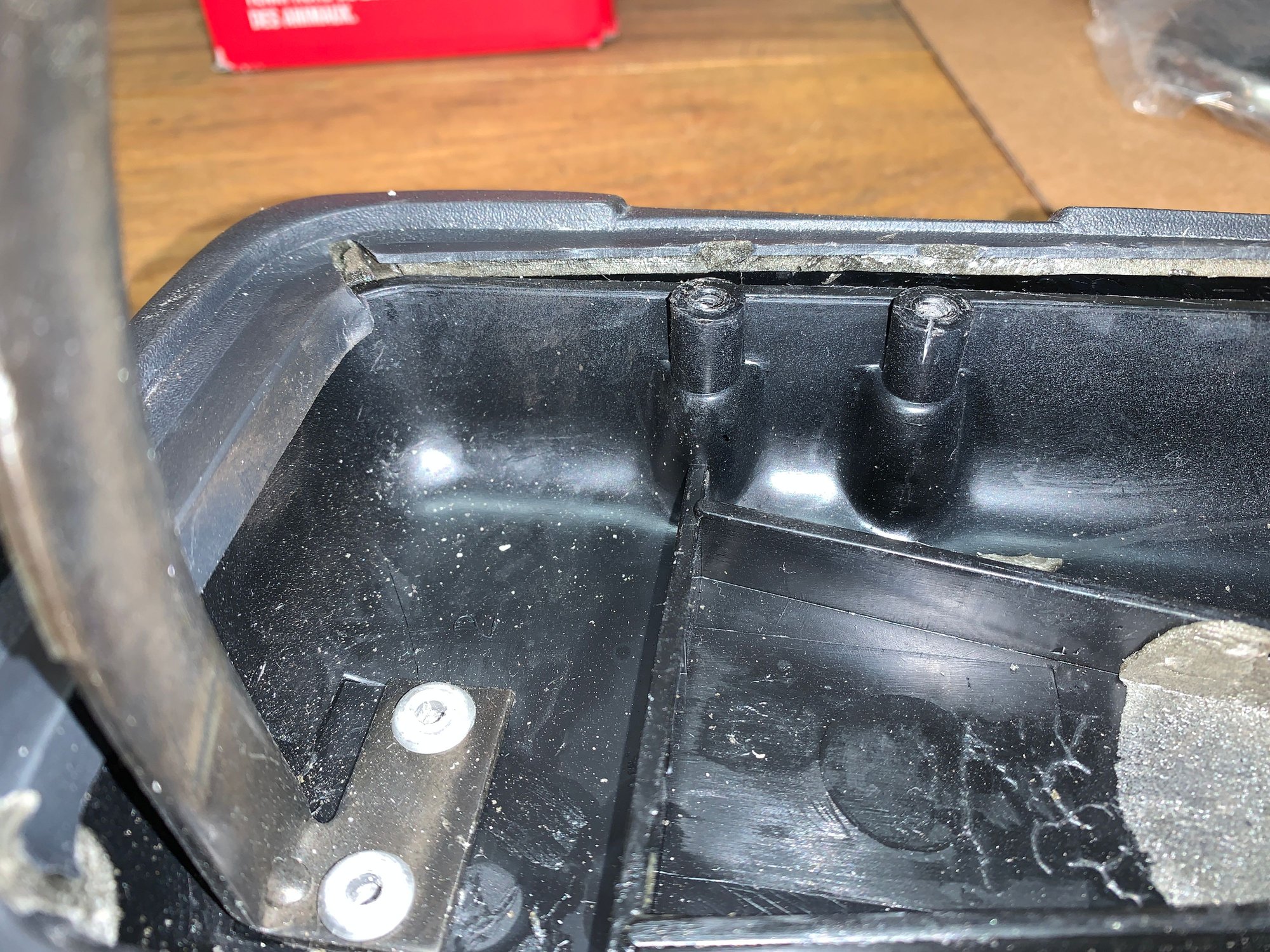

That was my post. It is a Firebird Lid, and was total junk plastic inside. I made it work using a whole tube of two component epoxy and eliminated the spring that pulls it down. I'm using a magnet to keep it from flopping. The Camaro lids you show look much better

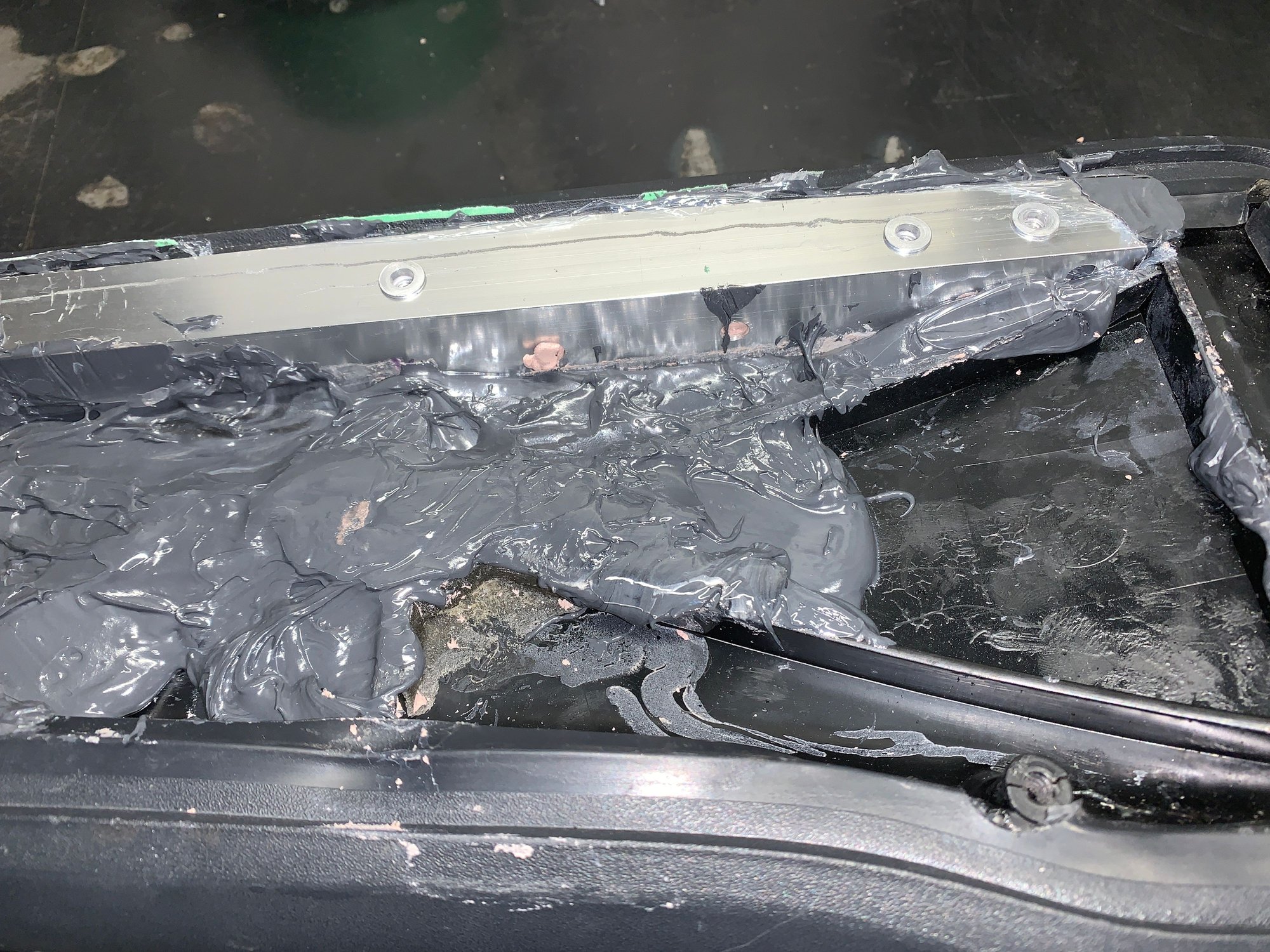

Mine was cracked as well and I just got through installing a piece of aluminum angle inside with 8-32 nutserts.
The hinge anchors were also broken.
Aluminum angle with nutsets installed using JB-Weld..
When I was done I used fabric paint to dress it up.
I will have to see if it holds up?

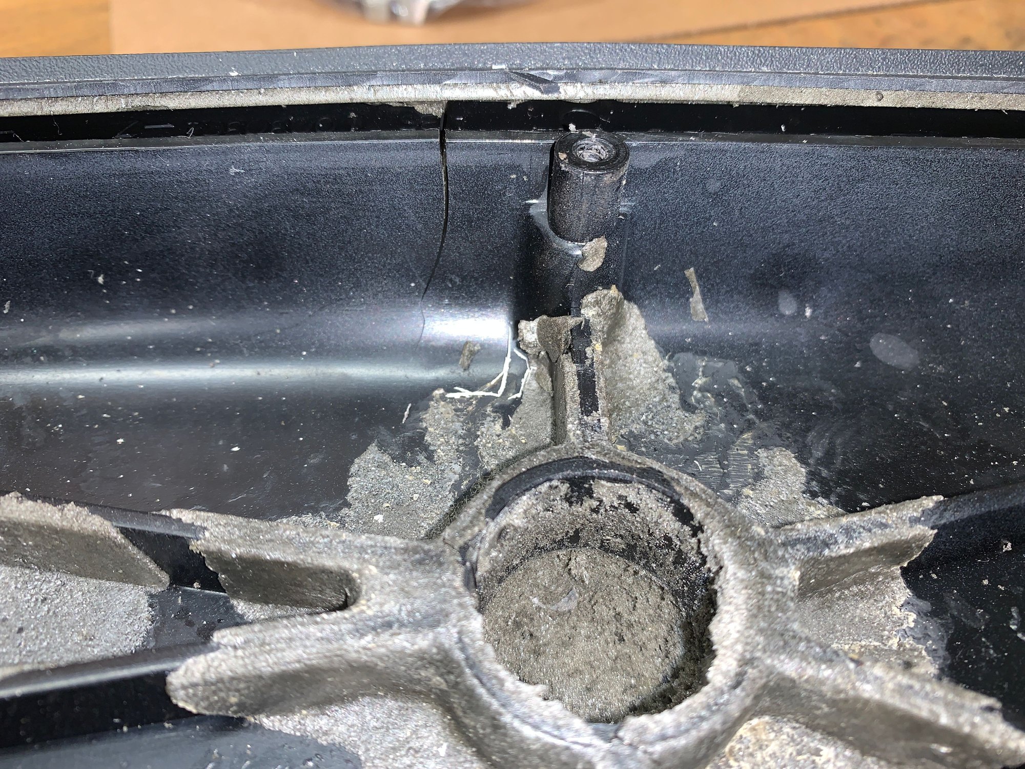

Well now, maybe I will be return this lid. I discovered two cracks on the underside plastic by the one of the latch screws. Maybe it was over-tightened.
We'll see what they say.

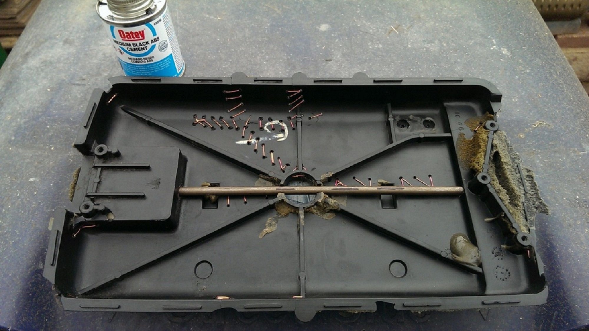

Fixed/reinforced mine by drilling holes, installing a steel rod, stitched the cracks together with copper wire and oatey black goop. Steel plate opposite arm w/ matching holes for rivets. Rebuilt pad w/ expanding foam . Been good since 2014.
