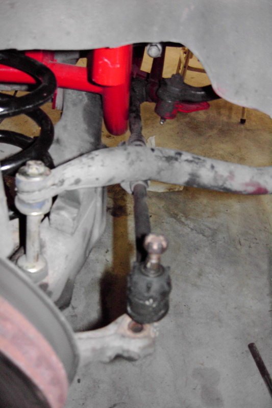

Hey guys, just wanted to put this out and see if anyone else has had any problems.....
I went to put all my front suspension back together, and the passenger side tie rod is hitting the K-Member so I can't get it far enough towards the spindle to connect.
Also the stock lower A-Frames, seem to rub on the front side on the K-Member as well, dont have any pics of that here....
Has anyone else run into problems like this?

mine rubs a little but didnt come in full contact, but those k-members seem to differ from cars to cars. I had to use a bottle jack and a 2x4 to spread it a little so i could get the bolt holes to line up.

I'll let you know how my cut springs work when I get the car on the ground, but until I can sort out this tie-rod issue I'm pretty screwed.
And after looking at it some more, the stock A-Arms are also rubbing, I can see paint from the k-member on the front side of the a-arm and a big *** scratch in the paint above the front of the a-arm when the a-arms are at full drop.
This fitment isnt very good, I sure hope bruce gets back to me soon.

Nope, havnt figured it out, Bruce says he has done 20 or so swaps with this K-member and never had a problem.
I'm either going to:
A) Flip over the center (drag) link, so the angle of the tie-rods starts from farther in front, and hopefully clears the steering box and idler arm.
or
B) Notch the holes in the k-member, take a BFH to the underside of the car and 'massage' the body to allow the K-member to sit back farther.

Any of you guys ever get your k-members? Anyone installed the "old" one recently? I'm curious how everyone else's "old" k-member is going with regards to the steering.
My update is this....My car is put completely back together, its been inspected, and its ready to drive....
Except the ****ing steering still isn't right. If you look at the pic of my tie rod above, you will see how it hits...so, I flipped the drag link over to get some more room. Problem with that is, steering geometry. I'm not sure exactly how much of a difference it makes, but I'm pretty sure its significant enough. Just visualizing in my head, if you move the drag link up, you are taking some of the travel out, which can make the wheels turn different amounts. At least thats my guess since I now have some serious rubbing and I practically can't turn the car around. Granted, I'm running a wider rim than I should (ZR1, 275s), but they did not rub with the stock k-member, and now I have two nice silver spots on the framerails where the rims are hitting.
So I've been investigating getting a shorter drag link and steering arm...basically that isn't working out so well, I can find shorter ones, but they don't fit the drag link...right now I'm waiting on a machine shop to hopefully make some shims to make up for the larger holes in the pitman/idler arms. Somehow I doubt this is going to turn out how I want though.
So I was looking around on the net and I come across this pic:
Is it me, or is his drag link on backwards?
God I don't want to spend yet even more money to go with the rack and pinion...especially because I have a really bad feeling that there will be issues with that too...seems like nothing I buy actually fits :-(
Anyway, if anyone has some advice about how to proceed, or can post up pictures of their Hawk's k-member with a similar angle to my above pic, I would apriciate it.

put it back on correctly, and move the idler arm forward...
problem solved.
btw, this wont apply to you, but to the guys running stock style tie rod connectors:
make sure the bolts on the crimp-clamps are facing away from the Kmember... otherwise they will hit.

Dude, how do I "move the idler arm forward"?
Do you mean elongate the holes in the frame forward instead of up/down? If thats what you mean, at what point to I move them forward, right now we have it in the all the way down position. So I guess my idler arm holes would then look like an "L" for both holes?
And that probably does apply to me, I have stock tierods, the pic above is from someone else's car.

The new Spohn K-Member has a clearance built into it for the steering linkage, cant say as to how well it will fit as I havent installed mine yet.

I talked to Bruce about that, he says spohn has redesigned them so they no longer have to notch them.

When did he do this? I just received my K-Member from them and its notched, plus it was a 4-6 week wait due to build time. If he redesigned them he hasnt starting selling that version yet.

I talked to him Last week, so my guess is any of the new ones being made as of last week no longer have a notch. Thats my guess.
loosten the bolts, and it'll move forward enough to clear... it does have some front/rear play... atleast i know the one on my sisters car did.. i changed it two months ago...

Sorry to bring this back from the dead, but I'm having the same issue with the steering linkage and tie rod arms hitting my tubular kmember. Any fix?
Old Oct 5, 2011 | 08:05 PM
Pocket's Avatar
iTrader: (24)
Joined: Jun 2005
Posts: 8,122
Likes: 362
From: NC
Car: 91 Trans Am
Re: Hawks Tubular K-Member Issues
Just band-aids like moving the idler arm forward, flipping the centerlink, swapping in S10 pitman/idler arms etc
Heck, even Spohn's "fix" was a band-aid itself. He simply notched the main hoop which corrects this at ride height, but bumps with the wheels turned contacts just the same, not to mention a blatant weak point
Only real solution is pick a different K-member

I have a spohn tubular K-member and it looks like my inner tierod ends are going to hit the k-member, even with the notches. I bought mine in January.
I was thinking of flipping the center link and inner tie rod ends for more clearance... but afraid I'll have geometry issues.....

Originally Posted by BrOdBaNd
Well, ive got the PA racing a arms/kmember combo. So far when you all say "bandaid", do you mean that flipping the steering link is not going to last? I did this last night after doing some reading, and it all looks fine.
Parts will last. Geometry is wrecked, but still drivable. Back to the it works vs is right argument
I have a newer spohn K-member with the notch and it rubs like crazy above and below. Pass side isnt as bad with the idler arm at max forward, but drivers side... see for yourself
