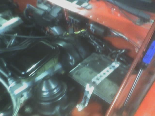

I finally had a chance to get some good pics of my LT1 swap. It is a 93 LT1 w/700R4.

Old Jan 3, 2006 | 10:42 PM
Firebat's Avatar
Joined: May 2005
Posts: 3,786
Hey, that a/c bracket looks familiar.
Your LT1 is looking good.

How did you happen to run the lower heater hose? I was thinking about using the stock metal pipe but it seems my headers will hit it.
Old Jan 4, 2006 | 10:55 AM
TexasLT1's Avatar
Joined: Oct 2000
Posts: 3,819
From: Angleton, TX
Car: '92 RS
I "clearanced" my hard heater line. large vise does wonders for that

Are you running speed density or MAF? I have MAF and want to have the same type of air intake you have.
I just went to the parts store and got some heater hose and ran my own. I didn't use the factory metal hose.
Mine is speed density. The big round piece coming off of the TPI air box is a thick rubber 3 inch connector for stuff like PVC pipe. The top air intake box is off of a V6 Camaro. I took my Intake Air Temperature sensor and extended the wires 4 to 5 inches so it would reach the box. The TPI box doesn't have a provision in it for the sensor but the V6 box had the sensor in the air box. I took the V6 sensor out and put some silicone around the end of the Lt1 IAT and stuck it in the hole and let the silicone dry. It worked perfect. You can see the connector in the box if you look closely in the second picture.
Wow, I have been on hear reading and asking questions and it feels good to have mine done and be able to answer questions for other people.

On the ECU, I went to the parts store and got a strap and drilled one hole and used a factory drilled hole to secure it.
Click the link below for the pic of the ECU mounted.
https://www.thirdgen.org/techbb2/att...2&d=1134701440
