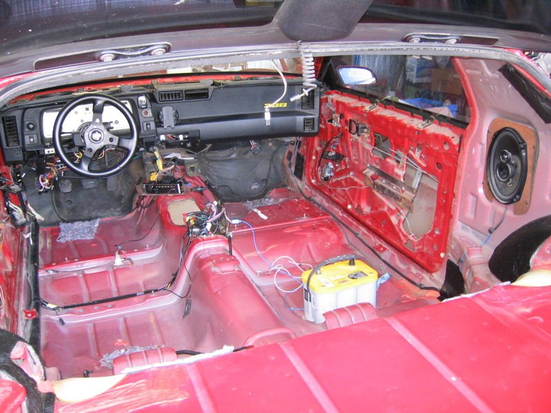

Here is a picture of the hole I cut for my T5 swap
Here is an angle from where I had the car torn down for the LS1 swap
When I put the T-56 in, everything was still fine from my original hole.
As for the actual measurements, sorry I cant help ya, I already put all the interior back in. What I did for the t5 was put the trans up with the shifter off (covered with tape) and cut the hole as needed.
