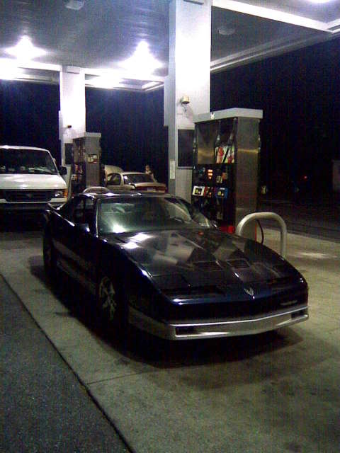

The pictures......are.....self explanitory
Annnnnnnnnnnnnnnnnnnnd........
Ohhhhh yeah
Ok now the words. Came home today and just got to work. Got everything underneith buttoned up including painting the other SFC with Por15. Exhaust is on, cut out hooked up, bolts are tight. I left the front sway bar and air dam off for the project just to make it easier to get under the front. So I installed those.
Got her on the ground, put some air in the tires and fired her up. Decided to just go back and forth for a little. Then upgraded to up and down the driveway. Then over to the storage place which is basically next door. Then I decided I wanted gas...so I had someone follow me to the station. Good thing I went. The tank took 15.6 gallons!!!! I was pretty low its safe to say. On the way back home, I felt the car was doing good so I just kept on driving for alittle. Took a nice cruise around the local reservoir.
She performed without a hitch. Let me say this... I LOVE THE LS7 CLUTCH!!!! Its engaging about an inch off the floor...maybe alittle more. Its very consistant feeling and has an awesome engagment feeling. I can actually let the clutch out and the car will get goin. Its night and day difference from the alum flywheel heavy pedaled spec set up. So far...I love it. Shifts seem good. Alittle notchy, but I suspect that'll clear up. And...while drifting backwards, I can actually put it in first, and start going forward. Couldnt do that before.
Down to the nitty gritty! I have a few little odds and ends to clear up as well as just giving the car a good cleaning. My wipers are still screwy. I might just transfer the entire wiper motor assembly from the 87 to see if I can get it to work. I gotta swap some wires around on the inside. Otherwise she seems good to go!!!! Oh..and in the pics, it was just put down. The suspension needs to settle quite a bit. Thats why it looks alittle upset. If it doesnt settle to where the 87 was, Ill make adjustments as needed.
This is not over. Im going to keep updating it with the work I have left. Ill also include the racetronix harness upgrade...and possibly the pump swap if I get a pump. More pics and videos to come!

Awesome news dude. So glad you drove it. I love my LS7 clutch too. Feels so excellent to drive.
Is that the Turkey Hill? If so, I got gas there once. Loved that gas for some reason

haha... Yup thats the turkey hill. Gas is pretty cheap there. Regular is downt o 3.55...and I think I paid 3.83 for high test.
