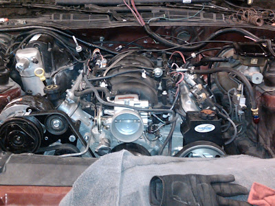

This is an ls1 as well - but another way of doing it. Might not accomplish your goals of reducing clutter though... Just some bent alluminum pipe and a little hose
