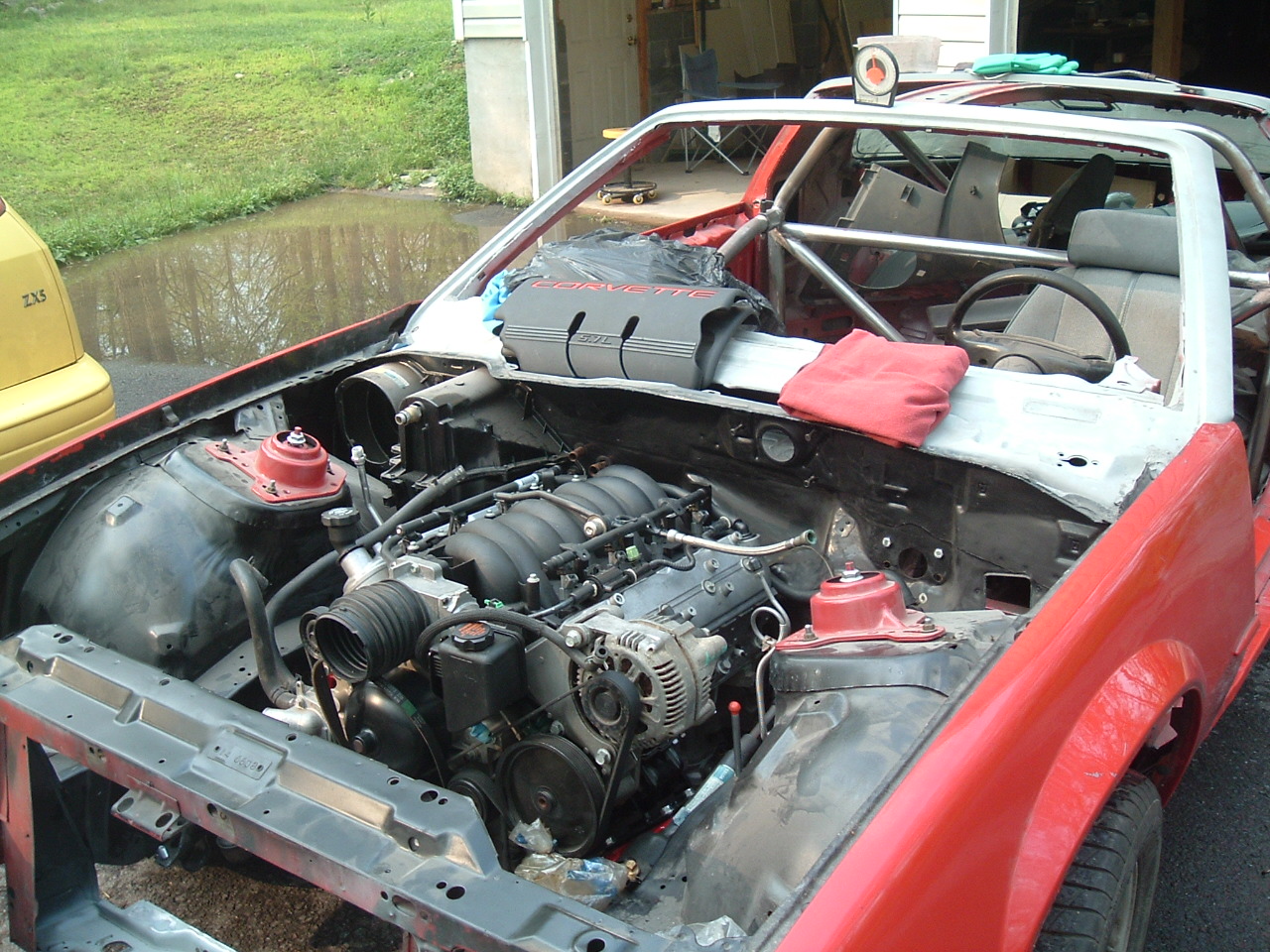

I have the Y-body accessories in my car. The A/C compressor does not fit. I'm using the spohn k-member and the clearence issue is right where the A-Arm bolts to the K-member. So I have to assume that you would have the same issue with the stock kmember. The Ybody compressor sits further back then the f-body compressor. I bought an f-body bracket and compressor but the pully didn't line up with the Y-body balancer.
At this point if i decide that i want to put the A/C in i will have to get an aftermarket bracket or just switch to the F-body accessories.

I did not use the vette rack and pinion if thats what your referring too. But i had no clearance issues with my stock steering linkage. Really i think the only difference between the Y and F accessories is the alternator. The water pump and power steering pump are in the same places from what i can tell. They might just sit a little closer to the engine like the a/c compressor did.
Here's two pictures that i have.
Attached Thumbnails Corvette AC bracket-img00222.jpg   Corvette AC bracket-dscf1335.jpg

No I was not referring to the Y body rack and pinion. Somebody had commented on another thread that using an LS1 with Y body accessories, that the powersteering pump might come too close to the 3rd Gen steering column or rack. It looks like you didn't have any problems.
Please confirm.
You install looks great...you haven't hooked up the AC yet right?
Looks like your fuel rail cross over tube got bent. Not sure I could live with that considering it feeds the whole other side of the motor.

Now that i think of it something did come in contact with the plastic cover that is over top of the steering shaft. But since the cover doesn't spin and it wasn't pushing into the steering shaft we left it be.
I'm not sure that the fuel rail is bent. I just googled corvette ls1 and i could see that they are bent on those too. But my pics do make the bend look pretty dramatic. I'll have to check it out and make sure it's ok...
