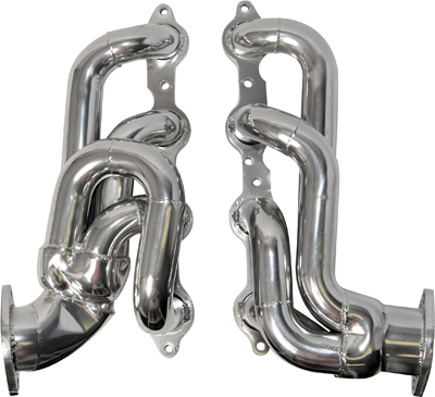

Well, found these, looks like they are close to the 8012 big block headers that have been made to fit by booboosean in his car, but the LS has some extra room, so i think these might work better, mid length, 1 3/4 primary and 3 inch collector:
http://cgi.ebay.com/ebaymotors/Hedma...Q5fAccessories
Looks good for the automatic guys and the fellas like me that dont wanna spend 800$ on hawks...

These are 300$ and for the 2010 camaro, but i think they wouldnt be much better thna manifolds, 1 3/4 primary but doesnt list the collector, looks like 2.5:

Has anyone ever tried GTO headers?, they look almost identical to the hawks LSX swap headers. These ones are only $250
http://www.byunspeed.com/product_inf...oducts_id=6872

Those GTO headers look promising...

If GTO headers are anything like their manifolds, it might not be so nice
http://www.ls1tech.com/forums/conver...asurments.html
Check how far it kicks out on the pass side. We have from right there

Those BBC Headers look close!! New flanges welded on and you got Big tube LS swap headers!!! Even can get them ceramic coated!
Come on, they are 500$ and the set to make them work is 200$ or so, so you are 100$ shy of Hawks.
Thats hwy i am going to use the Patriot 8013 BBC header, not made for our swap but they fit with minimal mods and should fit better on a SBC LS platform, the 8012 has been used and is a 1 3/4 so i will be using the 1 7/8 8013.
For $100 less and a better header why the hell not? how far off are the port locations anyways? From a BBC-LS1 I mean.
Refer to this:
Originally Posted by Pocket
Do a search on them. The fit like poo, strange for hookers
The ports are WAY off but hacking them is an option, the big block head is allot longer than a LS or SBC so there is a big difference.

these actually look reasonably close to the hawks ones. need measurements though. pacesetters
They so look pretty close, makes you wonder.

I think he meant using 4th Gen LS1 headers. From what I've been told, fitament is so bad with 4th gen long tube headers that it's impossible to get them into a 3rd gen without major modification. That seems to be why most people either buy hawks, or modify 3rd gen specific headers to weld up to a LS1 flange. I'm certain there is another header that will fit, the question is...which one?
The GTO headers look closer than 4th gen headers, and even some of the truck style long tubes looked halfway decent. I'm betting the majority of them hit the K member on the 3rd gen right where the #2 cylinder pipe goes down on the passenger side.

Re: LS headers, anyone wanna try?
They also flare out to the sides right where 3rd gens have frame

those collectors on the shorties look like a power robber to me, but have a chance at fitting.
steer clear from the hooker big block headers. they willl beed modification out the wazoo to fit, IMO.
a ls and small block head flange is vertical, the big block is layed over a few degrees.
with the headers barely fitting correctly on a bbc, i can see problems when trying to rotate the header some.
ive had a set of gto headers from kooks in my hands, and they appear to be worth a try. i wasnt going to pull all my exhaust to fit, but it looked promising.
tbss headers may be an option as well., but i dont think the collector tucks in enough to clear the frame.
the collector is a good ways away from the shifter linkage. prolly get into the frame unless you mod them.

I have the Hawks (stainless works) 1.75 inch longtubes (2.5" collectors) on my car and they fit perfectly with the 4L60E, O2s and everything. The issues surrounding these headers were created by the chinese knockoff 1 5/8" headers with 3" collectors (the ones from the $599 group purchase.) I tried two sets of the knockoffs and they didn't fit. The next set I got were the SW ones and they fit great...frustrating to say the least.
I guess you get what you pay for.
