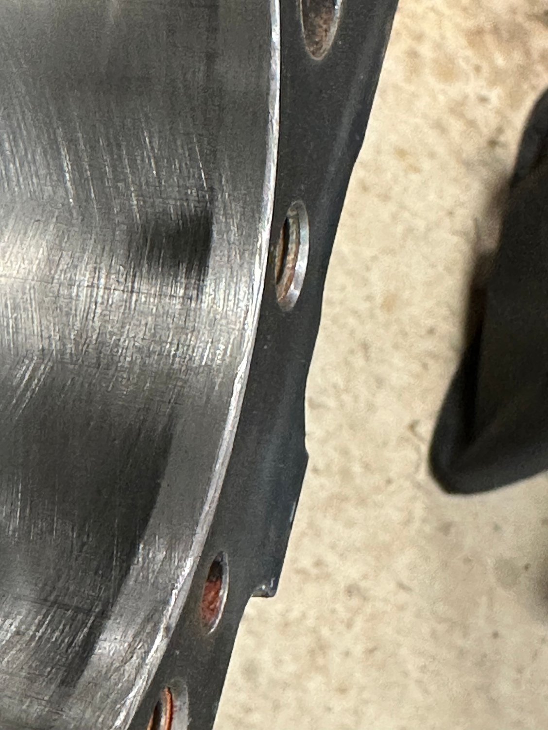

See those dark marks in the cylinder bores adjacent to the bolt holes?
I machined this block with arp head bolts and torque plate honed it, after using the bolts for honing, mock up and assembly the bolts failed and I changed to head studs and they required more torque and ran the motor on the run stand. Needless to say the head studs were problematic and leaking so I pulled the heads changed the head gaskets and switched back ARP bolts and discovered the dark spots and it’s definitely attributed to distortion under torque. Some was my problem because I switched to studs after honing, moral of the story torque plate honing with same fasteners is a must and proves the fact that doing honing without them on a stock block anything will have the same results.
Re: Did your machine shop use torque plates?
Tom, thank you for your pictures and description of what happened. I'm old school and even almost 40 yrs ago I knew that torque plates were a must for proper honing. I wouldn't use a machine shop that didn't use torque plates.
