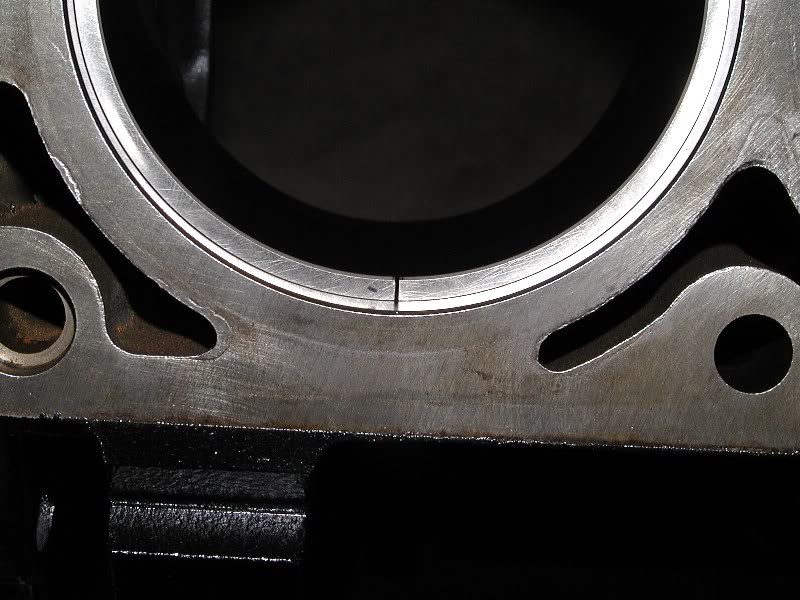

Impossible to see in this pic, but the cylinder bores still show their crosshatch pattern, and have no ridge at the top of the wall:

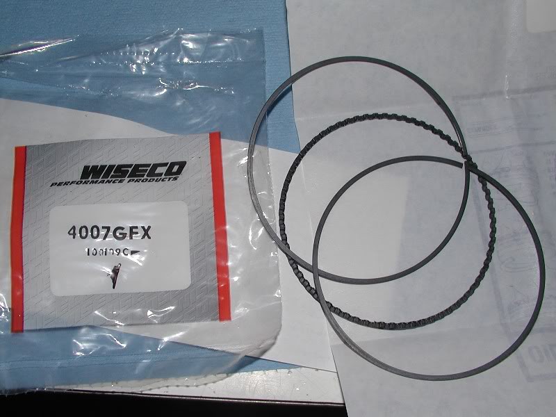

Also in the box was all the bearings, wrist pins, rings and a set of ARP head bolts.
I must say though... I was very disappointed to see "Made in TAIWAN" on the wrist pin packaging.

Got the last 4 rings filed last night. Yay. Now I just need to verify clearances on the oil rings and I'm done with rings.
BTW, here is a pic of what a 19 thousands gap looks like:
Also, one of my packs of rings was differnet than the other 7. The first and second rings look the same, but the oil rings and the spacer ring look slightly different. I've got to email TSP and find out what the deal is. I would assume that these rings really don't play as crutial of a role as the top two, so I doubt it's a problem. Just odd.

Minor update. Last night I started checking the gap on the oil rings. The specifications that came with the rings only said that they need to be 10 thousands or greater. Most measured between 13 and 22 thousands (there's some consistency :-/), but the set that came in the "oddball" package measured greater than 35 thousands. I'm not sure how I feel about that...
Old Jul 22, 2010 | 09:56 AM
five7kid's Avatar
iTrader: (14)
Joined: Mar 2000
Posts: 43,187
Likes: 46
From: Littleton, CO USA
Car: 82 Berlinetta/57 Bel Air
Transmission: 4L80E/4L80E
Axle/Gears: 12B-3.73/9"-3.89
Personally, I wouldn't install the oddball set.
