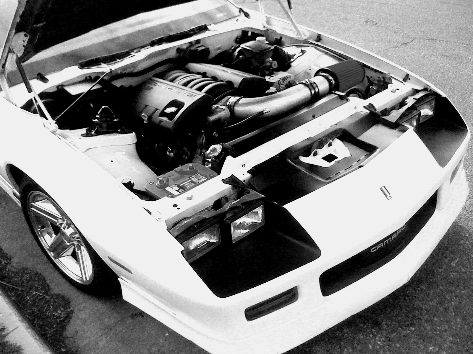

pedals installed and some pics with the rail cover installed also.
pic from a camera phone crappy quality

(gotta get a better camera, taking my pics with a camera phone and not as good quality)
quick update:
1. had the aluminum driveshaft cut an balanced(car been lowered quiet a bit its was pushing the yoke too far into the trans)
2. swap out the fuel pump for a high-flo walbro pump
3.not to sure if this matter or not, but on installation of the ecu(putting it in the same location as the stock tpi ecu, under the dash/passenger side)
i figured i replace the heater core i wasnt too sure if there might have been any deposits or anything left from the old tpi engine, and i didnt want it to circulate into the new engine so went ahead and change it.
4.starting on the wiring.

1. the dbw throttle, the wire were routed using the exsiting hole were the the previous throttle cable came threw for the tpi engine.
2. nothing to do with the swap, but i took some pics of the 2011 ZR1. dont see to many of these running around and the just happened to haveone at the chevrolt dealership.

but heres some updates
-need help with exhaust went to my buddies
-powersteering not tohappy with but will change later
-went with black fitting and black nylon fuel lines not to crazy about stell braided or red/blue fitting
-crappy pics from iphone agian will get better camera once it all cleaned up and complete
-the upper radiator hose fits perfect for later style ls water pumps with the water neck on the driver side(2007-earlier have water neck more towards passanger side) hose is a gates

For my LT1 swap, I cut out a hole in the driver's side battery tray, and I am bolting an aluminum plate with a 3.5" tube welded onto it, and I am running the filter right underneath the battery tray so it'll get cooler air than what's in the engine bay.
I got an Air Force aluminum throttle body elbow off ebay for like $49 (this is the cheapest aluminum elbow I could find) and just bought the aluminum intake tubing separately. I'm using a silicone coupler on the tube on the battery tray plate, so I can adjust the small 45 degree elbow that will be fastened onto it, so the intake tube from the throttle body will mesh with it, then I'll just tighten it down and voila!!
It should work very nicely. Wish I had a pic of it all completed, but my engine still isn't built yet. Here's a pic of my foamboard template for the aluminum battery tray plate and then another pic of my original idea with the smaller plate with tube. I decided to go with a bigger plate that will hide all the holes in the battery tray and will look cleaner:

Originally Posted by JSACRA
what do u guys reccommend for a cold air intake set up. dont want to use the old tpi air box (too restritive).
