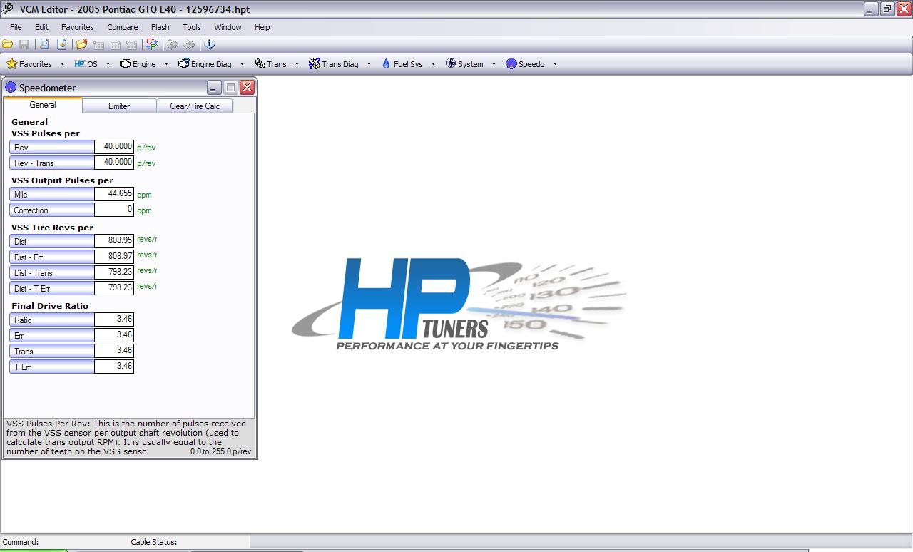

Yes, I'm aware I need 4,000 ppm to speedo. Just not sure if its configured correctly. Here are two shots of both tabs in Hp.
Haven't wired the tach, yet. OEM GM weatherstripping finally arriving tomorrow. Will spend most of my time sealing everything up this week. Body & paint will be completely finished . Runs great - just don't know how fast I'm going - I'm sure the officer will believe that .
Anyway, I'm trying to get it working so I can show it off at the Midwest F-body track day @ Road America, May 4th. Won't be ready for on-track, but I can show it off.
Eventually, I believe that I'll have to wire in the boxes to get cruise control working with the DBW. For now, I just need it sealed up and to know how fast I'm going.
Brian
Attached Thumbnails 89 Formula - Speed & Tach-speedo.jpg   89 Formula - Speed & Tach-tiretab.jpg

Originally Posted by five7kid
The output from the PCM to the speedometer should be 4000 pulses per mile.
You should be able to use the Gear/Tire Calc tab get the output correct.
Here is a sample file for a Camaro. Appears to be what you guys are used to.
Here is a sample file of PCM E40 from GTO. Very close to what I'm seeing.
The E40 is certainly different! But I should still be able to program through HP Tuners to get the speedo where I want it.
Attached Thumbnails 89 Formula - Speed & Tach-camarosample.jpg   89 Formula - Speed & Tach-e40sample.jpg

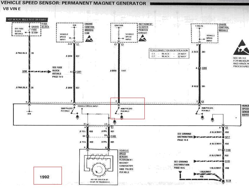

wired the boxes in, have switched power. Tach doesn't budge, speedo has erratic readings in park.
Originally Posted by Jay
The two-pulse (2000 pulses per mile) square wave (D.C. current or direct current) used on all TBI engines through 1992, all computer-controlled-carbureted engines, and on 1985–1989 TPI engines.
A four-pulse (4000 pulses per mile) sine-wave (A.C. current or alternating current) signal is required by the 1990–1992 TPI, 1992–1993 LT1 engines, and 1990–1993 Camaro 3.1/3.4 V6 engines.
A 40 pulse per driveshaft revolution speed sensor used on 1993 and newer trucks with automatic transmission, 1994 and newer rear drive cars (Camaro, Corvette, and Caprice) with the automatic transmission.
Maybe my speedo readings are off because I should be using a 2000 ppm?

I believe that's accurate, and I need the Dakota for the speedo. They gave me some options to try and that filter for a "dirty" signal (not time for that, tomorrow).
Pocket posted this '92 Buffer diagram, but Jay said that '89 is 2000ppm for the speedo gauge. I'll try that, tomorrow - anyone have an '89 diagram to confirm?

These are from my ’06 GTO manual:
Maybe I misunderstand or maybe these help.
