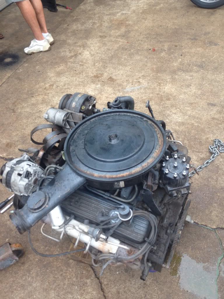

Tear down and removal...

Engine and trans out...anyone need a solid 305 and 700r4??? lol

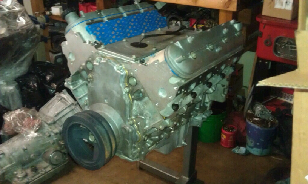

The engine is almost complete. The plan was to just do an ls1 with the LS Hot Cam, 317 heads/LS2 intake. I bought the motor minus the intake and oil pan from a 98 C5 vette for 750 bucks on craigslist. We tore it down and there was no issues with it. Sent it off to the machine shop with a customers short block from his 04 zo6. My engine build was supposed to be ls1 block, lq9 rods, forged mahle pistons. Well the machine shop mistakenly swapped blocks and machined the LS6 block for my pistons. Told the customer what happened and he was cool with it. He was going to have it rebuilt to sell anyway because we are building an iron block 408 for his car. I paid for both of our machining, let him have my LS1 block as well as bought the lq9 block for his build in exchange for his LS6 block.
Still waiting on a few parts but it should be put together and ready to go in tomorrow. LS6 block, LS1 crank, LQ9 rods, forged mahle LS2 pistons, arp hardware, IWIS timing chain kit, 317 6.0 truck heads milled (same specs as a 243 head) and polished the ports up a little bit, stock 6.0 truck valves, ls3 springs, comp 217/226 @ .575 lift 114 lsa cam. PICS:

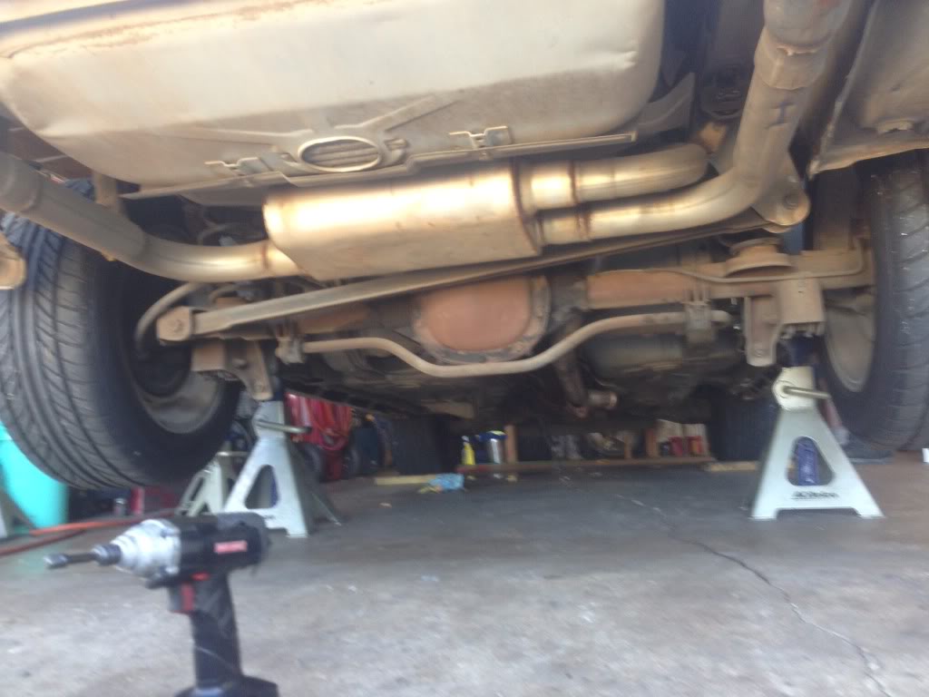

Pulled the exhaust, dropped the tank....12 gallons of bad gas and a rusted out fuel pump and fuel sender later...I figures i needs a new gas tank. I'll be running braided steel fuel line, walbro 255 in tank pump and C5 corvette fuel filter

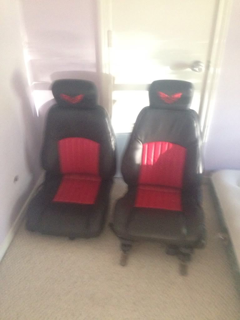

New interior; 2001 Trans Am Seats custom upholstery. These seats are built buy a guy I know in Florida. This package was $1100 shipped. I know that sounds expensive BUT this is what you get. You get front and rear seats with new foam, seat tracks are cleaned and greased, new switches, motors, and wiring for electric seats and last but not least great quality leather upholstery. Obviously the more custom you want it, the more you are going to pay. Unfortunately for me, my order came in wrong after I deployed so He has agreed to wait until I get back home to rectify it. It was supposed to be black leather with red inserts and red baseball stitching for all of the seams w/out the firebirds in the headrests. Needless to say I got firebirds in the headrests and o baseball stitching. Most likely I will settle for a refund on the cost of the stitching and I will remove the headrest covers and swap them with the blank ones he sends me. still for the price it's awesome. PM me if you want his info. PICS:

Car is now back on the street. Finishing up wiring the 4th gen cruise, 4th gen t/a seats, and other interior items. Wash, clay bar, wax, buff, and carpet shampoo. First time the car had this treatment since 2008 and the carpet for 23 years old looks new now. See pics. Will take more in better light.

Texas Two-step: My ls6/hybrid swap-image-3750565353.jpg

The exhaust is hawks lsx swap kit. Long tubes and off road y pipe into 3rd gen borla cat back. Pics of engine bay below.
Attachment 272789
Attachment 272790
How did you set up your heater hoses? Looks like the heater core is hooked directly up to the water pump but its hard to tell in the pic.

They are stock 3rd gen heater hoses and are hooked directly to the water pump
