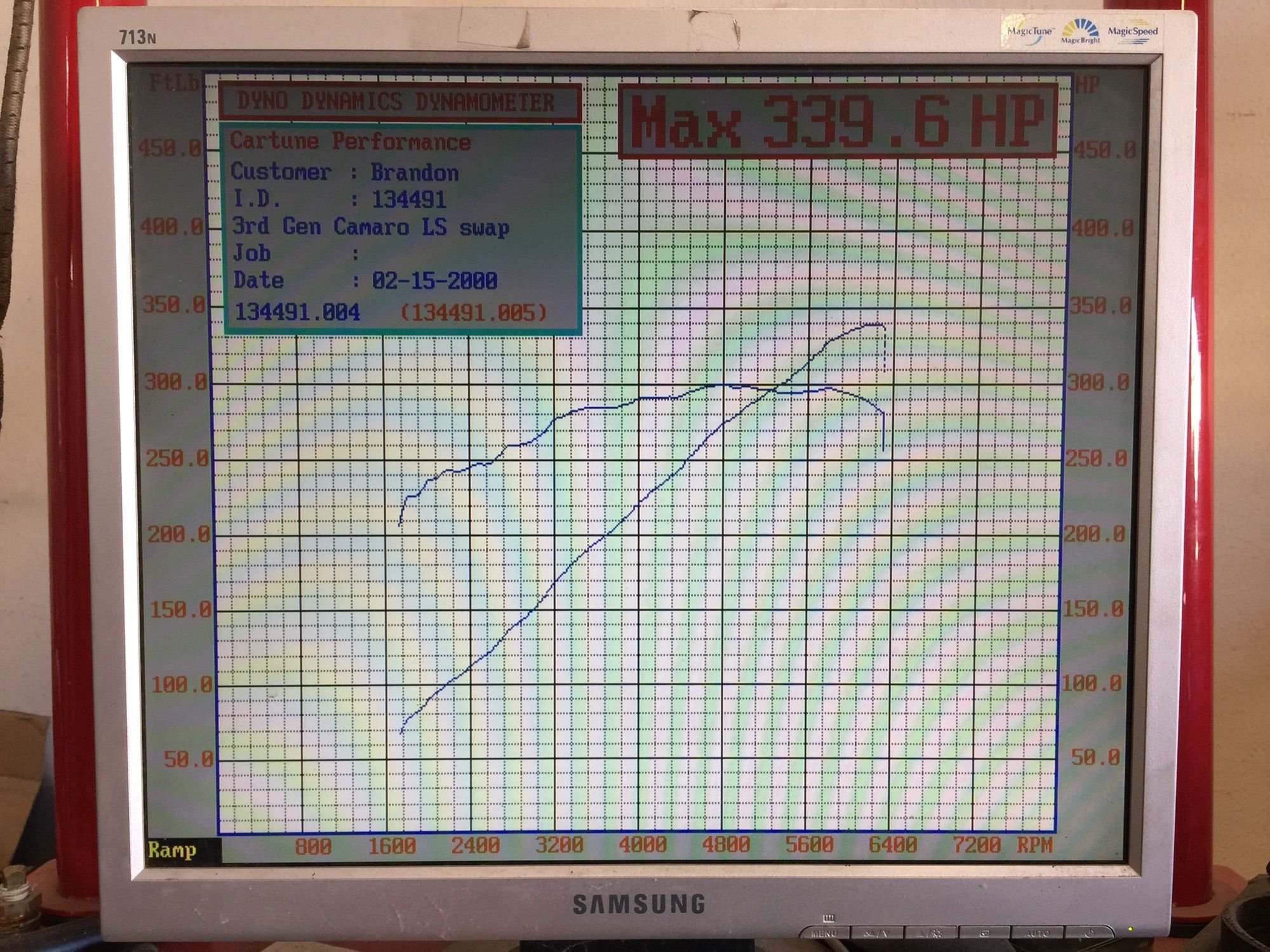

Old Sep 9, 2015 | 03:00 PM
  #171
R13_Braz's Avatar
Joined: Dec 2014
Posts: 431
From: Garland, TX
Car: 2014 Z28 #80
Re: 92 RS 25th Ann. Edition 4.8/T56 build thread
Small update:
Car is still running strong. I'm half-tempted to pop the valve covers off and tighten the rockers up just a little more to see if it lessens the noise a bit. But, I'm only half-tempted. However, even in it's untuned, pedal-to-the-metal state with lots of redline pulls I still got 17 mpg out of my last tank!
Can't seem to get someone with a camera to follow me. Dyno in 2 days!!! So, hopefully this weekend afterward!

Well, results are in.
Kinda disappointed, but it's still not THAT shabby.
340 RWHP and a little over 300 ft/lb's torque. Fuel issue at about 5.5k rpm though, so if I can get that figured out we can retune it and probably up the numbers some more. He had to set the redline at 6.3k because the flow wasn't enough. But, going to make a new thread in regard to that.
Fuel economy is way up, idle is perfect, he got the speedo dead on and the tach is only about 100 rpm off, which isn't bad. His exact words when I went to pick it up were: "She's a screamer. You've got yourself a fast b**** there!" lol. He seemed impressed with it, so I guess that's something right?
They are going to email me the video they took as well as the log sheet with the numbers, so I'll post them once I've got them.

Here's the screenshot in the meantime:
Lots of room for improvement. There's a dyno-day next month so I'm going to get a "second opinion" on the numbers.

Originally Posted by R13_Braz
Going to upload the vid to youtube later when I get home.
I bet you're making more than 340 WHP. What cam do you have in this new engine again?

Comp XR281HR
The fuel drop off is an issue though. Should be able to make power to 7200 rpm. Going to get a fuel pressure testing kit w/gauge and check the rail pressure at idle, and while driving, to start my diag. This Walbro 255 should have more than sufficient flow for under 500 hp...
Comp XR281HR
Are you still running the stock intank pump and hard line? A warlboro 255 should be good for supporting your engine.
Nope. Walbro 255 in-tank with 3/8 SSB fuel line/an-6 fittings front to back, feeding into a vette filter/reg. Racetronix hot wire kit with relay and power wire feed directly off the alternator. Same as most people that do this setup.
The tuner claimed that at 56-5700 rpm, when he commanded an additional 5% fuel, he said it couldn't do it even though the injector duty cycle wasn't close to being maxed out. He didn't give me hard numbers, and I don't have the software to check it myself currently. His words were: "the Walbro 255 is antiquated technology", yet couldn't offer up a viable replacement.
It's entirely possible that there's a hang up somewhere, or maybe possible vaporlock with it passing near the d/s header... but that doesn't explain why it has issues after a certain rpm range, especially since there is decent airflow. Need to get that gauge so I can take a look at the pressure.

There is no fuel drop off. I have described what I did to test it in the other thread, but
TL : DR Pressure never goes below 58, no matter what the conditions. Sits at 60-62 normally.
Only thing I can think of at this point is the injectors aren't meaty enough, since they are stock 28.8's. Going to hold off on any more purchasing until I can get it on another dyno to see what happens, which should be early next month. In the mean time, going to continue to drive it and EVENTUALLY knuckle down and fix the fuel pump relay problem.
Next test'n'tune/fast Friday at my nearest 1/4 mile track is in November... specifically, 11/14. It's domestic vs import night, so my brother with his Subaru is going to go out with me and we're going to see what kind of times I get now compared to my stock engine/trans. I prefer 1/4 over 1/8, but I may give the 8's a try since they do TNT more often and I could use the practice going down the track.

HP Tuners Pro ordered. Stepping off into the land of the unknown (for me) with this one, but if I'm to do everything myself then this is the next big step... and one that I want and need to make. Super excited to start really learning the intricacies!
Also, I know I said a ways back that I was keeping track of my expenditures, and making a list of all that I bought seeing as that was one of the things most people are curious about, but very few modders actually take the time to put together. I'm still missing some things on mine, since I was forced to redo the whole engine again, but all in all this is pretty close. I'm going to go back and edit the first post so that people won't have to go through 4 pages just to find this link if they need it.
I've set it to view all, so if it's not working please let me know.
https://docs.google.com/spreadsheets...it?usp=sharing
I've got it organized by group, and I have it automatically calculating my cost of parts vs what I've sold to offset.
That's not too far off of what I've spent on my swap so far. I haven't been keeping track lately, but last time I checked I was in the $6K range and I've purchased a good amount of more parts.
