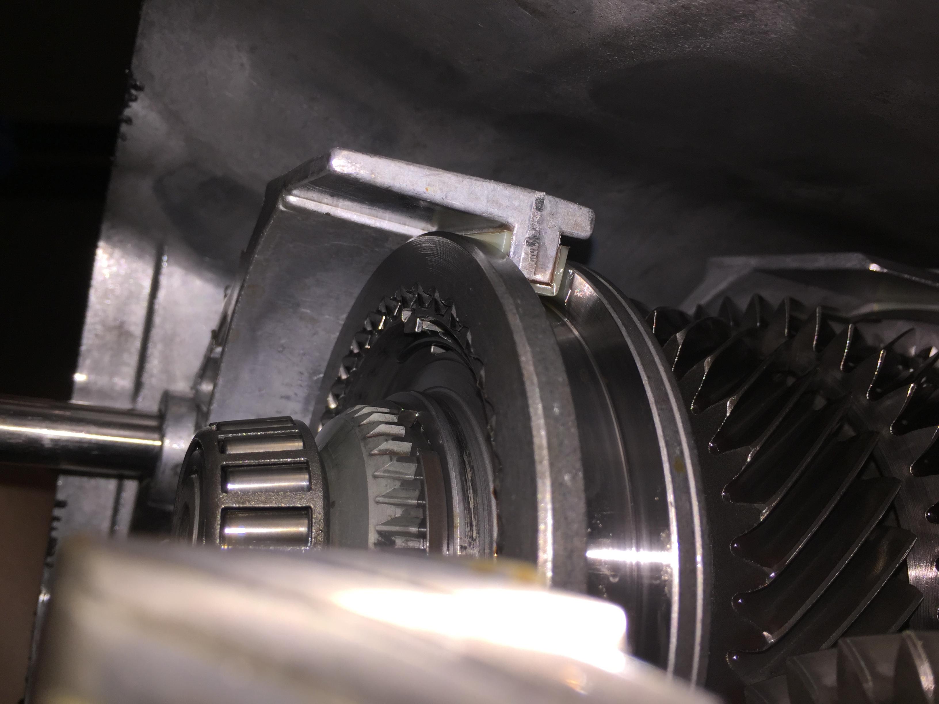

Pulled the trans off to reveal a stock clutch and something leaking. Doesn't smell horrible and lots of fluid behind the flywheel on the block so I'm guessing it's the rear main/timing cover. Clutch looks like the stock LUK, but has defintely been replaced and still has some meat on it. I'm guessing it is the LS6 version since they stopped making the LS1 long ago, but haven't confirmed anything via part numbers yet. The LS7 version has a dish on the flywheel which this one does not seem to have, so I don't think it is that one.

A LS6 clutch is a lot nicer piece than the LS1 clutch. If you replace it, I would go with the LS7 clutch.
A leaking slave cylinder can throw brake/clutch fluid in really weird places so check that as well. I would replace it anyways. I dont like slave cylinders.
And when/if you replace the rear main seal and the rear main seal cover piece gasket, look up the instructions for the gasket. The gasket does not have any material between the oil pan, and the bottom of the rear main cover. You have to RTV the bottom of the rear main seal cover, or else it will leak. Also, pay close attention to installing that rear main seal. Treat it like gold. And MAKE SURE you install it the correct way. Fly wheel side towards fly wheel. If not, that sucker will be puking oil everywhere once you start the car.
All are simple things to over look when wrenching on a car late at night for hours and hours, and step one to fixing any of those issues, is pulling the trans. Ask me how I know.

If upgrading, I second the LS7 clutch. I grabbed a set used from a member here with the aluminum flywheel and I'm very happy with it, for now. I'll have to change it out later to one that can handle boosted HP, but the action on this one is great. I also second the slave cylinder... I got mine from O'reilly and no issues with it so far. And it's pretty affordable. I just changed out the fittings to work with the Russel clutch line and stock 3rd gen M/C.
As for the rear cover, I'd suggest doing what I did and just buying the complete unit.. it's only $30-something for it complete. Didn't have to deal with removing and installing the seal, just bolted it on.

Thanks dude. I think I remember hearing that story, will probably just pick up the whole plate. Going to re seal this beast and do slave/TO bearing and a tick stage 2 at the very least. Clutch upgrade is probably last on the list but also one of the last things I have to do. Blew my load on the swap so it is all waiting on fundage from here on out. Plenty to do and think about so no worries tho.
You can just use the Vette clutch/pressure plate/ and flywheel with the LS1 slave and TO bearing right? Or is there a specific application of LS7 you need to use with the LS1? I have pedals and the LS1 master cylinder so no worries there, but I do hear the earlier M.cylinders kinda suck.
Dorman 635-518 for the rear plate right? Then just have to RTV the bottom and bolt it on?

Yes to both questions. I just bolted mine right up, and used LS1 hydraulics (except for the 3rd gen master). Also, yes on the rear plate.

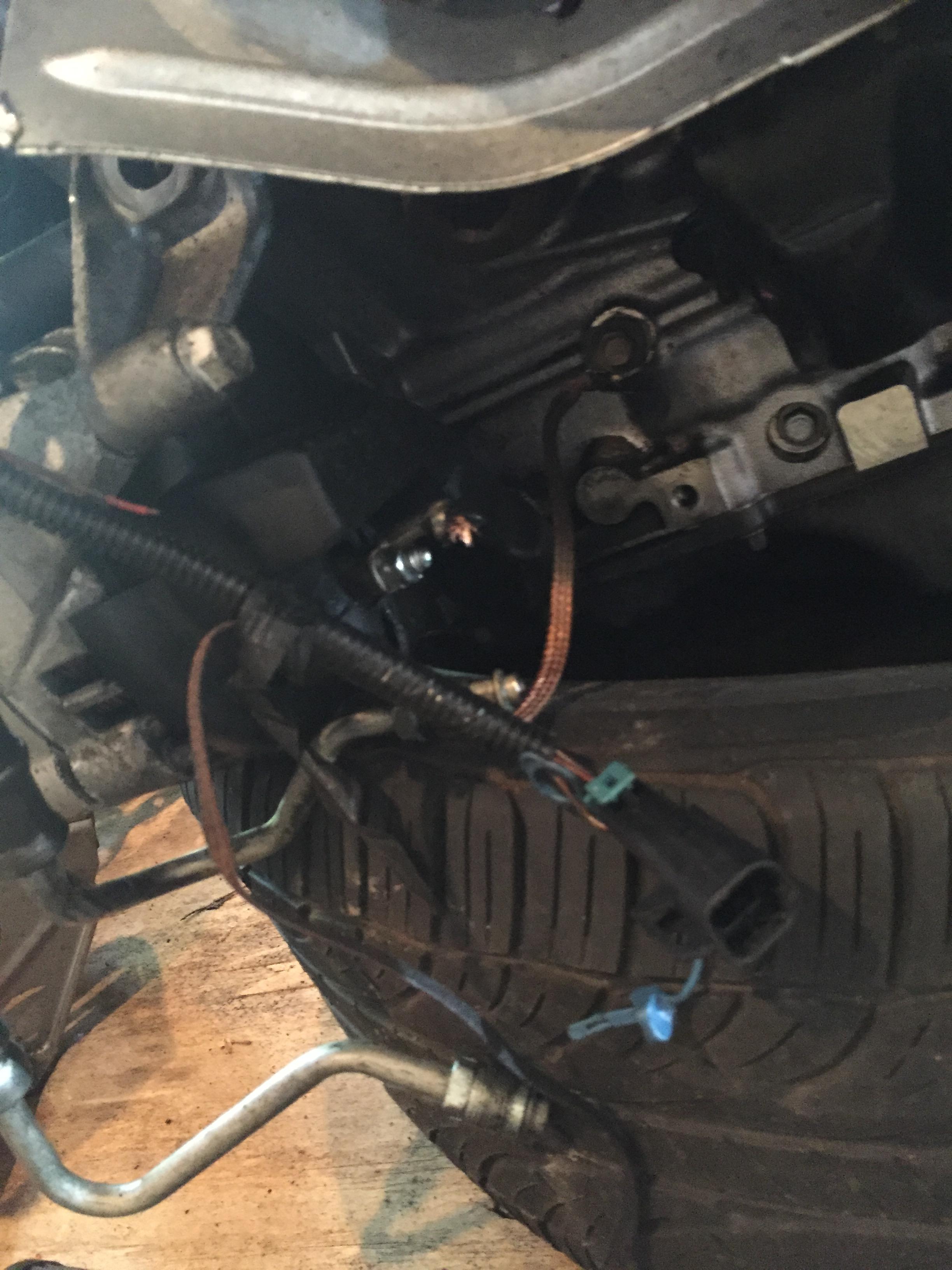

Are these two wires for the AC switch? They are cut right by where the wiring for injector 7 comes off. Should there be any other AC wiring in the harness? AC was removed from the car and I don't see plugs anywhere. They removed EGR but left the plug tho.

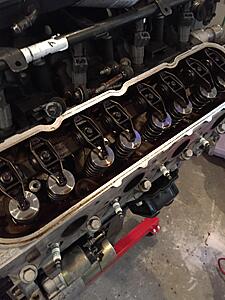

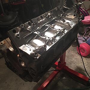

Still taking it slow. Couldn't fit the flywheel to compression test with the starter so I started pulling it apart. Just got the intake and valve covers off to see what is in there.
Everything looks pretty clean up top. I was told the cam was put in 5k ago and looks about right.

I was told it had hardened push rods in it. But these defininately look stock to me. Can anyone confirm? No markings at all.
Stock valves as well it looks like?

Re: New to this Section- First LS Swap
Those do look like stock pushrods. Not sure on the valves.
I'd like to strongly suggest you get the Comp trunion upgrade kit. Have a machine shop soda-blast the rockers, install the kit and be content knowing that you eliminated a potential failure point. Really easy to do, especially with that press you bought. Took me about 1.5 hours to do all 16 with my press.
Yes, on the list now that I know it hasn't been done along with LS7 lifters/new trays and apparently hardened push rods now as well

That is your AC compressor clutch wire that got snipped
Alt is easy and often breaks. Single 20ga red wire to the B terminal
Those might be the crank sensor wires. Check colors to confirm: Yel/blk, LT GRN, DK BLU/WHT. Most important sensor in the whole harness. On the bright side you can use a common MAF sensor connector from any 90's GM car to replace it

Hey he's back! Thanks, Pocket that helps a lot. And I think you are right, it looks like just a cam kit, and I'm pretty sure it has been in there more than 5k. Heads had been pulled, it had Victor Reinz gaskets on, but they looked pretty beat. Head bolt heads were browned but not really baked with oil like the pushrods. I will clean up the "crank sensor" wires and make sure that is them. It looks like they put a new plug on it but grabbed some random connectors to connect it. Cam lobes look ok, but I'm going to pull it and inspect the bearings and put new lifters in. Also will be re ringing/scoring the walls and checking, most likely replacing the mains.
Not much progress this weekend, pulled the trans apart and it looks like it has had a rebuild but just stock. Trans was really dry as was the engine. I guess the guy drained them before I picked it up. Looks clean inside not a lot of metal on the magnets, but who knows how long ago it was apart. Getting a stage to tick kit and the Viper 2nd gear for sure now. Had to re set the engine on the stand to pull the oil pan. Rear timing cover had one of the long bolts broke off in it, so I definitely need the Dorman one now since I decided to cut it to pull it off... Ran out of time to pull the balancer, front cover, and oil pan tho.

Had the week off last week and instead of assembly I decided the block was aluminum and it could be polished. And of course it could.. but now I have to do the other side, heads, t cover, brackets etc.. I just set my build back at least a month lol.

Not much progress. Got the cast sanded off of the other side of the block, should be polished up next weekend and hopefully start porting the heads or polishing the WP/brackets etc.. I've decided I need to get that done before I start assembly so I can clean everything up good as it makes a huge mess.
Bunch of parts showed up. A cam came from Vengeance but it wasn't the right one.. still waiting to hear back from them.
