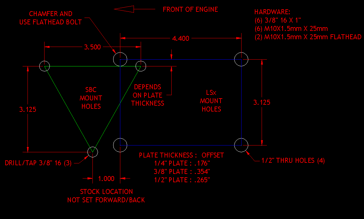

1) There are two main types of mounts that can be used for a LSx conversion into a 3rd gen. The first uses adapter plates and the SBC K-member mounts and engine clamshells. Basically any plate that looks like this will work regardless of brand or home-fab
The second are the hawks/spohn frame stands that utilize 4th gen LS1 engine mounts. The frame stands bolt to the K-member in the V6 rearward position. They are also known to sag slightly on the pass side
2) Yes to both. Beware 700R4, T5, 4L60E and T56 TA mounts are all different, so grab the matching piece or fab something
