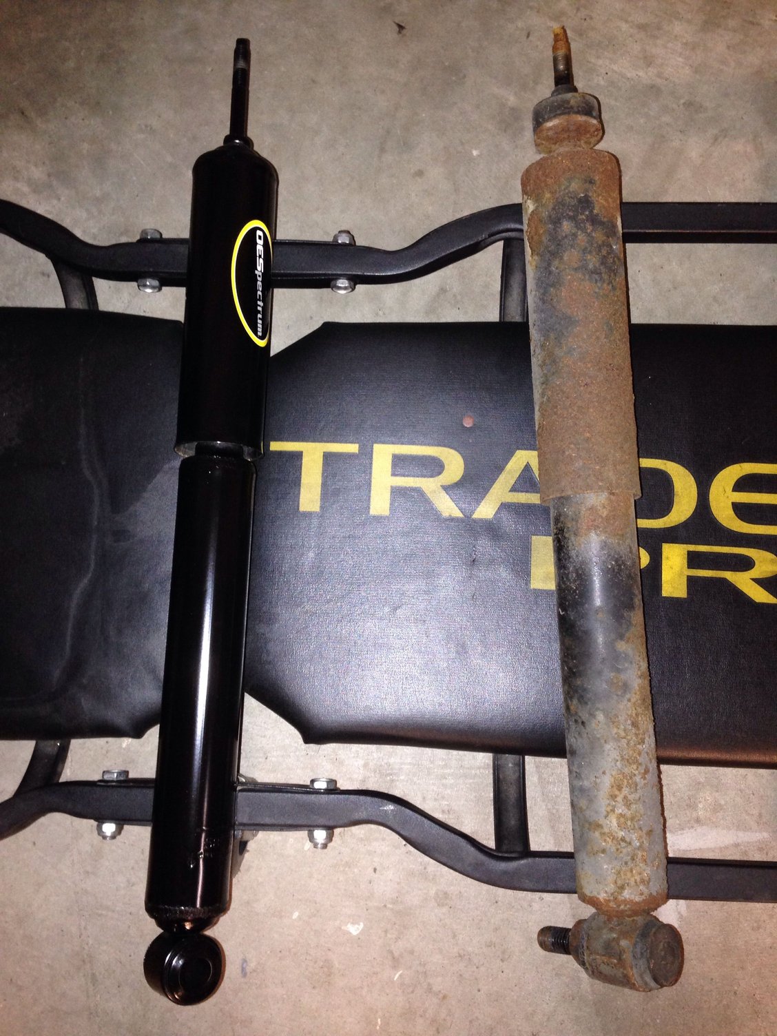

Got a little done last night. Replaced the rear shocks while I was working on the rear end. These old things were in bad shape. Definitely the original ones from the factory.
I also ordered the eibach sport lines and they should be here Saturday. Should be it for the suspension for now once those are installed.

Re: 91 Z28 LS1/4l60E swap.....Finally
Forgot ton attach a pic of the nasty shocks...
