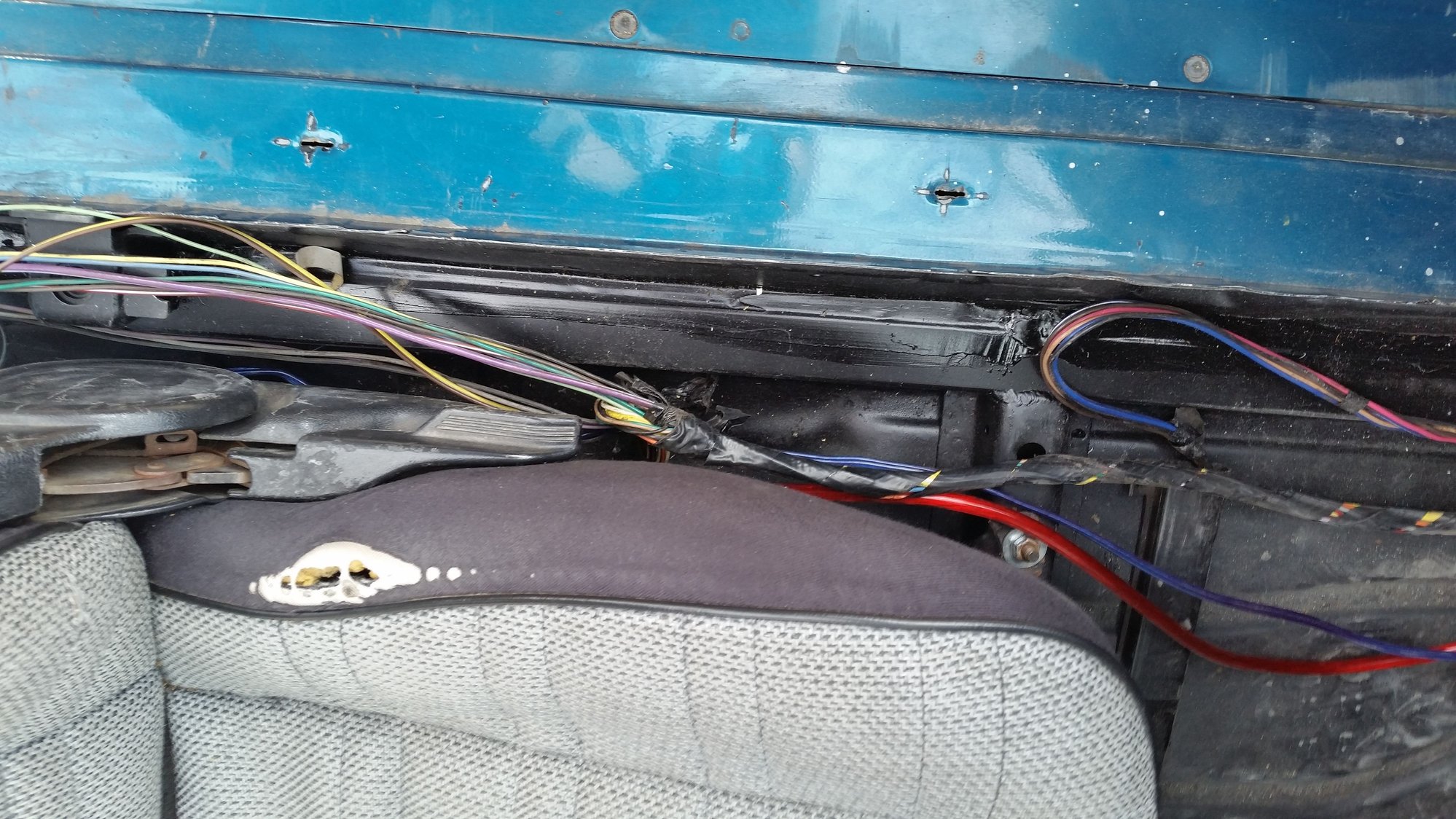

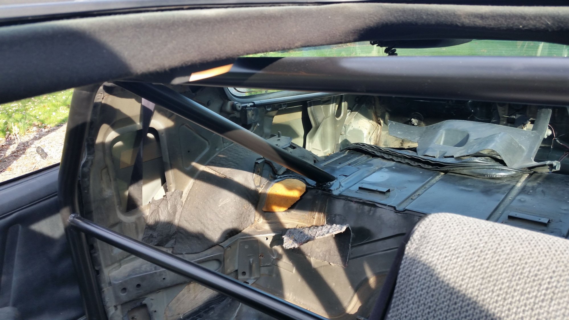

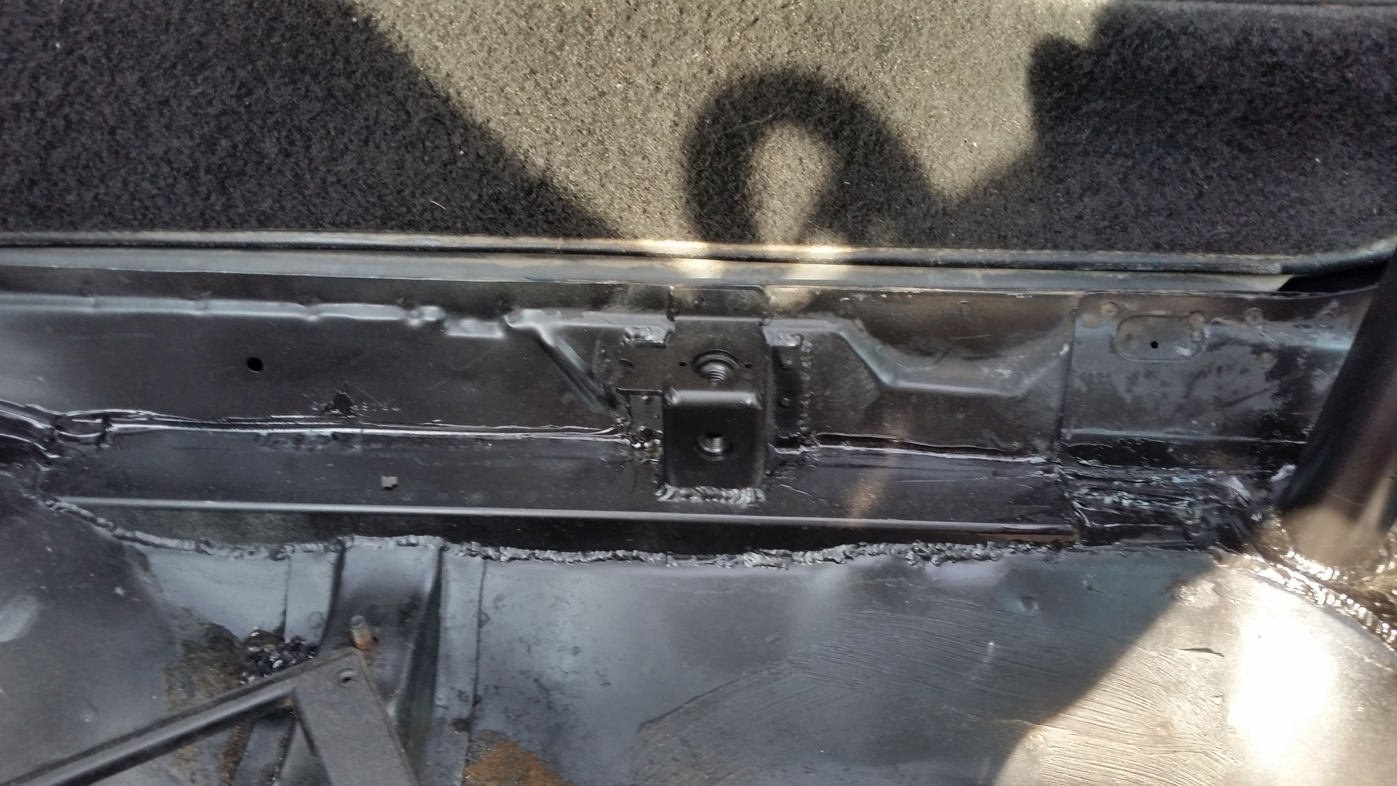

I also installed the Detroit Speed subframe connectors and I am very happy with them. They make the car 100 times easier to jack up and they make great resting spots for the jack stands. The subframe connectors also replace the factory seatbelt bracket and allow for easy installation of a racing harness. If you are planning on installing subframe connectors, I would highly recommend going with the DSE ones. The install was pretty invasive but was totally worth it.

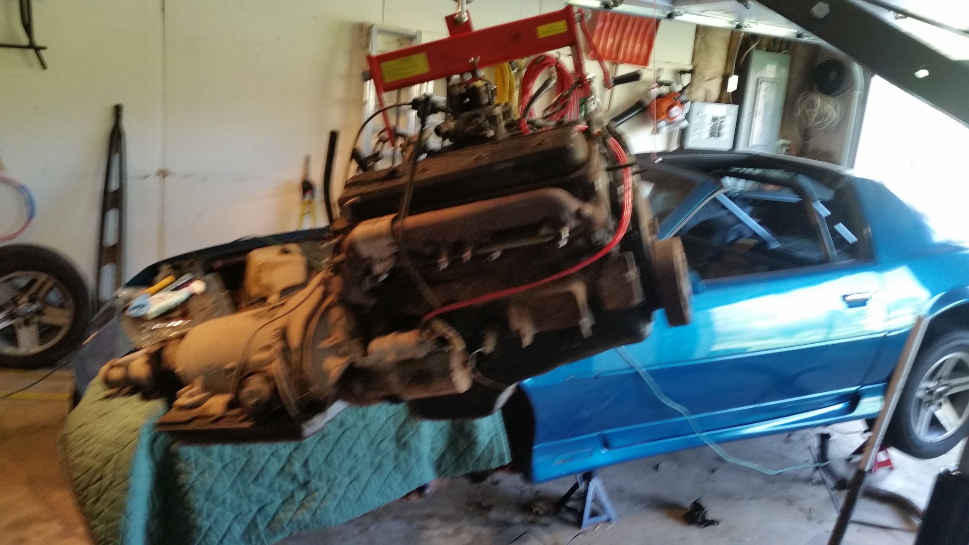

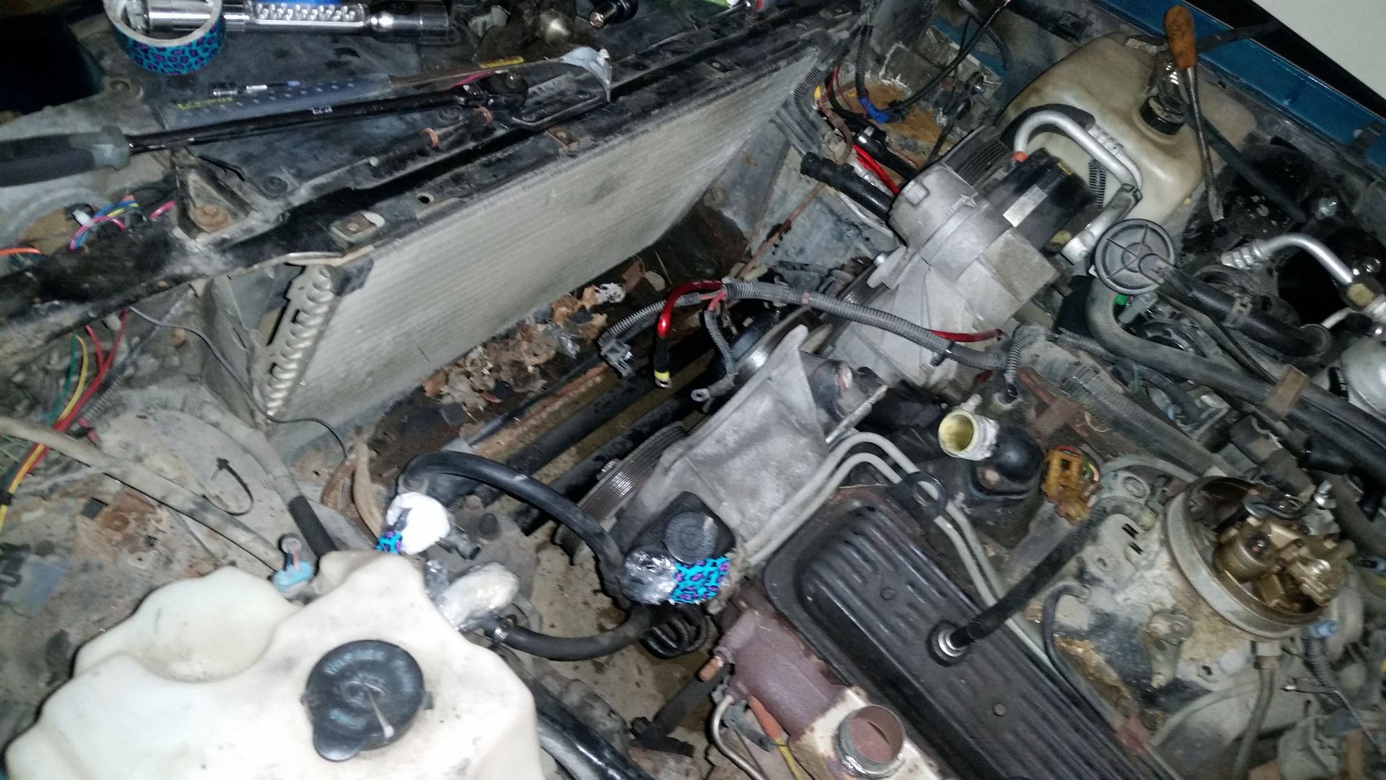

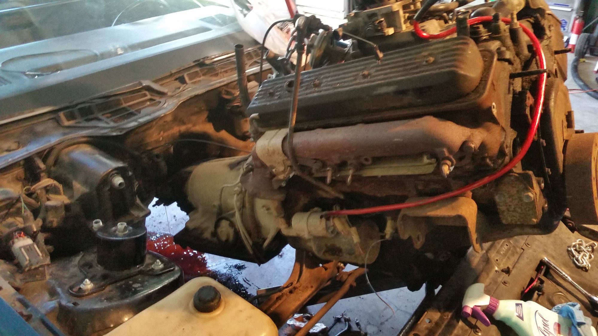

Some more progress on the LS3 swap.
I got the old POS 305 TBI out. It was in pretty rough shape. Luckily I didn't get snagged up on any wires or hoses when I was pulling out the engine and trans. Always check over and over before you pull the motor. Makes a heck of a difference.
Forgot to drain the transmission fluid though. Very messy.
