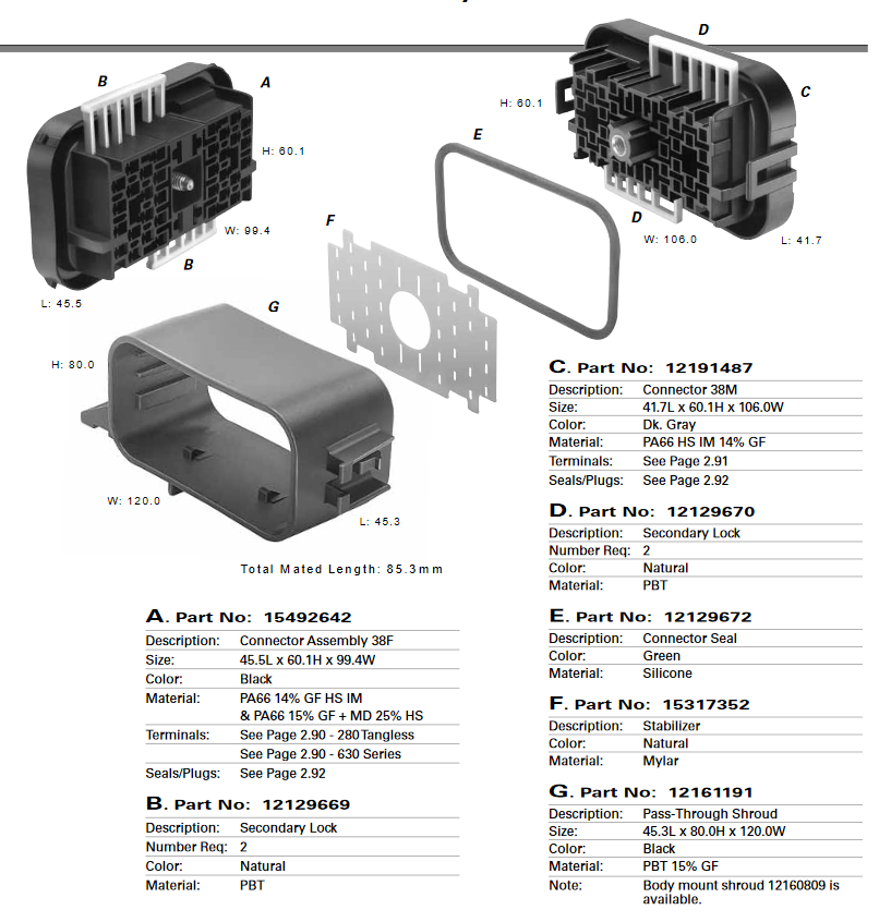

VEHICLE INTEGRATION
Additional information about C207 and C100 connector by vorteciroc
https://www.thirdgen.org/forums/elec...al-poster.html
https://www.thirdgen.org/forums/elec...in-repair.html
Pinouts of C100 and C207 for various years by Pocket
https://www.thirdgen.org/forums/ltx-...formation.html

Sealed Bulk-Head Components (Delphi):
I do NOT use Component "F".
Component "G" is available in 2 different versions.
The version without a Flange is pictured, but with the opposite Part Number.
Part Number 12160809 is pictured, and does not have a Flange.
I use the version with a Flange, Part Number 12161191.
Both the Fire-Wall, and the Passenger Side Pass-Through will require a new piece of sheet-metal as the dimensions of the pre-existing Holes do not fit the new Sealed Bulk-Head Connectors.
