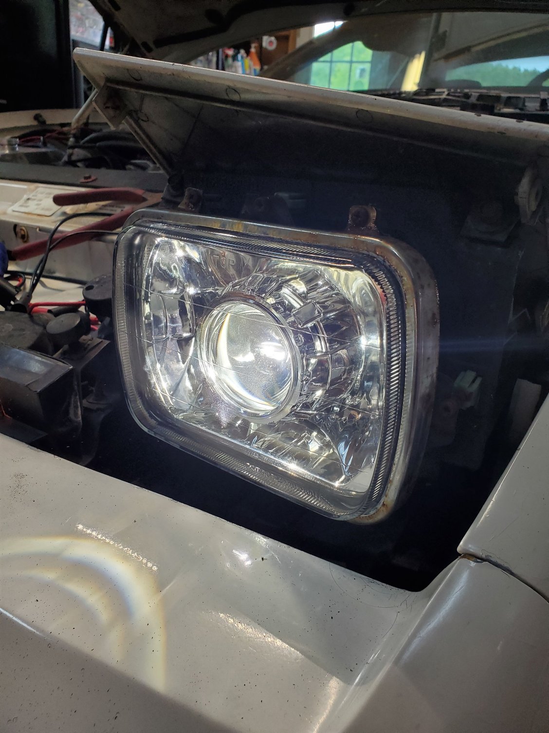

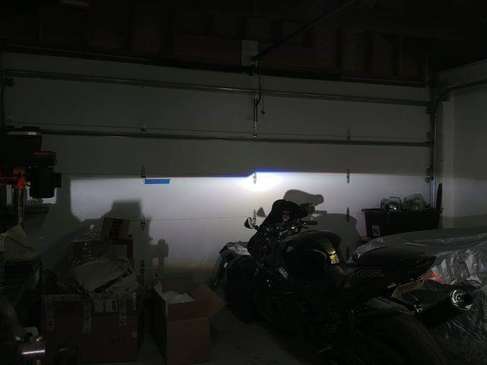

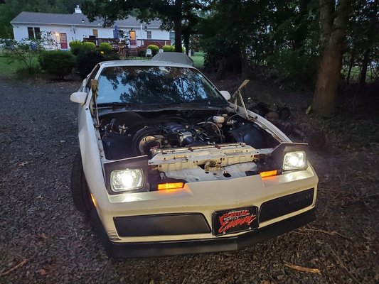

Any info on those lights? I upgraded my Jeep's sealed beams to LED (whole housing, not cheap replacement bulbs) and it is so much better. The GTA has never been as bad as the Jeep was, but could use some help. Being flip up, it does reduce options a bit, so I was curious as to how yours performs.
The lights are great.The whole setup was plug and play. I did order new adjusters so i can get them aimed right. At the moment mine are too low. I also noticed the whole headlight assembly is vibrating as i go down the road. I need to figure that out as well I think something may be loose.

Nice, Does your friend do this as a business, or just side project/hobby. He could probably get himself some good business for thirdgens!
Its a business but he is mostly doing newer vehicles. For some reason the link doesn't work when i copy it over but if you look up "Killerwatts Retrofits" on FB or instagram his work is there. Hes in the process of making another set for a friend with an 88 ta.

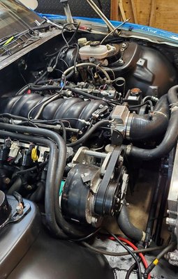

Car has been running well. The motor developed a loud sound that you can really hear above 2K rpm. Still tracing it. Thankfully got the A/C working and quickly learned that the factory single fan is not enough. On a drive to NY cruising at 70 I was right at 200 on a 95 degree day. Sitting in traffic I was getting a hair nervous as I saw the temp creep up past 220. I bought a new 16in SPAL fan. A friend of mine was able to fabricate me a new shroud at his shop. I totally under estimated the requirements of this new fan and thankfully fellow member scooter was local and able to help. According to Spal I will need a 50Amp relay and a 40 amp fuse. Once the new parts arrive I will try again.

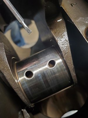

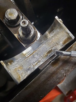

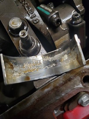

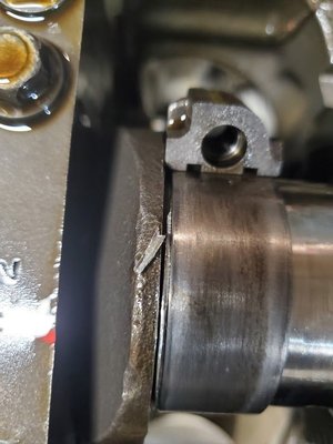

The glory has been short lived. Sometime in the last 4 weeks my motor has developed a bottom end knocking. Right at about 9300 miles. Not very happy cause of course by the time I got the car running the warranty was already up. Blueprint is interested in what is wrong with it though. Taking this opportunity to make some changes and clean things up some more.

Bummer Jon...I found a leaking fuel hose on the passenger side fuel rail on the '49 tonight....glad I changed the oil, could have burned it to the ground!
Plans for the "next phase" of the engine?

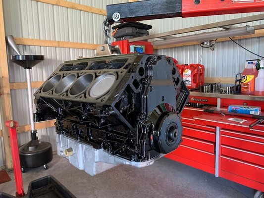

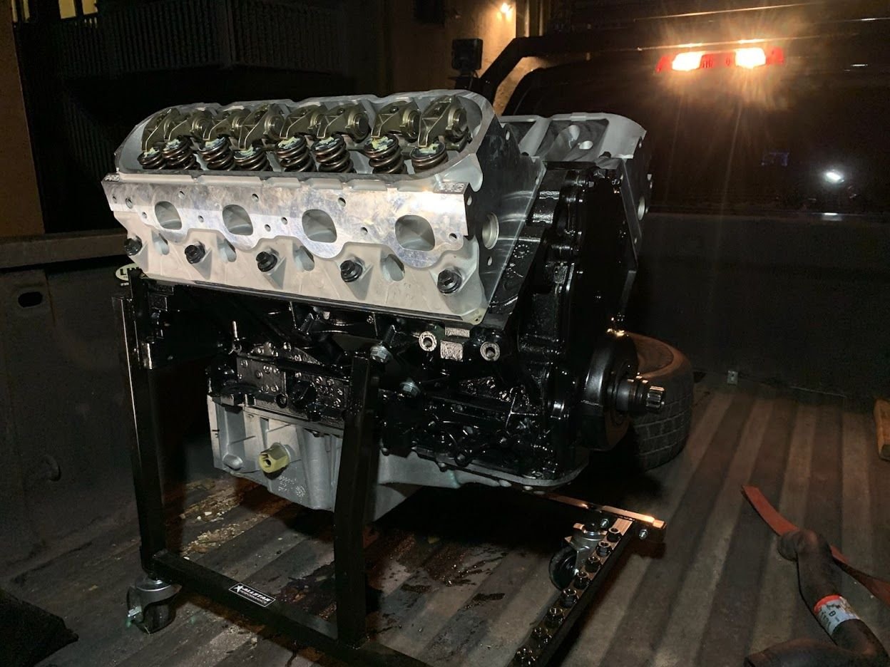

I have another 6.0 sitting on the stand that has been rebuilt with a custom Martin Smallwood cam. The plan is to use this with a set of cnc ls6 heads and a dorman ls2 intake with a fast 92 TB and see how she likes it.

My new engine is ready to go in. Coincidentely I got a phone call from the manufacturer of my original engine that it is being rebuilt and sent back. I will see how this new engine performs. Looking forward to getting her going again.

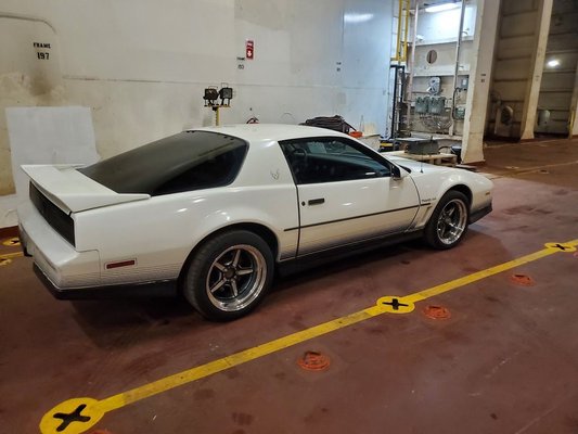

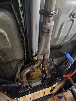

Several months of hibernation and Im finally home to see how this car does. Had a horrible vibration when I went to break in the replacement clutch and decided to order a Founders adjustable torque arm. Took me several hours to get it to fit properly on this fabricated rear but now that the pinion angle is correctly set she is smmmmooooooooth. I think she will be back at the rollers again this week. I had a new windshield installed and whatever cleaning solution they used smeared all over the paint?!?! I cant tell if its the primer underneath but either way I will need to get it addressed. I'll try to get a photo of it.

Pinion angle can be a pain! Cool pic, at least you didn't get caught trying to go through the Suez Canal.
Hopefully the window goo didn't mess things up.

Getting stuck in the suez is the kind of luck I would have. Right before I'm about to go home LOL. Thankfully I havent gone through the canal in 7 years. Been getting spoiled on the northern europe run lol. This last time was 4 months in the Med.

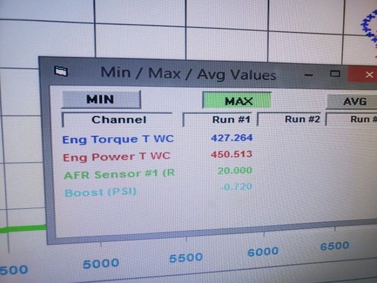

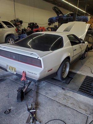

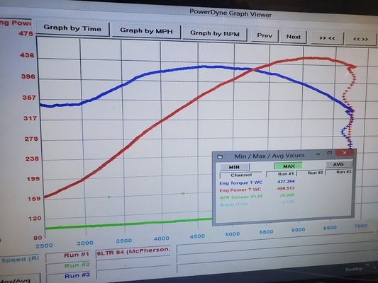

Today was the day. The night before I decided to replace the starter. I was getting sick hot the terrible starts. Almost impossible to start when hot. It was not a timing issue. This MSD Dynoforce is a BEAST. Car fires no problem. When I got to the dyno we did a little shakedown cruise to look things over and we had a misfire that happened to be the AC Delco plugs i was using. I quickly swapped them out for NGK TR55 plugs and it was show time. To my surprise the car Performed flawlessly and performed well. 450whp 427wtq . So happy it worked out.

Those are nice numbers. Congrats!
TR55 spark plugs might be a better choice and give you better cold starts. TR6 are kind of cold blooded and more suited for max effort n/a engines.
I had to go look at the spark plug box again. My mistake! You are correct, tr55 has always been my go to. But it was insisted that I try the delco. Didnt work out that well.

To my surprise the car Performed flawlessly and performed well. 450whp 427wtq.
You gonna come race that thing at Atco Dragway, or is she just a looker...?

Great numbers Jon, and that torque curve!

Great numbers! Should make a perfect street car for ya Jon !

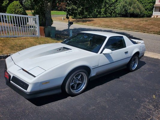

Finally after waiting I was able to get the decals installed on the car today. I also had the bumper strip installed. Pretty happy with how it came out. Now I can get some coating on this bare paint cause literally everything wants to stick to it.

i think the car looks way better with the decals

I agree with battmann, looks much better with the decals. Normally I'm not big on decals but that car looks great with them.

I agree 100%, My friends do not appreciate that the hood says "5.0 Liter HO"
