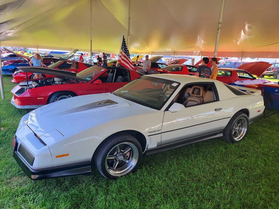

Its was a great season for the 84 and we for sure kept busy. We were on display at the GM Nationals in the Thirdgen Fbody Display. I also attended a Tours on Tarmac car cruise. It was a very exciting and both exhausting experience of spirited driving. I thankfully was able to maintain pace with a 911 and viper while we were ripping up and down mountain roads averaging 70 mph + . Big brakes was a must.

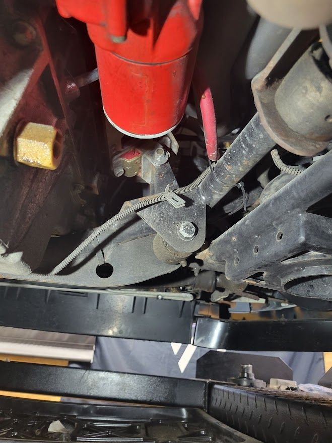

Removed the high mount ac since the system had discharged. I installed the ICT billet low mount and its danger close to the steering linkage. Im trying to see what would be the best course of action with out compromising my steering. Shave the arm?

I ended up shimming the motor mount on the passenger side to level the motor and raise the compressor up off the linkage.
I think I used some 3/8's washers between the mount and the block. I recall it being fairly easy to do, other than getting my hands down there of course.

I just may do that. Ill probs replace the motor mounts while im in there

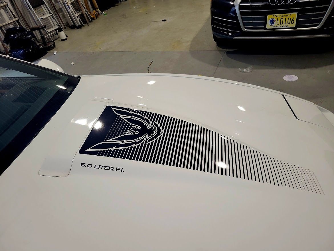

After another round of paint prison my Trans AM is back on the road. The engine bay is in serious need of overhaul. There is baked in paint dust everywhere. I will get to that. Need to do some minor adjustment of the hood, bumper and headlight doors to try and get it back to what it used to be. I had the "factory" decal replaced on the hood along with the previously damaged bumper and fender. Feels good to be behind the wheel again.

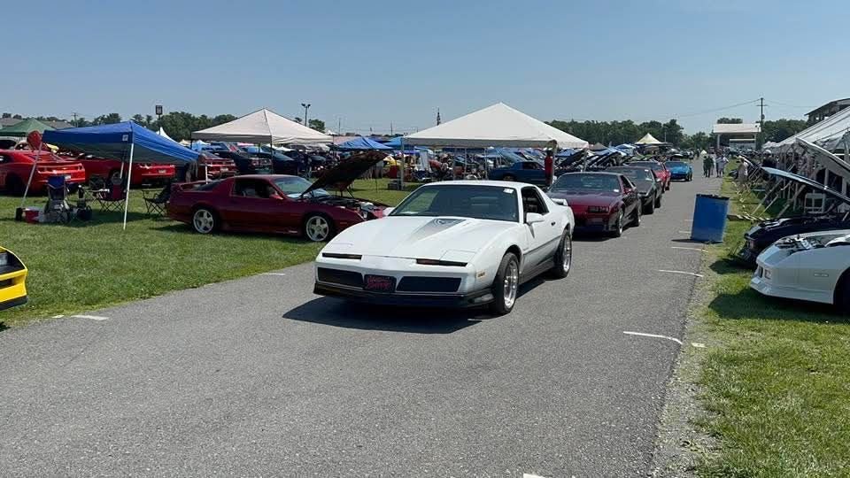

I once again had the opportunity to attend the thirdgen fbody nationals at carlisle. Quite the experience. Very grateful for the votes, the help, and motivation friends, family, and members helped contribute to the overall goal. Got the chance to take my car on the autocross and was very careful to not do any damage. The vehicle before me went into the wall of water barriers. Hopefully with some maintenance we will be driving out to the T/A Nationals.

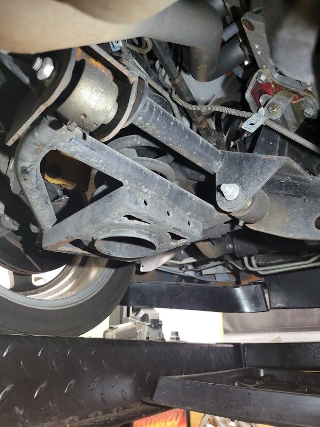

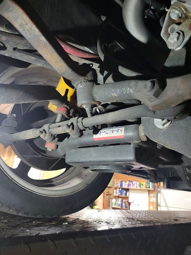

how do you like the heidts k-member? what a-arms etc are you using with it (ie standard coil type spring arrangement?), any additional pics?
it looks like a stout piece

This heidts kmember has been great. 40,000+ miles of driving and I have no issues with it. I've been using an older Spohn A arm. I had a lot of issues with a newer style, I had a hell of a time installing the springs on the arm with the round spring pocket. I have the car sitting on the lift so I can take pictures of whatever you need.

that sounds great... i am always curious about other options... i have been using the UMI road race k-member on most of my builds and has worked well, just always curious on how other items work... if you don't mind and could post some pics when you get a chance that would be great
i have been thinking about using the new qa1 spring slider system but their k-member seems a little weak compared to UMI and also in pics the hiedts ... so thinking about matching their system if a different k-member

I have not been under my car in a while and your request for photos has allowed me to see some of the issues I need to take care of. Will be taking care of it all when my vacation starts next week. Doesnt seem to be much life left in my motor mounts.

thanks for posting the pics!
