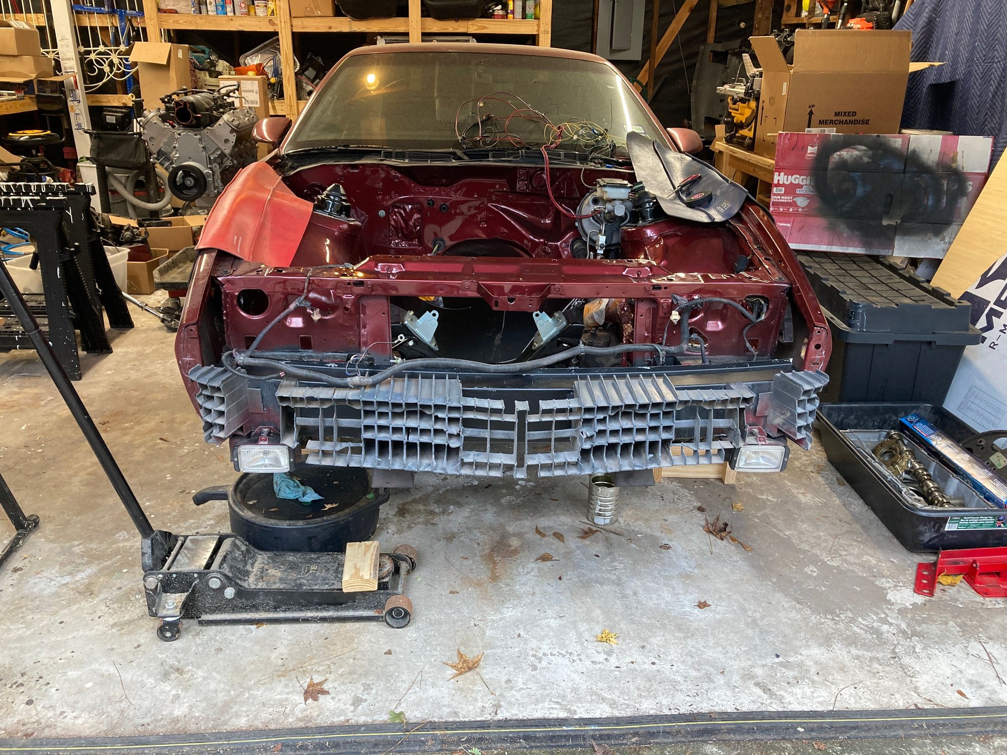

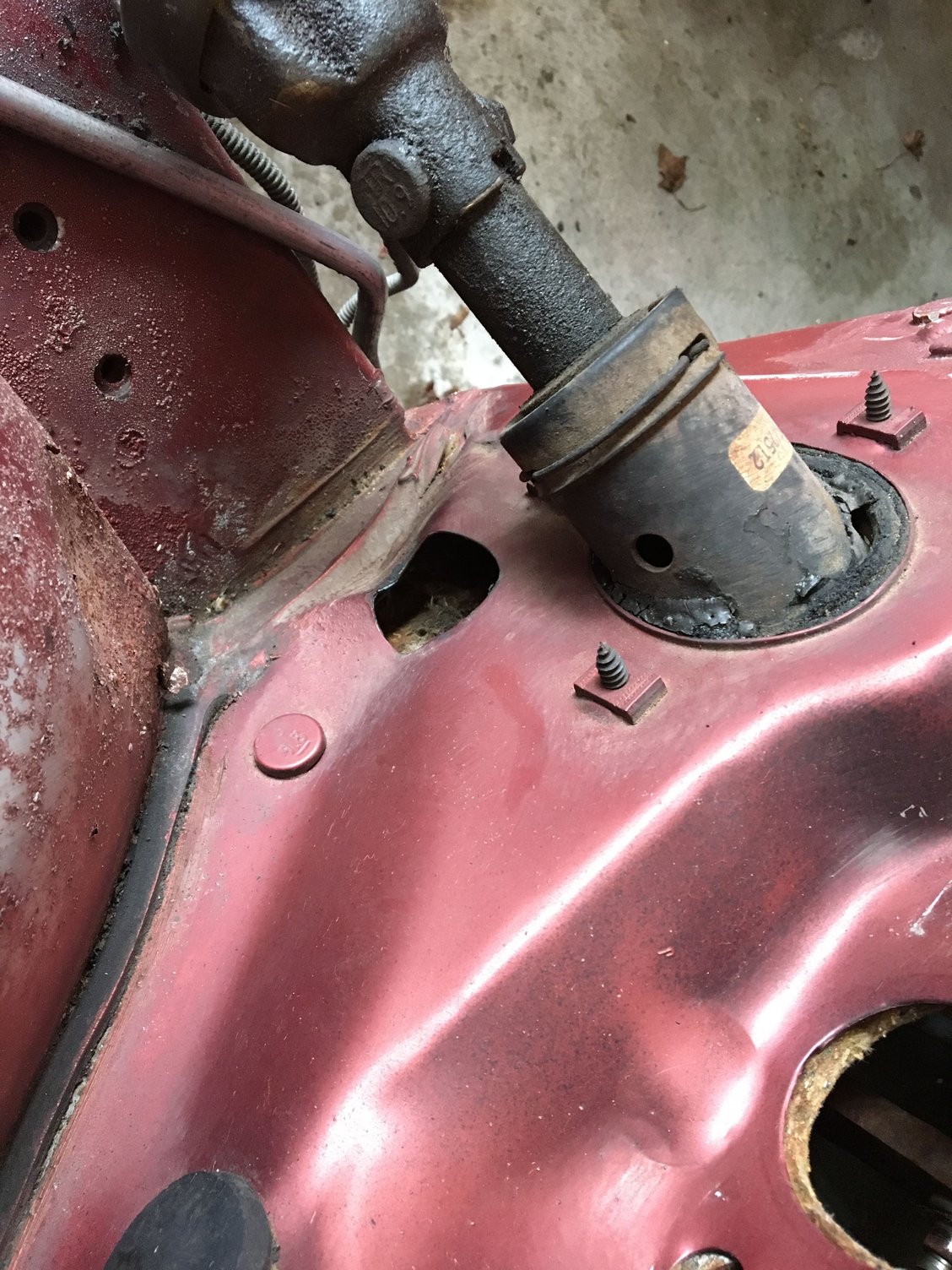

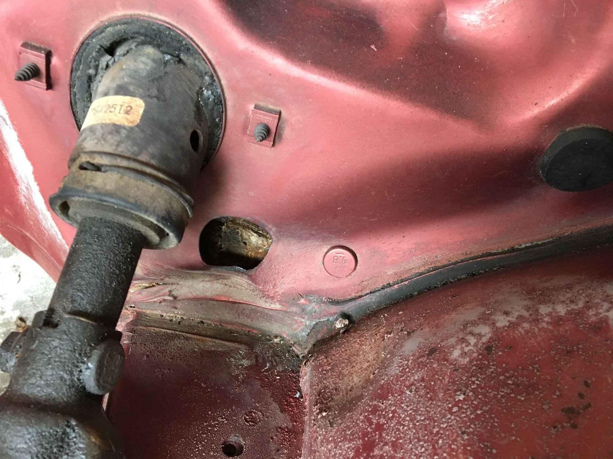

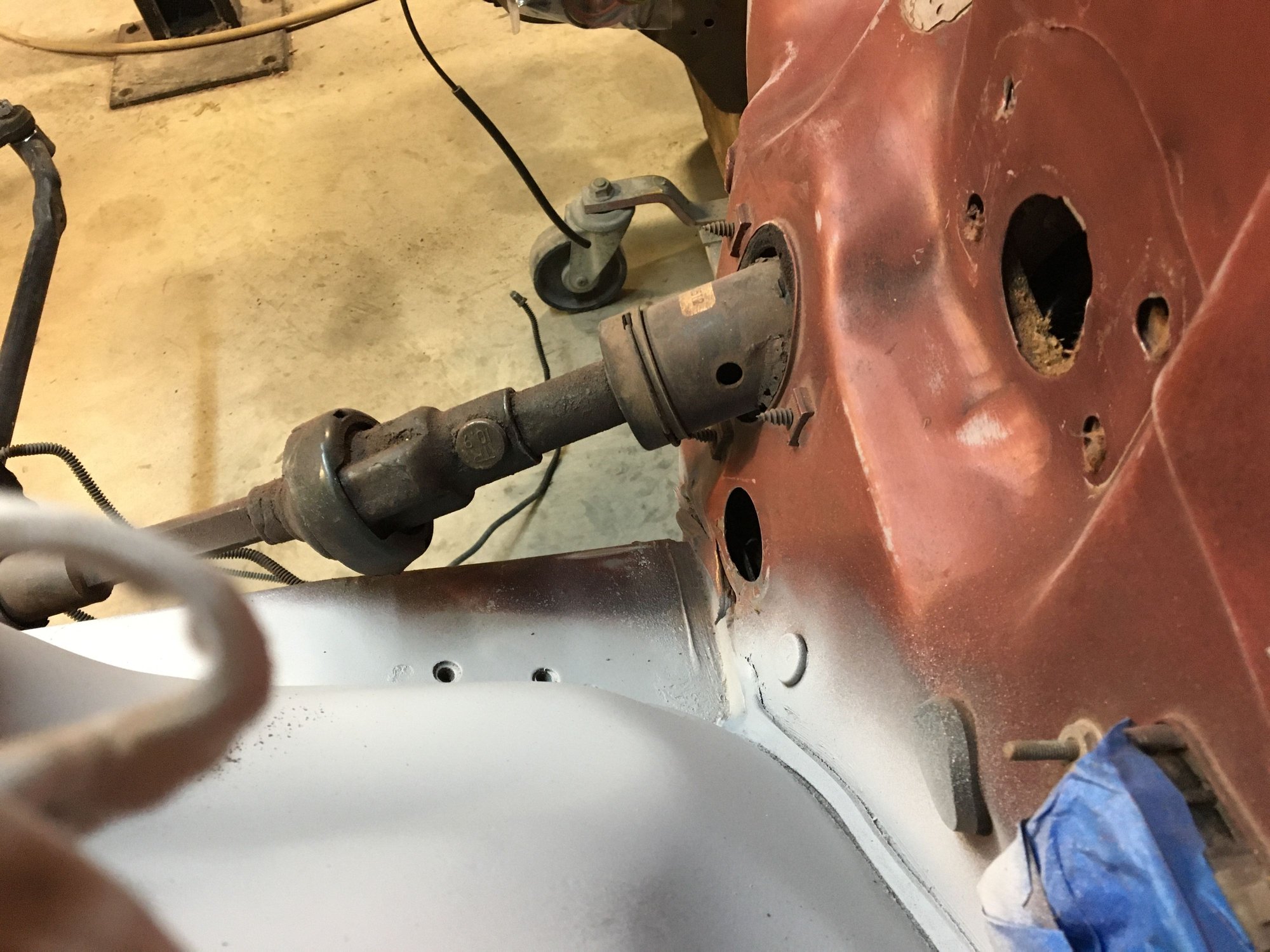

Need some folks to go and look at their firewalls and report back, please.
My car was totalled in 2003 and "fixed" for what I could afford at the time. In gutting the engine bay down to nothing this time around, I've found that the hole where the cruise control wires ran through is now quite wavy. It doesn't look like it's supposed to be that way and I'm tempted to bang it out from the inside of the car. I'll either have the hole welded up afterward, or run a grommet for the 4th gen cruise wires, haven't decided yet.
Here are the pics of mine. Go check yours and report back - is the hole on a flat plane, or is there curvature to it and the grommet makes up for it? Thanks!

It's definitely supposed to be flat in that area

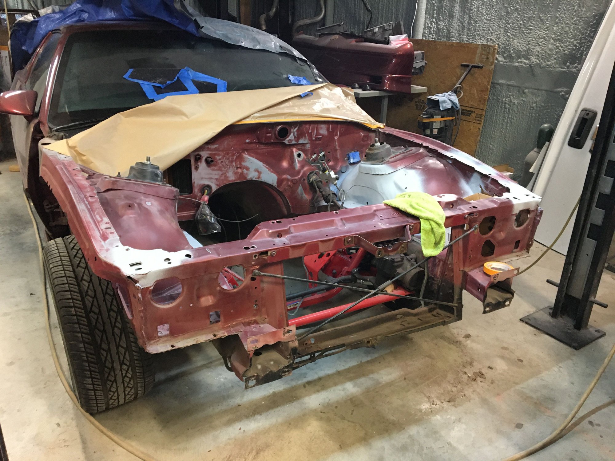

Dropped the car off at a trusted family body shop today. Initial inspection of the engine bay wasn't promising. Some of the damage in the front clip from 2003 was pulled out with heat, weakening the metal. There's also likely quite a bit of body filler in areas that are designed to crumple in collisions. Not sure if we're going to be able to keep the car or not... Owner went ahead and let us drop it off, on the condition that the estimate was from what he could see at this point. He offered for me to come by and put in some labor to help lower the cost and speed it along (he's pretty much a one man shop at this point and we've been using him for ~30 years). First thing we'll be doing is removing the fenders and nose cone to see the extent of the damage underneath the filler. He recommended looking into what aftermarket parts are available to help strengthen the frame on these cars from mid-body forward. I'm not aware of any, but haven't looked much either.
Not sure what to think at this point. I don't want to cover things up and just drive this thing on backroads and feeders at low speed, hoping to never have a collision. I've got a family to think about. At the same time, I'm really looking forward to getting this thing going again. I guess this is a decision that can wait until we can see more. Fun times.
Maybe I can find another bird local for cheap with an undamaged front frame? Someone else made it happen...

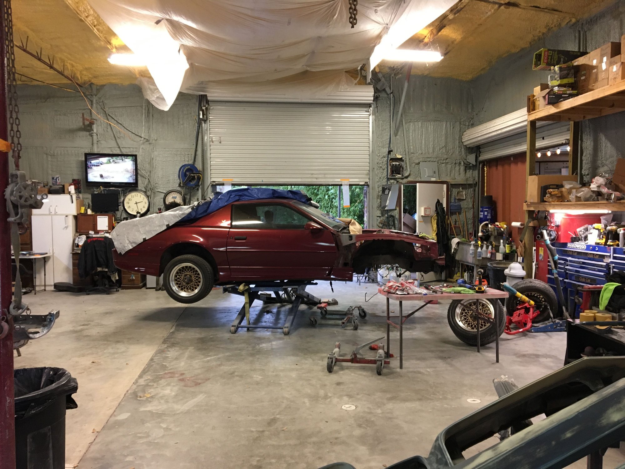

A few weeks back I went by the shop and took the nose cone, fenders, and bumper off. We got to look everything over pretty well. Conclusion? Previous shop used some rusty parts and had a few spots of not-great work, but nothing to throw a car away over. I think it's safe enough to drive. I finished the day by started to scuff the paint and removing what I could from the engine bay. Next time would be removing the K-member.
Inspection time
Got a call today. "What's the paint code? It's usually in the center console." Luckily I saved that in a folder here inside the house, as car parts are everywhere in the garage right now. Asked if he wanted any help today and he said sure. Made it down and got to see this wonderful sight! He'd already nearly finished prepping the engine bay, pulled the dent in the firewall, and smoothed out a few of the rougher spots.
Next up - removing the tubular K-Member and A-Arms (and the rest of the front suspension). Having a mobile lift really helps!
Got it down and on a roller, disassembled the front suspension, and pushed the car back under another project. There's some more prep to do, but not too much. I'm really liking how this is turning out. Next up - need to source an original Trans Am hood (no longer care as much for the ASCD Ram Air 1), a front end bolt kit, and make sure my OEM K-Member is all set and ready to go back under the car. Here's a few more pics of where she sits now.

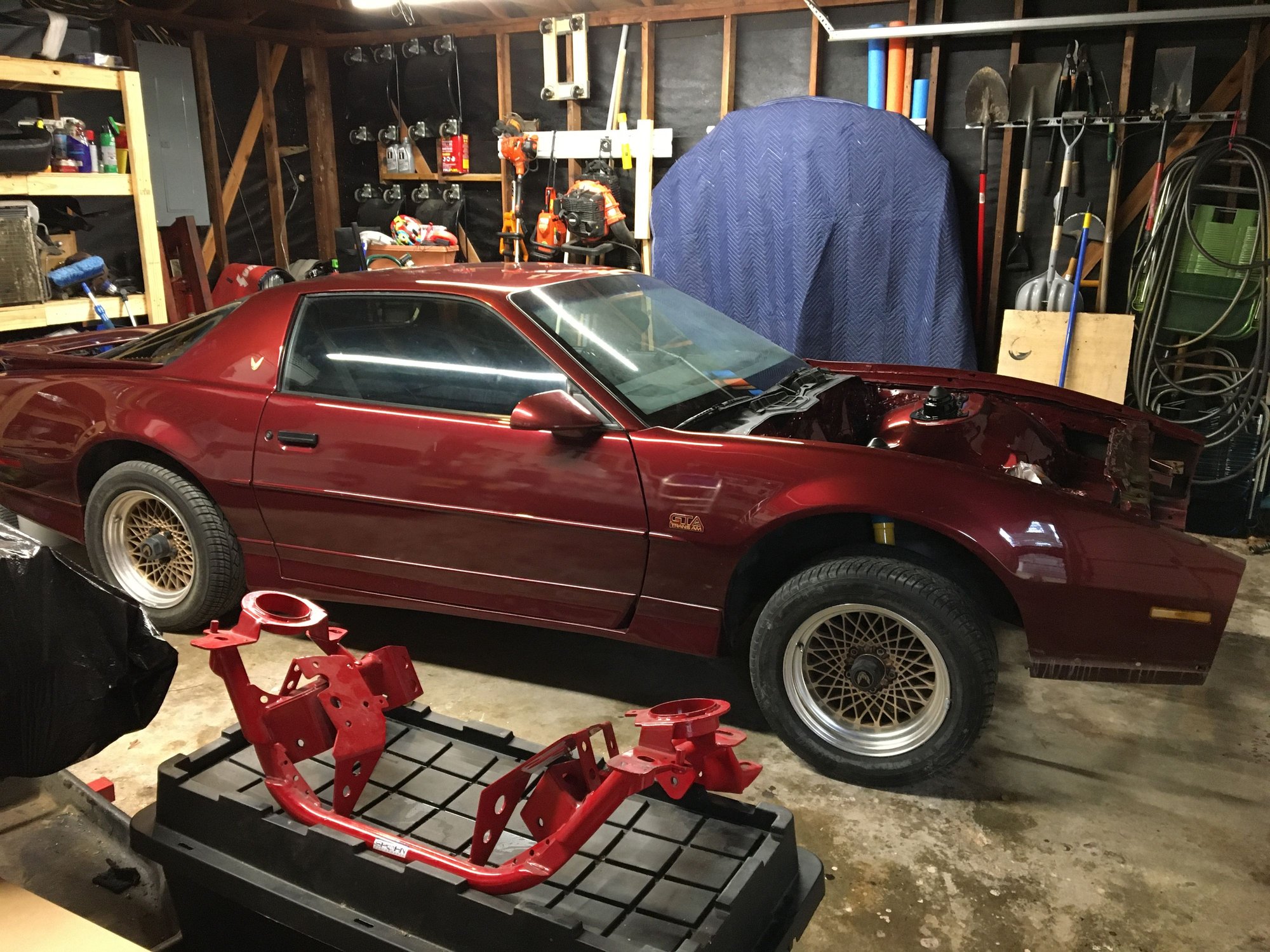

Got the car back in the garage. Engine bay looks mint.
Questions for the forum:
  1. I'd like to avoid notching the factory K member (it's back in the car - tubular unit in picture is for sale in thirdgen classifieds local) by using a high mount A/C along with the 4th-gen alternator and P/S pump. Thinking of using the one from Holley (Holley 20-141 LS A/C Accessory Drive Kit - Includes SD508 A/C Compressor, Tensioner, & Pulleys). Anybody else run this with success? Anything I should watch out for? Others I should consider?
  2. Is the ATI Super Damper worth it on a stockish engine? This will have a TSP 224R cam (112 LSA) and headers. Not planning to go to the track much, maybe once a year. Will see street duty more than anything else. I've got a replacement factory damper in a box from GM, but have wondered if it's worth stepping up to the ATI unit at this point.
I've had enough of trying to get the remains of the graphite head gasket off of the block. No amount of scraping with a plastic razor blade and using the expensive gasket remover stuff has worked. Some light work with a scotch bright pad "works" but starts to leave tiny scratches, so I quit that as soon as I saw it. Going to be trying to find a reputable machine shop that works on LS engines to get this thing taken care of. If you know of any in the Houston/Conroe TX area let me know.

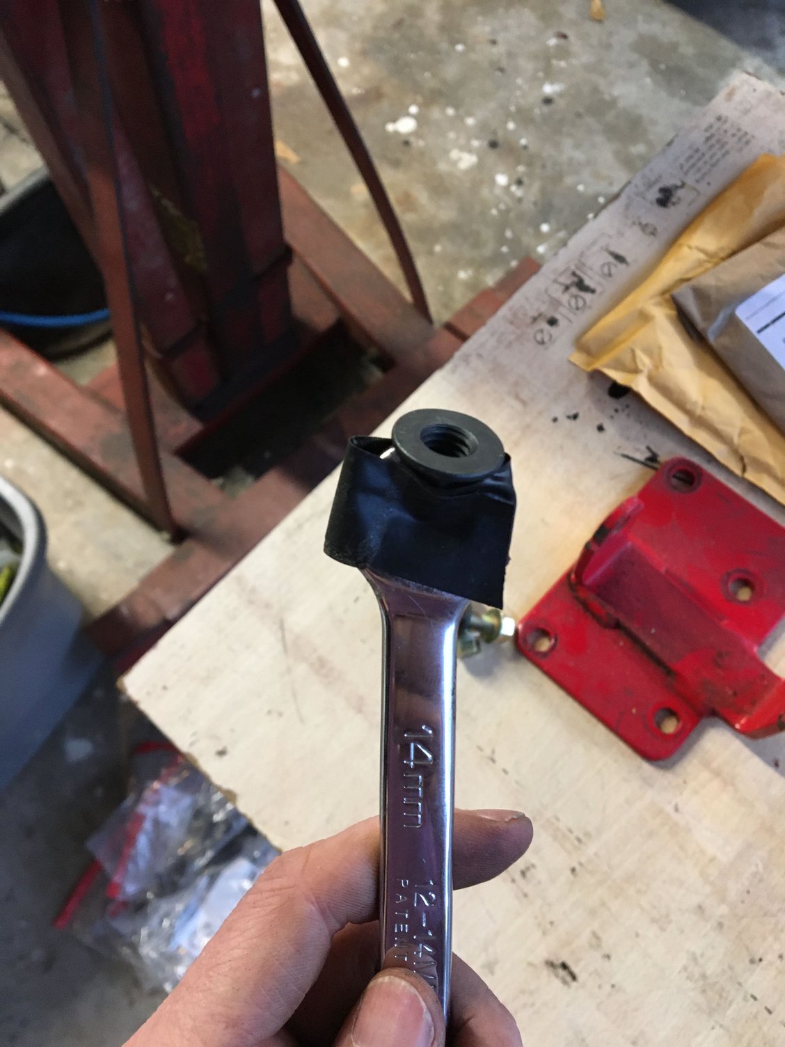

Well, time for another of those questionable decisions...
While trying to attach the K-Member triangle braces to the car, I found that I didn't have the bolts. Found a forum thread with the thread sizes, bought a set, and then tried them out. The triangle-brace to body bolts would bottom out quickly, but the thread seemed to be right. Looking up in the hole, it looked like some rust or corrosion, so I bought a thread chaser from ARP (I've got some for the LS1, so why not right?). Finally got around to using it last weekend and it was helping, but still bottoming out.
Took the T-handle off, put the socket wrench on, and quickly sheared it despite the slow back and forth. I knew better. Lesson learned, never take the T-handle off of a tap (or thread chaser).
Struggled for a bit trying to get it out, tried calling a mobile welding service to attempt the welded nut method, but gave up for the day without a good solution. Ordered a set of tap extractors, then had an idea and went back outside.
Worked it out with a punch, some penetrating fluid, and a hammer. Whew! Quickly canceled the order for the tap extractors.
While it was stuck, I looked down the frame rail and could see it had started to widen the hole. I didn't see much corrosion from that angle, just plenty of metal clearly not wide enough to let a bolt through. At this point, I thought "how did this attach before? I know I had these at some point..." So I made questionable decision #2 and got out the 10.9 grade bolt and the impact wrench. I had only been using a socket wrench by hand before. Made sure it was started clean, then let the impact work it. Wouldn't you know, it worked fine. Powered through the end of the hole (which was clearly too narrow). Backed it out and the threads looked fine.
The bolts I bought are too long (40 mm), so I'm going to get shorter ones (20 mm). But for those that end up in the same boat without bolts, but do have the threaded holes, you'll need:
4 M10x1.5 (K-member to triangle brace)
2 M12x1.75 (triangle brace to body)

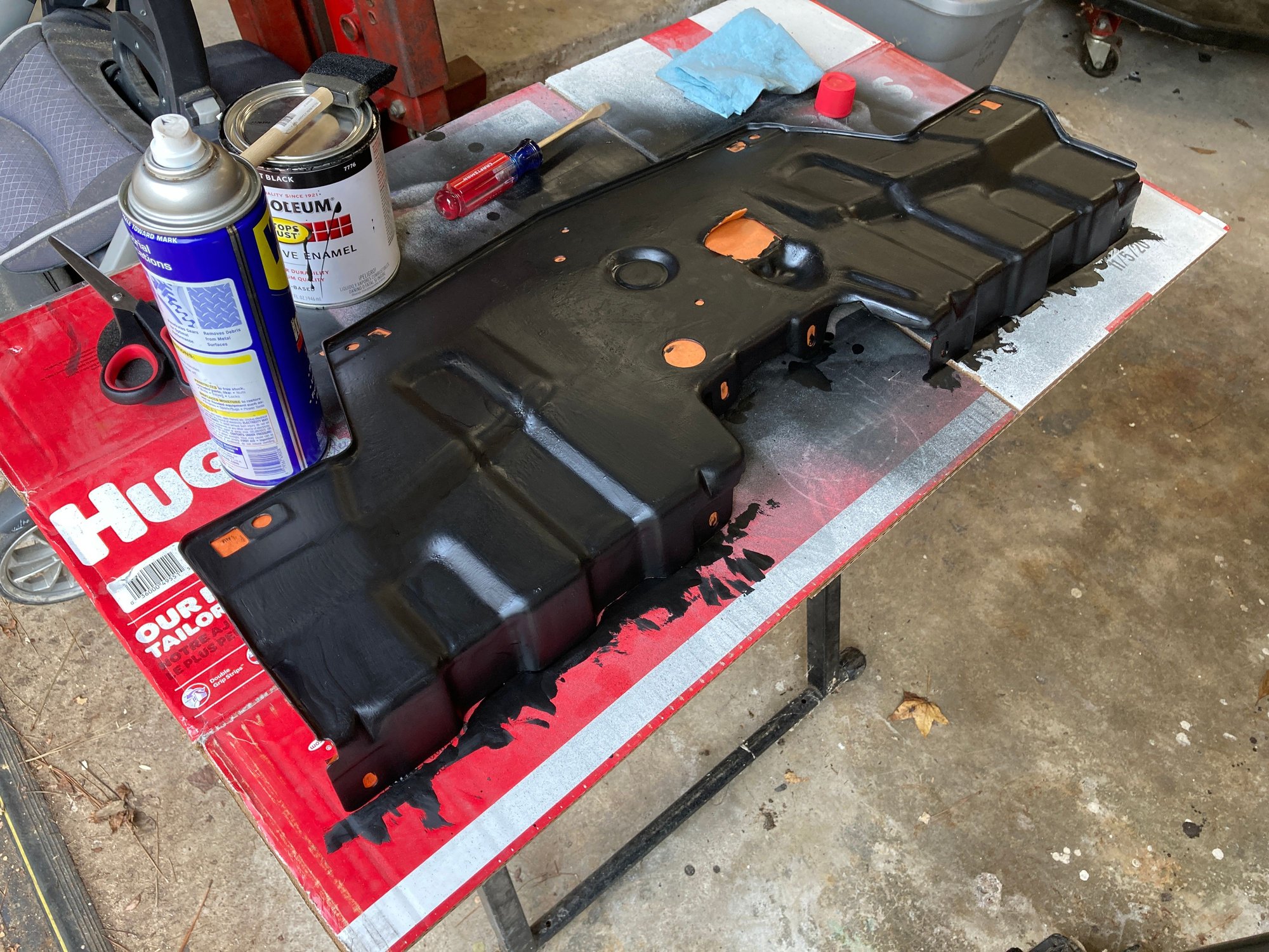

After the crash bar, I worked over the bottom of the bumper fill panel to remove the surface rust, then painted it with black enamel. y son and I worked and got the headlights installed, bumper mounted up and the new hood latch and cable installed.
After removing rust and slag, painted with black enamel.
Headlights and bumpter mounted up

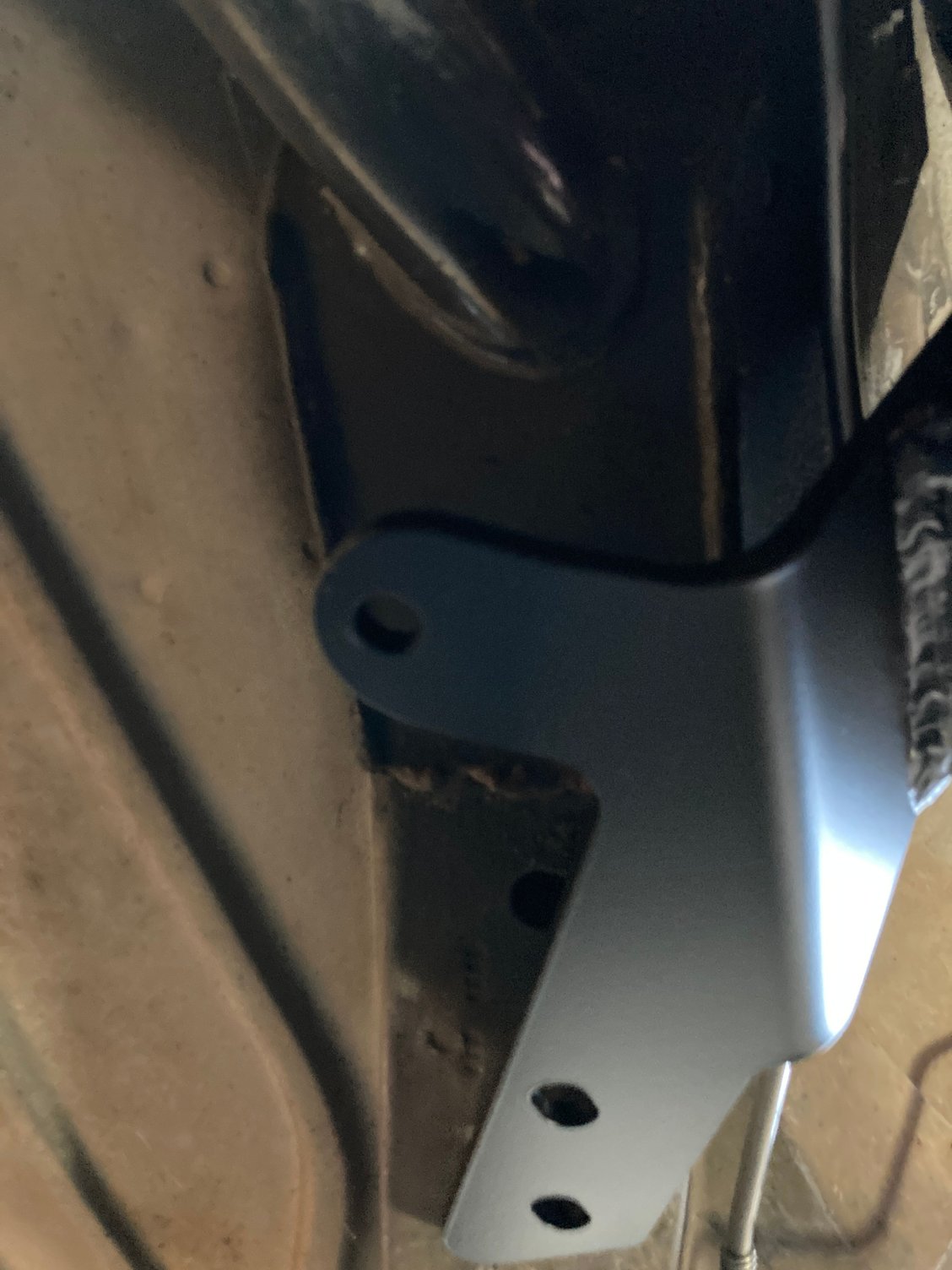

Finished off that particular weekend by crawling under the car and holding up the Hooker transmission crossmember. Turns out - this does NOT fit with the Alston subframe connectors.

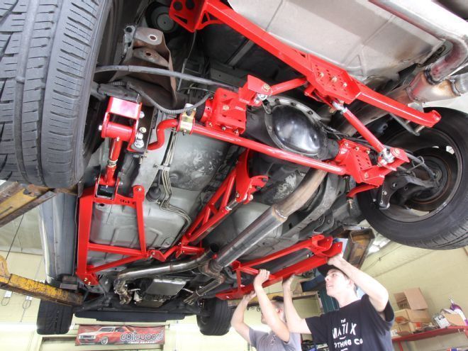

Passenger side interference between Hooker transmission crossmember and Alston subframe connector.
Drivers side interference between Hooker transmission crossmember and Alston subframe connector.
I checked this a long time ago when I first got the box of Hooker parts, so knew this was coming. I just didn't take pictures at the time, and wasn't ready to deal with it yet.
Fast forward a couple weekends... time to cut the Alston subframe connectors off. I started out thinking I'd be able to cut just the welds and save the connectors for somebody else. That plan didn't last long. Ended up under the car around 10 hours (across 3 days) working with an angle grinder with diamond-coated cutting wheel, another angle grinder with a standard grinding wheel, and a dremel with a bunch of little cutting discs. This wasn't fun, wasn't something I felt qualified doing when I started, and wasn't something I'd be able to find anybody else to do for me... time to learn, take all the safety precautions, and hope for the best!
I'm relatively unharmed, and the connectors are off. The car needs a little welding here and there to fill a couple spots where the cutting wheel, or the dremel, dug too deep. But overall very pleased with the result. Don't ever want to do it again.
The Dremel was the star of the show, as it allowed very precision cuts in cramped spaces when just trying to separate the car from the connector. Had to let it rest A LOT though in front of a fan, and went through ~8 discs. Most of the work got done using the diamond-coated cutting wheel on one angle grinder, and the last angle grinder with the standard grinding wheel I used to smooth things out after the bulk was cut off with the other tools.
I've been looking at subframe connectors and will probably go with the UMIs. I'll wait until the car is moving under its own power again though so the suspension is fully loaded.

Those In-Board Sub-Frame Connectors are the most important, center Tie-In Point for each side of the Car...
From there, further Chassis Tubing Reinforcement will "Spider-Web" outward towards the Body Pinch-Point Sub-Frame Connectors.
Also Roll-Cages will also go through the Floor and directly Connect/ Tie-In to the Tubular Structures created under the Car.
I will not Post Images of the Design that I created for ThirdGens (Sorry)...
But this Image of a FourthGen shows a very simplified version of what I create:
The Alston Style Sub-Frame Connectors play a very important role.
So much, that they are the starting-point of where my Chassis and Roll-Cage designs are built upon.
Can't be said enough.
One thing I did is put a welded bar that ties the LH and RH side Alston's together at the trans tunnel. That is a fantastic little mod for our cars.
I generally recommend something similar to this...
and in addition, the Torque-Arm can be moved off of the Transmission and to this Bar.

It is true that the Alston's don't play well with bolt-on parts. I had to make custom trans crossmember and a custom torque arm. You know I didn't start out with those and it was an evolution of learning to get there. Seeing the paint crack on the roof was my deciding moment.
I still need to do something about the floppy front end. The car bends like crazy at the firewall.

I should mentioned...
Many years ago, I used the actual "Alston's" Sub-Frame Connectors.
Fitment was okay, but as QwkTrip just said... there can be interference issues.
I do not know if the fitment or Design of the Alston's Sub-Frame Connectors has changed or improved, after all these years.
But it was very easy for me to just produce my own Version of Sub-Frame Connectors.
Also it is nice to be able to alter the Sub-Frame Connectors to my needs depending on what else has been done to the Car.
I almost never just install a set of Inboard Sub-Frame Connectors...
Most of the time, I have a lot more going on, under these Cars.
Especially with the Torque-Arm being relocated, Outboard Sub-Frame Connectors, and Roll-Cage Tie-Ins.
But I would purchase a new set of actual Alston's Sub-Frame Connectors (just to see if anything has changed)...
If I have a Car that only needs Inboard Sub-Frame Connectors.
