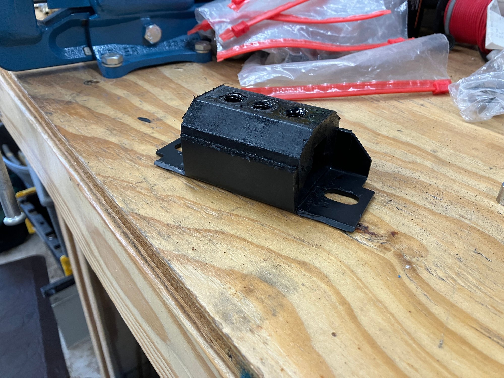

Only in regard to Engine Mounts for our Cars...
I do not like Poly/ Poly-Graph. Engine Mounts.
I see them as a "Half-Measure"...
Only "Full-Measures" here.
OEM Type Engine Mounts or Solid Mounts.

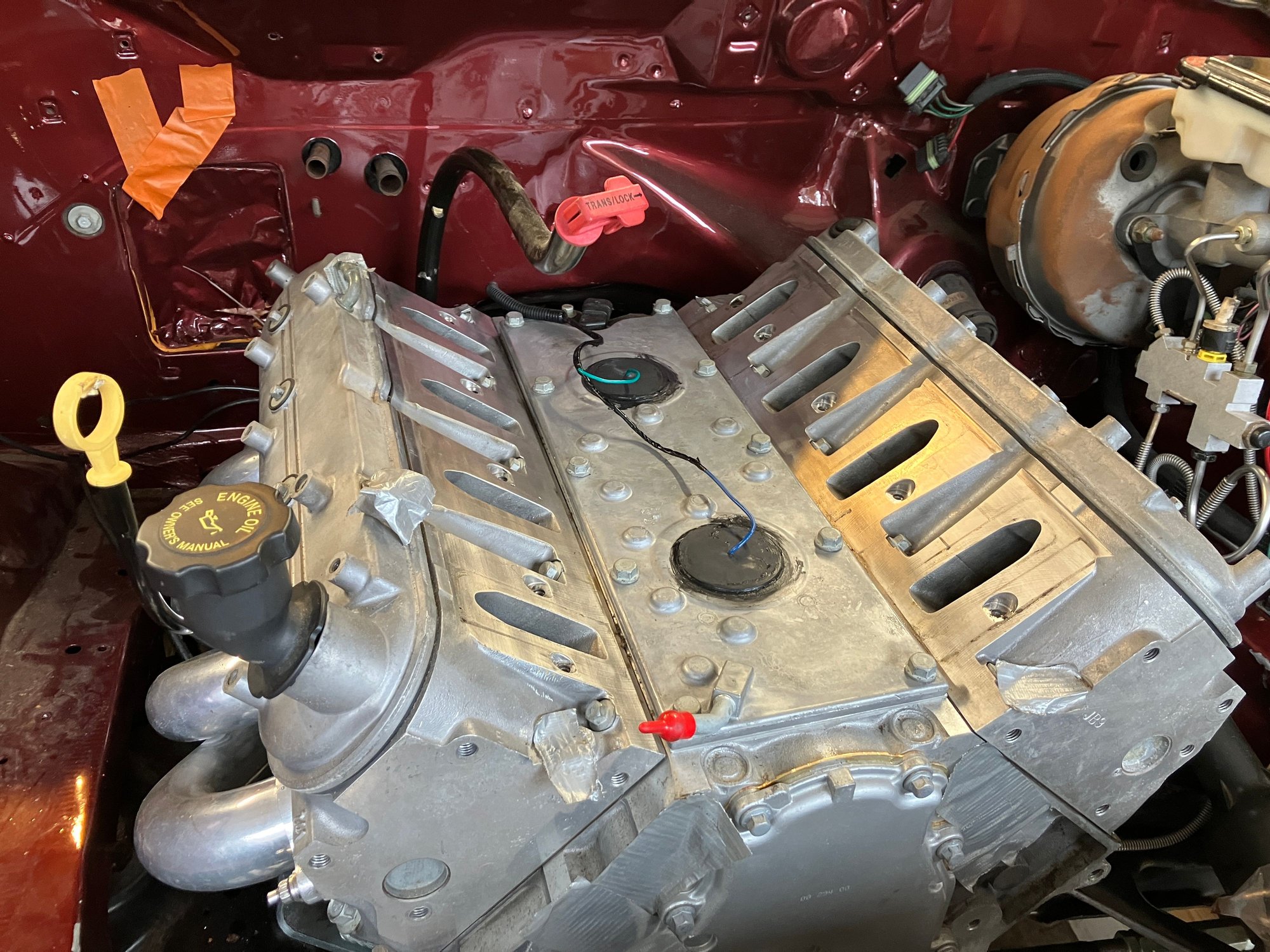

Haven't posted updates in a while despite some progress being made. Time to get caught up.
In October of last year I bought and installed a new shifter cable from ShiftWorks. Install was very easy and it seems like a well made part.
Next up, I started reviewing the fan setup for my champion radiator. I had bought this unit many years back and opted for the optional fan shroud and fans to go with it, thinking it would be a quick bolt-in affair and reasonable upgrade. A decade ago when I bought this setup, I just attached everything using the provided zip-tie things that suck the fans up to the radiator and sandwich the shroud in the middle. I had also changed out the wire ends with some trailer wire fittings to make connect and disconnect easier (these were parts I bought from an auto parts store I believe). Here's where we started when I pulled it off the shelf to be reviewed:
I decided that the trailer wire connections and zip tie attachment method were probably not good longterm solutions, so I went about replacing the trailer wire connections with Metripack connectors and drilling holes to use short button-head bolts with washers and nuts to attach the shroud.
I finished out the month, by doing some reading on people's thoughts on the fans themselves because they seemed quite inexpensive when I looked them up on Champion's website compared to other fans from places like Summit. Found a few folks say that they were not effective at cooling their motors and seemed like a downgrade from factory fans they had before, so I placed an order for a set of Spal fans that were supposed to be the same dimension but higher CFM
These came in and I quickly discovered that Spal's 12" fans were bigger than the ones I had... in thickness and diameter. Oh boy. Time to get cutting! What the below picture does not show are a few bits of learning:
- Marking the inside diameter of a fan with blades attached is a little tricky. Easiest way I found was to use a stubby pencil that I could work up inside the fan from the under side to mark.
- "Tin snips" will kindof work, but take ages and leave jagged edges that are near impossible to completely sand smooth. At this point and until 2023, I wasn't sure how I was going to have the patience and ability to do a better job. Next post will show the work in 2023.

Got some more done over the weekend to share, and a question
Installed a Factory Style Rubber Transmission Mount
While this is not normally a big deal to anyone, it was a bit of a challenge to find a mount that would work with the Hooker transmission crossmember. They indicate in the instructions to use an aftermarket polyurethane mount or stock/aftermarket rubber mount. I bought a factory 4thgen 4L60E mount and a factory thirdgen 700r4 mount and both had clearance issues with the transmission crossmember. Found a generic aftermarket mount for a 4L60E for cheap on Amazon that looked really close. On trial fitment, had to cut two tabs off to make sure the mount would clear some bolts on the transmission case. But this works and fits nicely.
Modified generic 700R4 transmission mount

Knock Sensors Rust Prevention
I had previously set the LS6 intake on the motor and set the fuel injectors in it just to block the ports off leading into the motor. In the time since, I've thought about how people have reported in the past that the front knock sensor often rusts out due to water seeping between the intake and the valley cover, then down into the front hole where the knock sensor resides. My front knock sensor (removed) was quite rusty as well. So I remove the intake, pulled the new knock sensor harness loose a bit, then put a ring of black silicone RTV between the plastic/rubber of the knock sensor harness and the valley cover. Then pressed them back in. This was recommended a few times on ls1tech as a way to prevent the rusting. I think it turned out well and should prevent the issue in the future.
