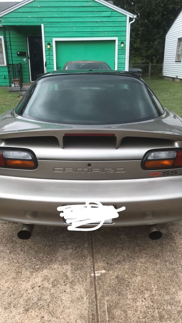

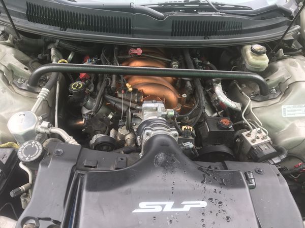

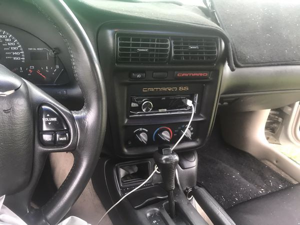

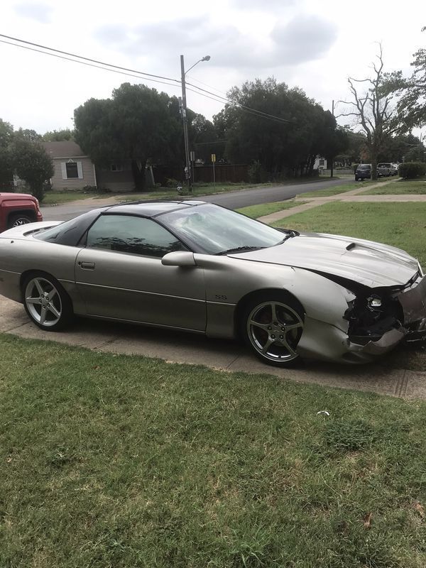

I got the car for 1,500 it is an auto car which sucks but it'll work. The car was hit in the front only, not much damage ,other than that its a pretty solid car.
Here is some more pictures.
